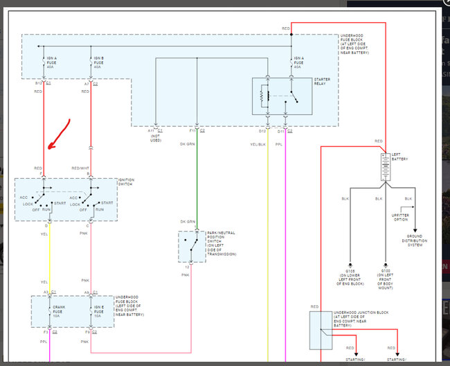

Okay, I checked to see if the reverse lights were coming on and they are now. This range sensor is the neutral safety switch, the first thing I attempted to replace but from the diagrams u sent, I don't think I did it correctly. It's kind of hard to read that diagram and understand exactly what I did or didn't do. Also, you said the dark green wire should be hot when in park. Are you talking about at the end port?

Okay, this means the neutral safety switch is bad or it is not installed correctly. I would check the electrical connector at the switch as well. Yes, the dark green wire should have power when the key is in the crank position. use a test light and probe the wire.

Okay, so, right off I found that the 10A crank fuse is not getting any reading with the key on. I took the fuse out and it's hot on one side, but I put a new fuse in, and that same side isn't hot neither is.
Monday, July 29th, 2024 AT 11:29 AM
KEN L
  • MASTER CERTIFIED MECHANIC
  • 55,322 POSTS
Good find, it looks like the ignition switch is bad which is what powers the crank fuse. But can you also check the IGN A fuse as well the way you checked the crank fuse?

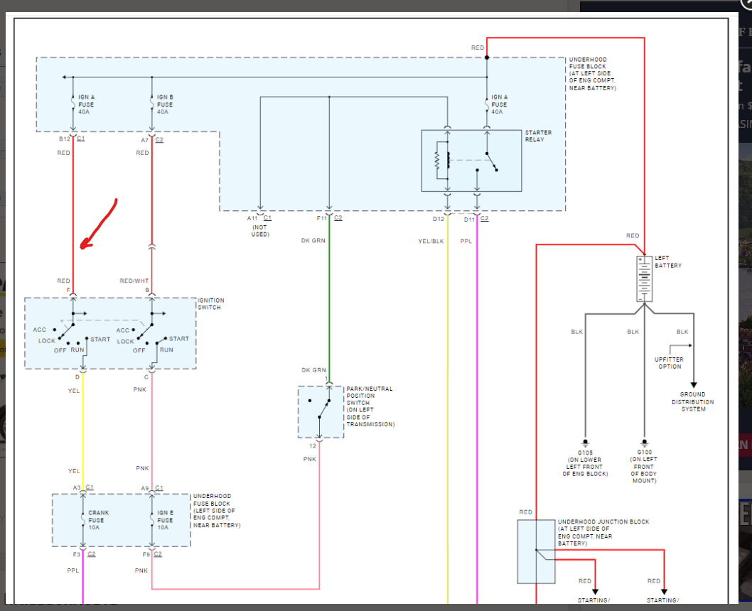

Can you please check to see if the red wire into the ignition switch has power when in the crank position?

The red wire is only getting a reading of 5 v.
Monday, July 29th, 2024 AT 1:57 PM
KEN L
  • 55,322 POSTS
You can see by the wiring diagrams it should have 12 volts, please check the voltage at the IGNA fuse.
Tuesday, July 30th, 2024 AT 9:29 AM
HAILEEGRACE12
  • 35 POSTS
Okay, my mistake. Yes, the fuse and the red wire are both getting 12 V.

Do you have power when the ignition switch is in crank mode to the yellow and red wire?
Wednesday, July 31st, 2024 AT 11:55 AM
HAILEEGRACE12
  • 35 POSTS
Yes they both have 12v +
Wednesday, July 31st, 2024 AT 12:02 PM
KEN L
  • 55,322 POSTS
Does the dark green wire coming out of the neutral safety switch had power when in the crank mode?
