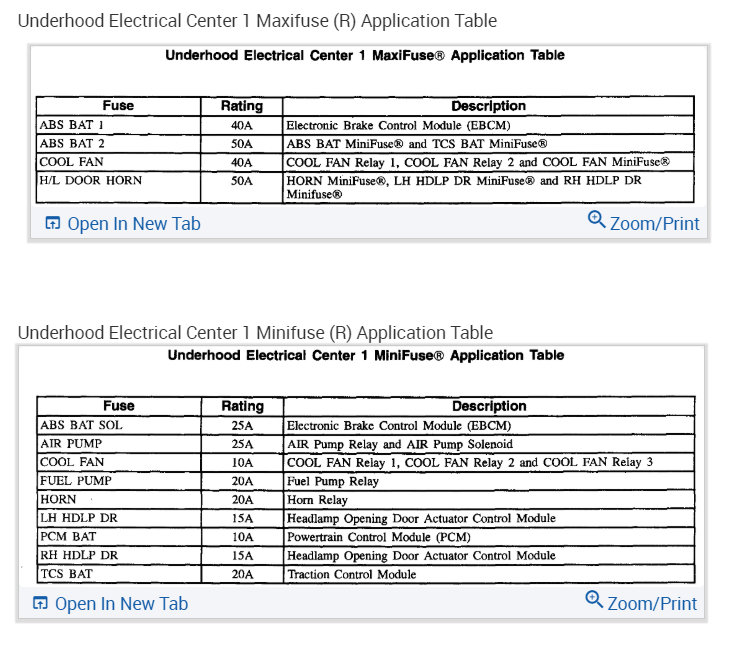

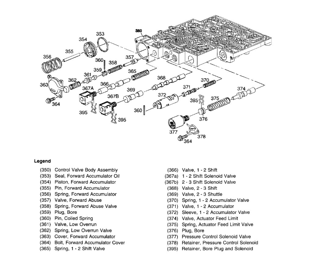

From park it will go into reverse after warmup. Will go into 1 and 2 but nothing when put into 3 or OD.
Tuesday, August 2nd, 2022 AT 9:29 AM
KEN L
MASTER CERTIFIED MECHANIC
55,499 POSTS

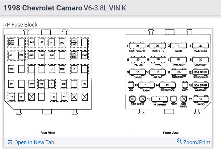

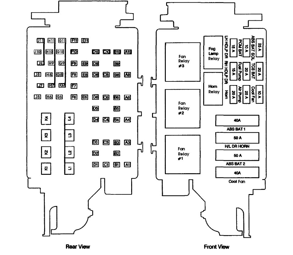

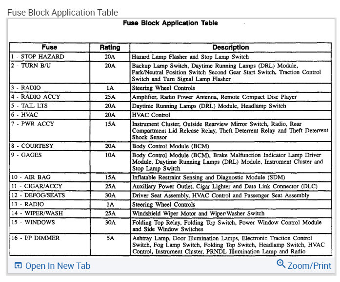

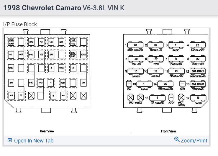

The first thing to do is check the fuses, transmission fluid level and run the codes.
Here are guides to help us:
and
and
https://www.2carpros.com/articles/how-to-check-and-add-transmission-fluid
It sounds like the fluid pressure control solenoid # 377 is not working, I have included its location in the diagrams as well. Check out the diagrams (below). Please let us know what you find. We are interested to see what it is.
