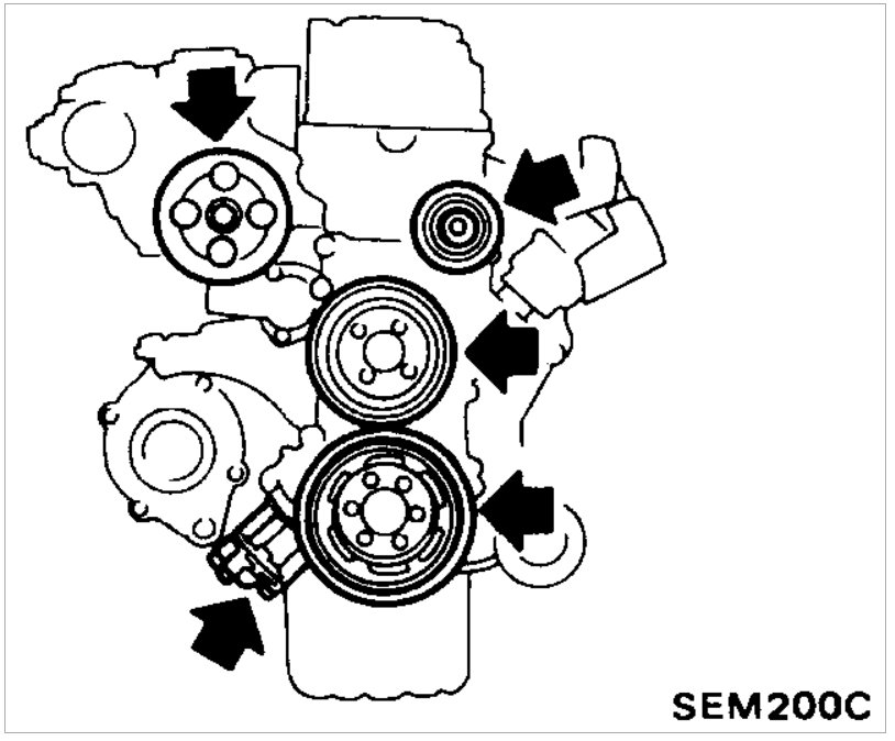

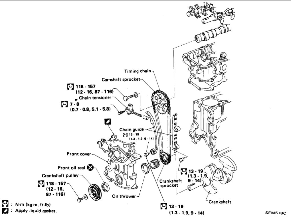

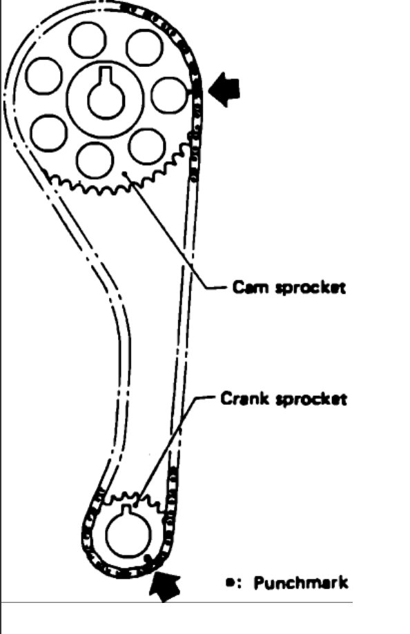

Does all marks have to align the crankshaft and camshaft with timing chain
Wednesday, July 29th, 2020 AT 1:36 PM (Merged)
BLUELIGHTNIN6
  • 16,542 POSTS
https://www.2carpros.com/forum/automotive_pictures/261618_Graphic_683.jpg
+4

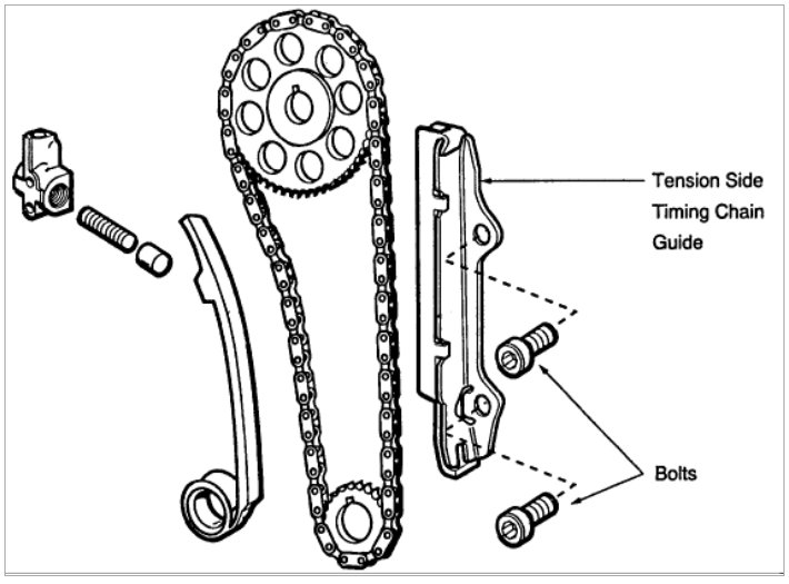

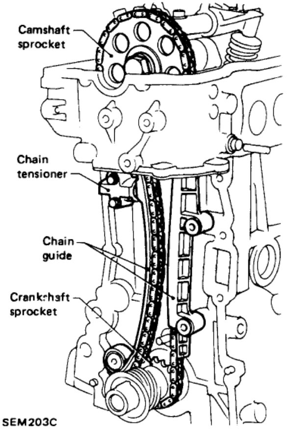

BE1974
  • 6 POSTS
Good diagram but it is a four cylinder with four spark plugs.
+2
BLUELIGHTNIN6
  • 16,542 POSTS
https://www.2carpros.com/forum/automotive_pictures/261618_Graphic_684.jpg
+9

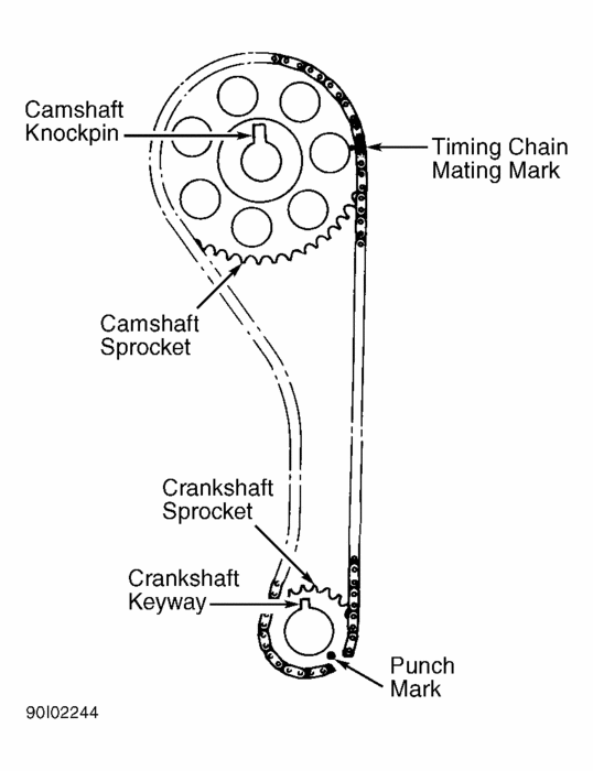

BE1974
  • 6 POSTS

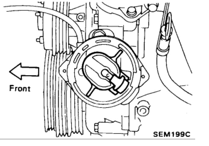

Thanks. Okay, does camshaft knock-pin always up or just align with timing chain?
+3
BLUELIGHTNIN6
  • 16,542 POSTS
Well, it spins in operation, but when replacing chain the cam knock-pin and crank sprocket key-way must point up (12 o'clock position).
+3

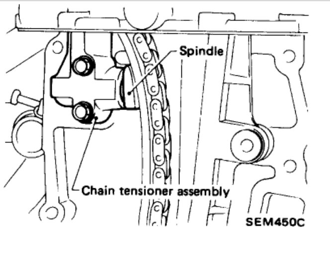

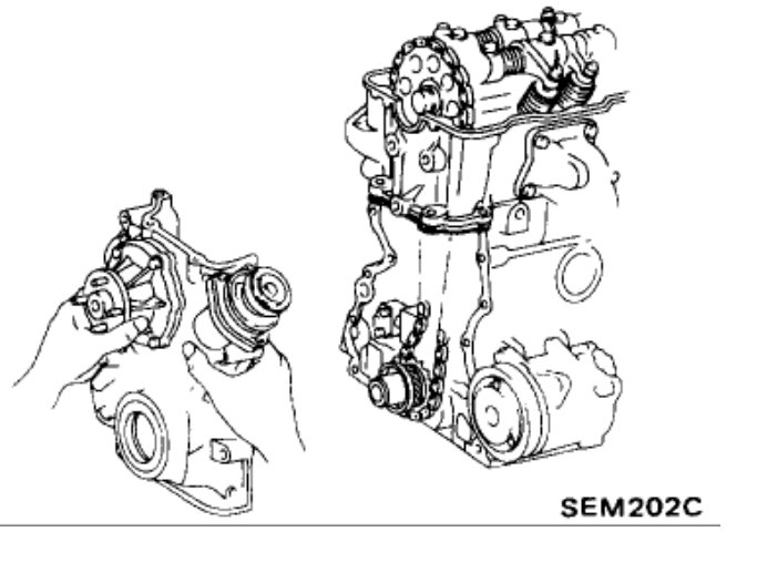

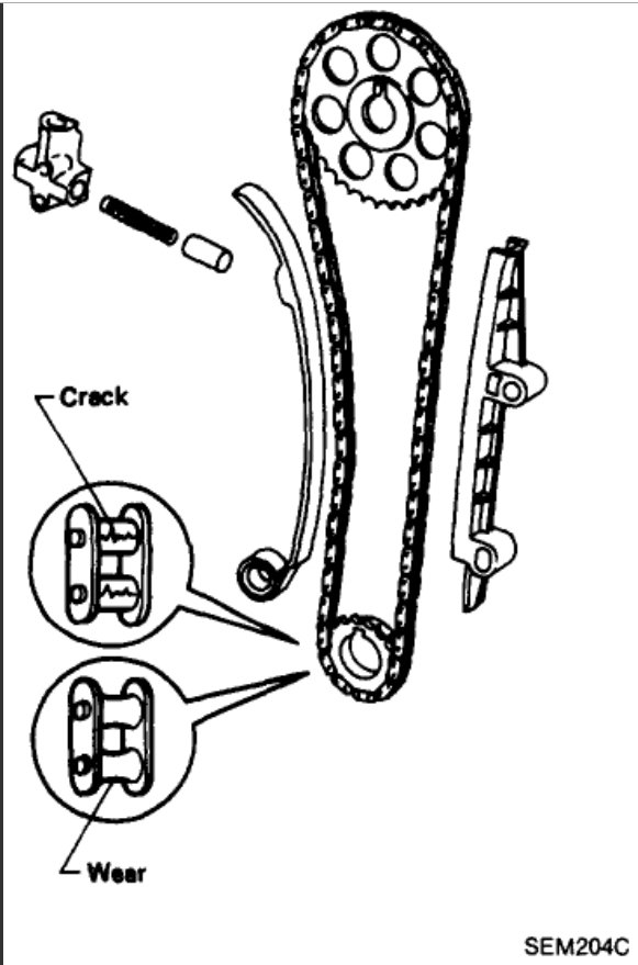

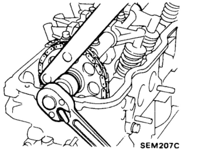

There are timing chain diagrams to show you how to install the chain and camshaft and crankshaft marks. (BELOW)
Here are the procedures and steps that are not relevant should be skipped.
Removal
1. Remove front cover. Carefully remove chain tensioner. DO NOT lose spring. Remove chain guides. Remove camshaft sprocket bolt, ensuring camshaft does not rotate. Remove timing chain and camshaft sprocket.
CAUTION:DO NOT rotate camshaft or crankshaft with timing chain
disconnected.
2. Remove oil slinger (if equipped). Remove oil pump drive gear (note installation direction). Remove crankshaft sprocket. Remove chain guide and tensioner.
Installation
1. Ensure No. 1 piston is at TDC of compression stroke. Camshaft knock-pin should be at 12 o'clock position. Align silver timing chain link with punch mark on sprocket.
2. Install timing chain onto crankshaft sprocket. Align marks on timing chain with marks on crankshaft sprocket. See Fig. 6. Both sprocket timing marks will be toward left of engine. Install chain guide and tensioner. Adjust chain guide tensioner.
3. Install oil pump drive gear onto crankshaft with large chamfered inner face toward rear. Install oil slinger (if equipped). To complete installation, reverse removal procedure.
