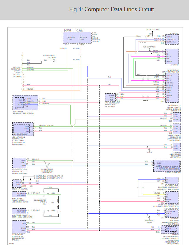

Okay, we are getting closer. When you run the codes did any come up? Also, lets check the fuses #12 and #19 to see if they have power with the key on?
Here is a wiring diagram to help you see how the ALDL is wired
Check out the diagrams (below). Please run this test and get back to us.

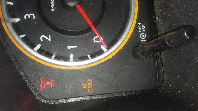

Okay, I checked those two fuses and they were fine, I am sending you a diagram of what my fuse panel looks like and also I never noticed this before but when I went to start the truck after this sign flashed saying at engine and then it went away.
Thursday, May 17th, 2018 AT 10:53 AM
CIARA VANLANDINGHAM
  • 25 POSTS
These are the images.
Thursday, May 17th, 2018 AT 11:00 AM

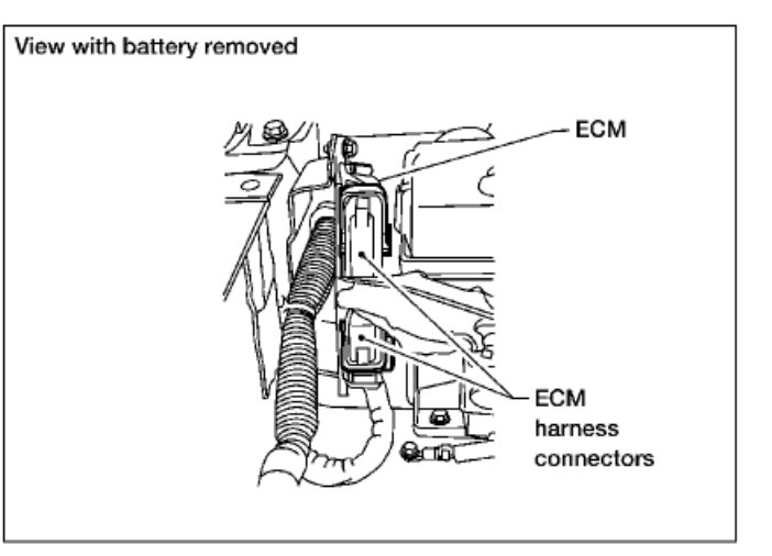

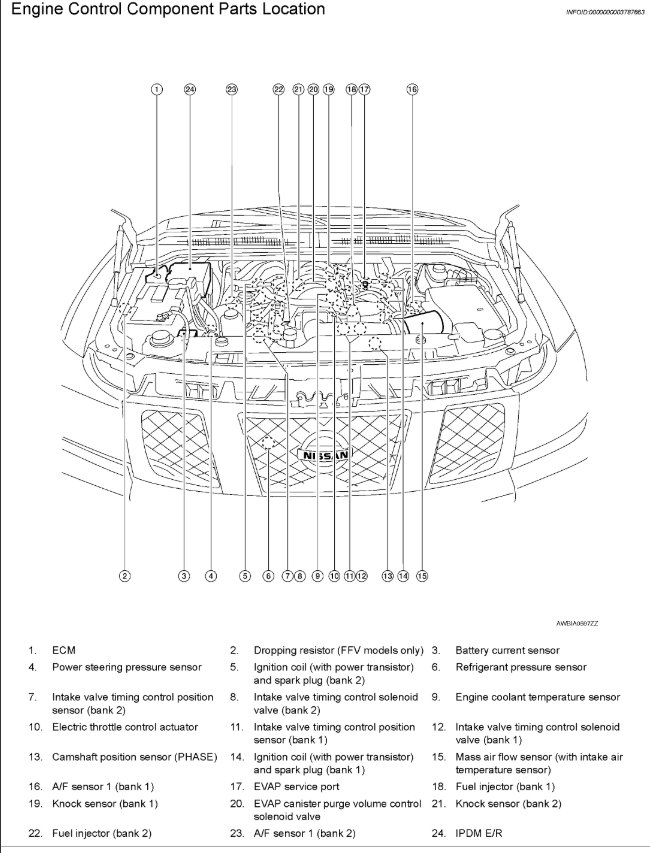

The PCM (ECM same thing ) is the engine computer. Here is the location.
Friday, May 18th, 2018 AT 9:55 AM
