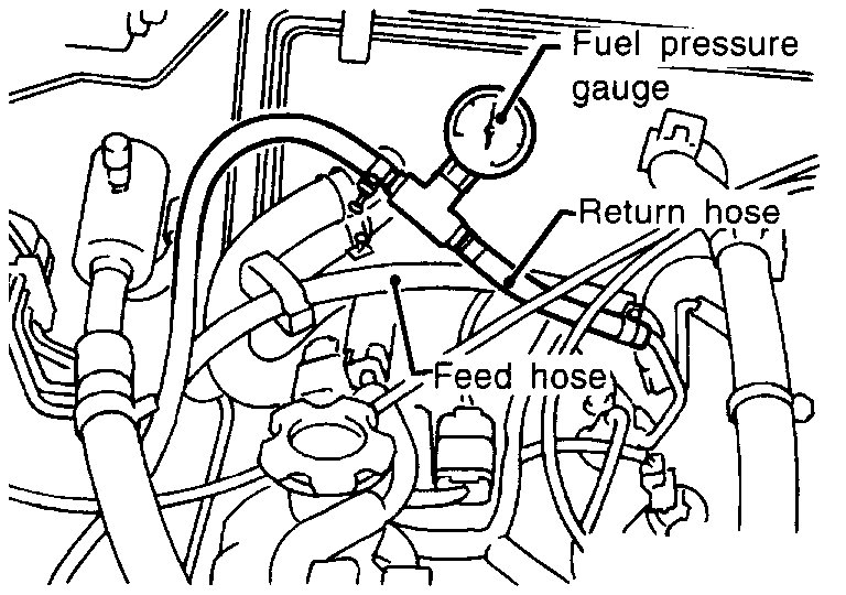

The problem is as follows:
When you give a lot of gas at idle it chokes. By giving the gas gradually it is going very well.
When it is hot it does not start anymore, you have to wait 20 minutes and it restarts slowly, you have to keep the rpm at 1,500 and more when you engage in first and following.
Until now we have changed:
To the fire distributor: the bearing, the coil, the distributor cap, the sensor position cam, the spark plugs, the spark plug wires, the crankshaft position sensor, the gas pump and cleaned the fuel vapor return hoses from the tank.
But the problem persists

Also, if you haven't already, reconfirm fuel pressure to make sure it is within spec. Here is a link that shows in general how that is done:
Here are the directions specific to your vehicle along with the manufacturer's specs. The attached pic correlates with these directions.

COMPONENT TESTS AND GENERAL DIAGNOSTICS
Fuel Pressure Check
-When reconnecting fuel line, always use new clamps.
-Make sure that clamp screw does not contact adjacent parts.
-Use a torque driver to tighten clamps.
-Use Pressure Gauge to check fuel pressure.
-Do not perform fuel pressure check with system operating. Fuel pressure gauge may indicate false readings.
pic 1
1. Release fuel pressure to zero.
2. Disconnect fuel hose between fuel filter and fuel tube (engine side).
3. Install pressure gauge between fuel filter and fuel tube.
4. Start engine and check for fuel leakage.
5. Read the indication of fuel pressure gauge.

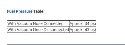

At idling:
With vacuum hose connected -
Approximately 235 kPa (2.4 kg/cm2, 34 psi)
With vacuum hose disconnected -
Approximately 294 kPa (3.0 kg/cm2, 43 psi)
If results are unsatisfactory, perform Fuel Pressure Regulator Check.

Even though you replace the fuel pump we need to start with checking fuel pressure at the rail.
This sounds like a fuel issue but if you have good fuel pressure then we can move onto other things but we need to eliminate that first.
The things that are pointing me there are the issue when you accelerate but if you give slow steady accelerator, it is fine. This is a sign that it is starved of fuel but when given steady throttle it can build the pressure.
It could also be a sensor issue but again we can get to this once we eliminate the fuel issue.
