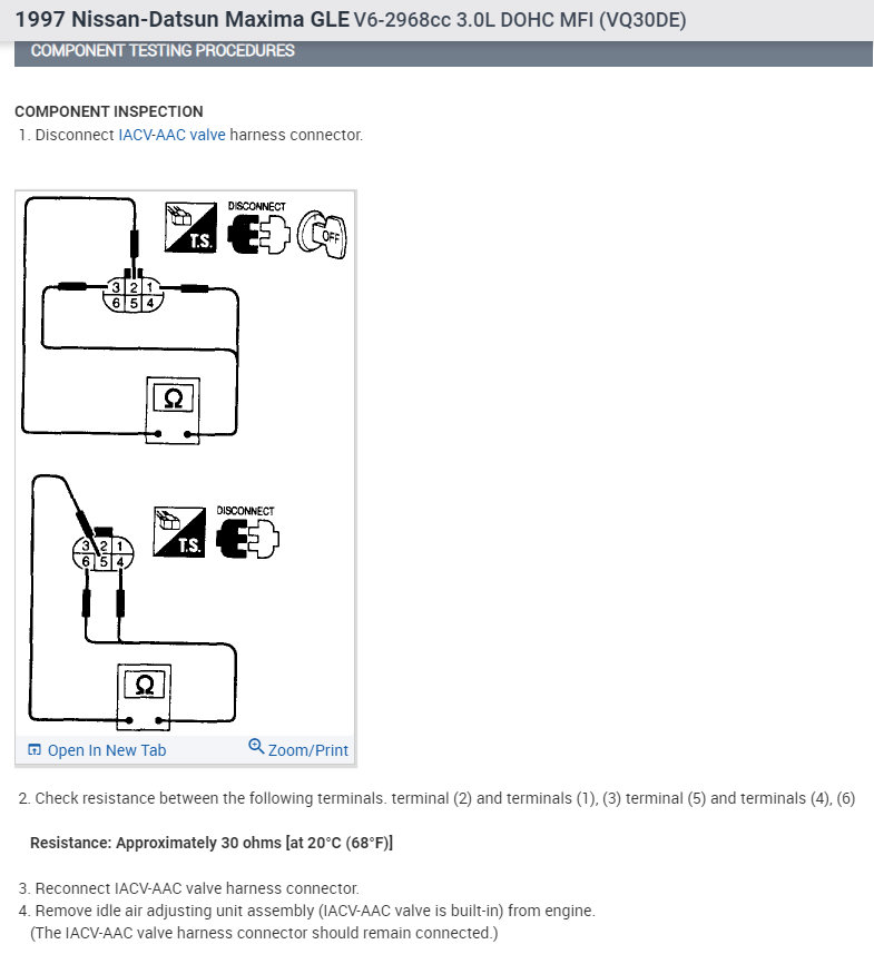

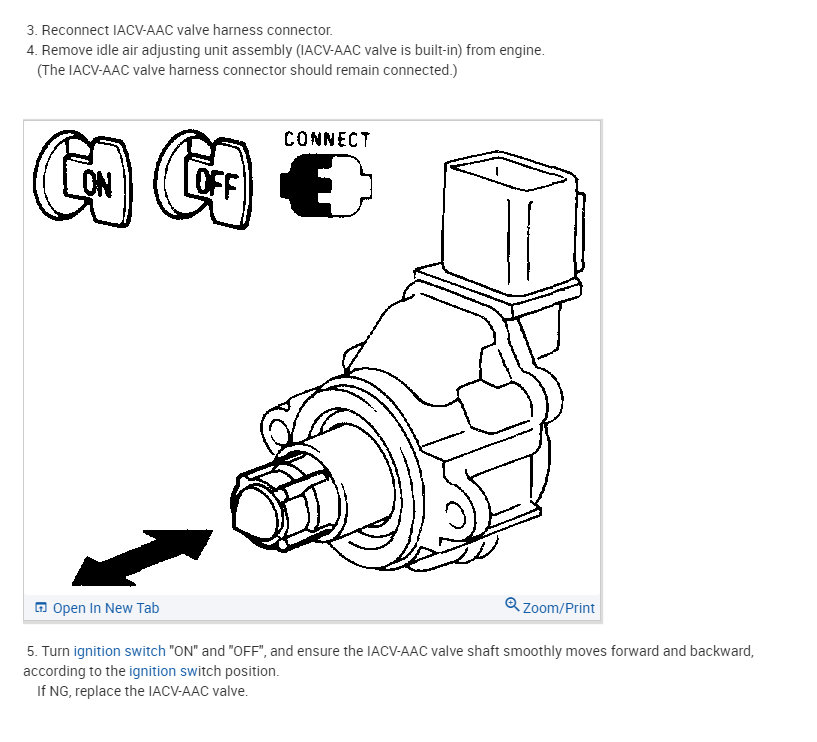

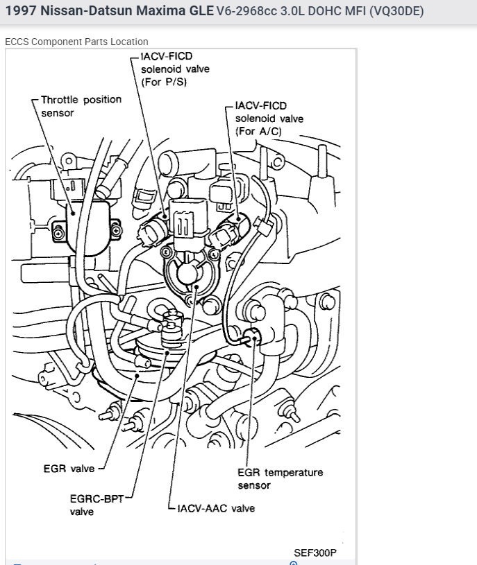

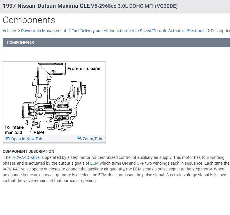

This issue could be due to a faulty throttle actuator or the idle up control valve that is located on the throttle actuator.
Overtime those components will have dirt and debris buildup inside, which can trigger the high idle.
https://www.2carpros.com/articles/engine-idles-too-high
Cleaning out the throttle actuator and the idle valve can improve the idle quality.
https://www.2carpros.com/articles/idle-air-control-valve-service
Are you getting any check engine light? If it is illuminated, it will be a good idea to scan and retrieve the code(s). As this can help with diagnostics.
