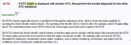

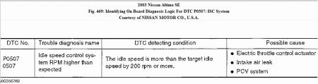

[quote="merlin2021"]Your Welcome! BTW if your check engine light is on, go to Autozone and have the codes read, they do it free, then post the code(s) here![/Quote
The code was P0507.I checked for a vaccum leak and had no luck finding one. I cleaned the throttle body. Where would the idle air control unit be located on this altima?Any info much appreciated
+1
Friday, February 1st, 2008 AT 6:33 AM
MERLIN2021
  • 17,250 POSTS

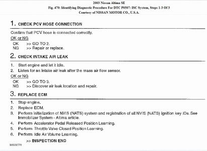

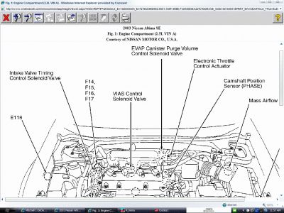

Here's what you need to check...the part is electronic on your car...electronic throttle control actuator....

Idles needs to be relearned with a capable scan tool or the throttle body assy needs replaced and the idle relearned by a capable scan tool.

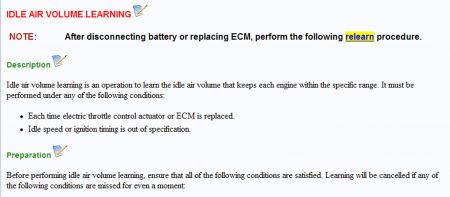

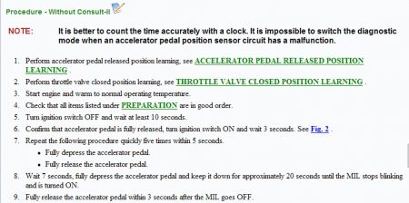

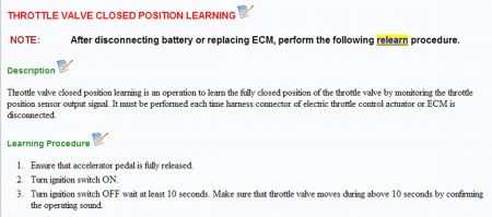

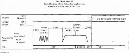

This is what happens when people need to be edjucated...they give bad advice...Relearn proceedures without Consult II tool are as follows...

I took the car to a certified nissan dealer and they checked and reprogrammed ECM and cleared code.
Car seems to be idling at normal speed now
