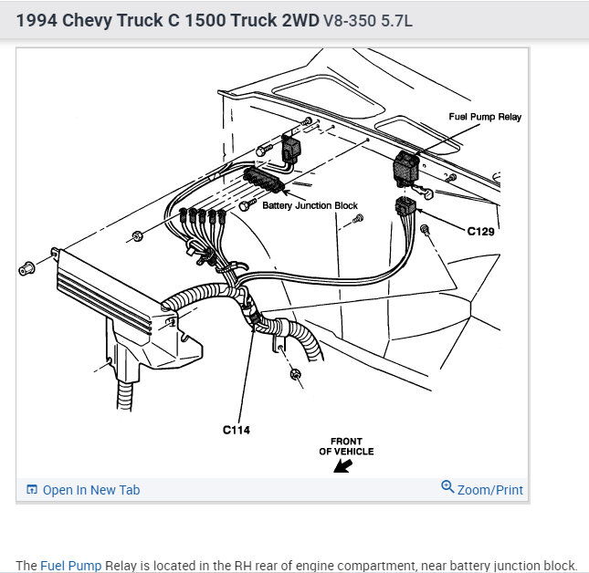

When you turn the key on, the pump should prime for approximately 2 seconds and then turn off. Once the engine starts, it should turn back on. Is that what is happening?
Do me a favor. The fuel pump relay is under the hood mounted on the firewall. Disconnect it and inspect the connection. Make sure there is no corrosion or damage on the connectors. If there is a different relay on the truck with the same part number, switch them and see if that makes a difference if there isn't, here is a link that explains how to test one:
I attached a pic below showing the relay location.
See pic below.
Sunday, December 18th, 2022 AT 11:06 AM

I replaced the relay during the first fuel pump issue. The fuel pump runs longer than 2 seconds and shuts after building up pressure but I can time it for you, both situations when it will run and when it won't (the pump kicks off sooner when it won't start. FYI. You can hear the difference when the pump runs. Both the pump does run in both situations, truck runs and when it doesn't, when the pump turns off in the shorter time. I have cracked the line loose at the fuel filter and there is no fuel there.

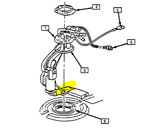

When you had the original pump removed, did you confirm there wasn't a lot of dirt at the bottom of the tank? Also, there is a fuel pump strainer at the bottom of the pump. Was it replaced? See pic below.
If there is no fuel to the filter, something is plugging it before the filter.

My tank started to leak. So, I replaced the tank and put a new fuel pump in at that time trying to eliminate potential future pump replacement, but the old pump worked fine.
