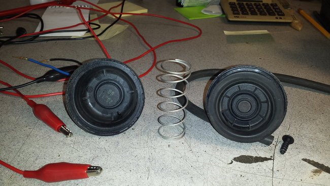

When the cold weather abates I will look into it as I am helping a good friend with it. My earlier ohms check read zero on the center pin of the cable towards the PCM to negative ground using my Fluke high impedance meter. I actually managed to get inside the IMSC actuator as I have ways of looking into things that others wouldn't dare to touch and put it back together with epoxy and maintained the vacuum diaphragm integrity throughout the device. The 3 pins are integrated into a sealed button on the top cap of the IMSC. There is a small magnet on the top of the actuator shaft which comes near when the actuator retracts and closes the butterflies with vacuum and activates the 3 pin button for an output. So, it has to get pretty darn close to do anything to effect a signal to the PCM as it is a small magnet. As I indicated before I could not manage any form of variable signal on the bench from the actuator. With 3 pins it does not appear to be rocket science as I have a degree in electronics from decades ago and now retired. I have constructed hall effect devices in circuits before so I suspected it was either some form of hall effect device or otherwise and internal sealed mechanical switch or as you indicated might be a potentiometer. In either case I cannot effect any output change. I guess I will have to play with it a little more.

Can you send images of the IMSC actuator I always wanted to see inside. It sounds like the actuator is not responding.

Sure thing Ken... The left shows the sealed round button inside the cap which is attached to the 3 pins on the opposite side not shown... The right shows the small round magnet attached to the moveable shaft which when coming close to the cap button on butterfly closure then activates the 3 pin button device on the left... The spring pushes the butterflies open and magnet away from the electronic button with absence of vacuum... Taking it apart and putting it back together and making it work again with vacuum to activate the shaft is tricky, but fortunately with my extensive mechanical and machine background along with electrical experience I can sometimes go where others have not gone before... Sometimes you win and sometimes you don't... Grateful for a win this time... Problem now is locating a replacement without purchasing a whole new manifold...
