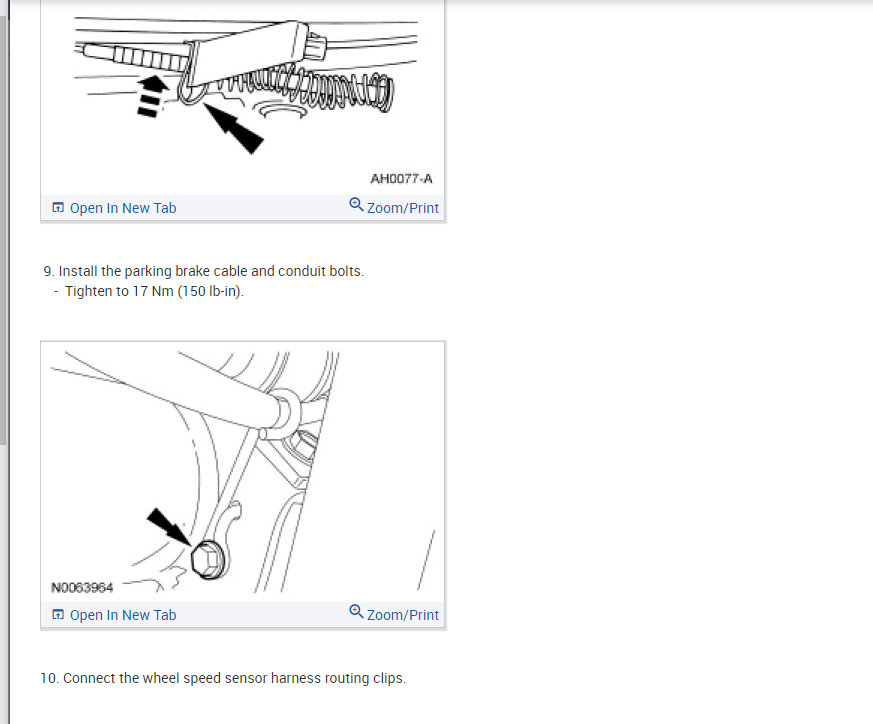

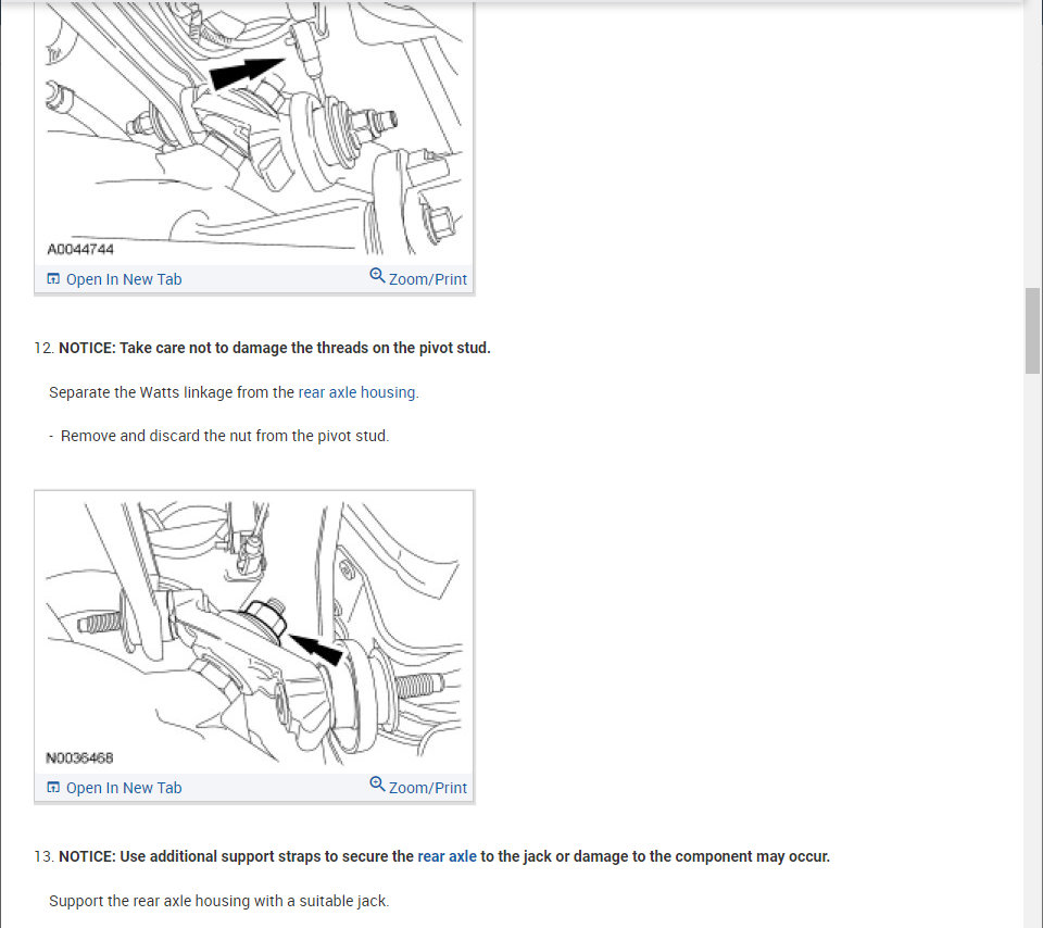

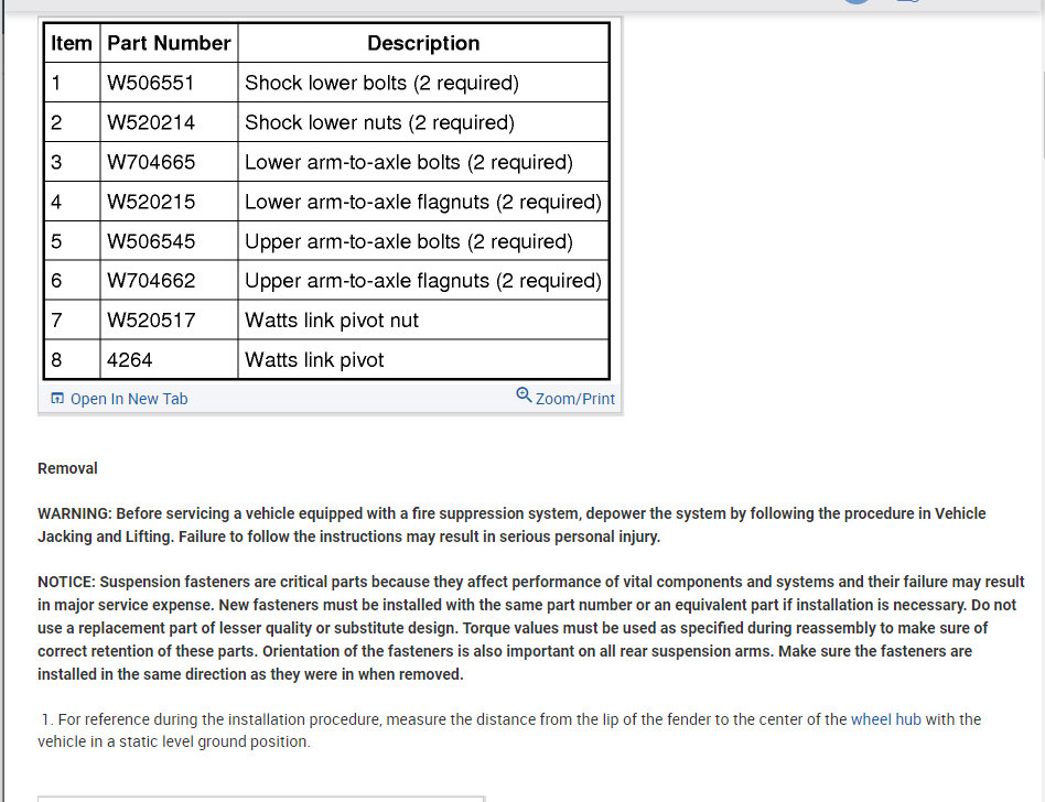

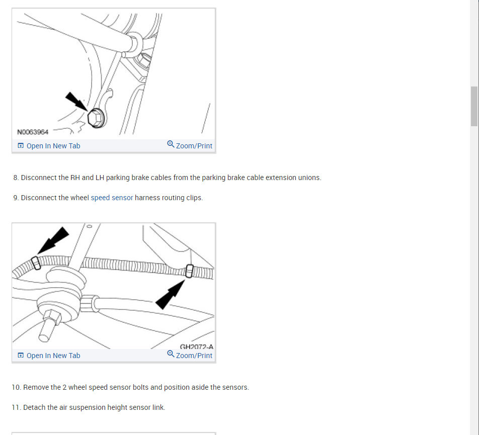

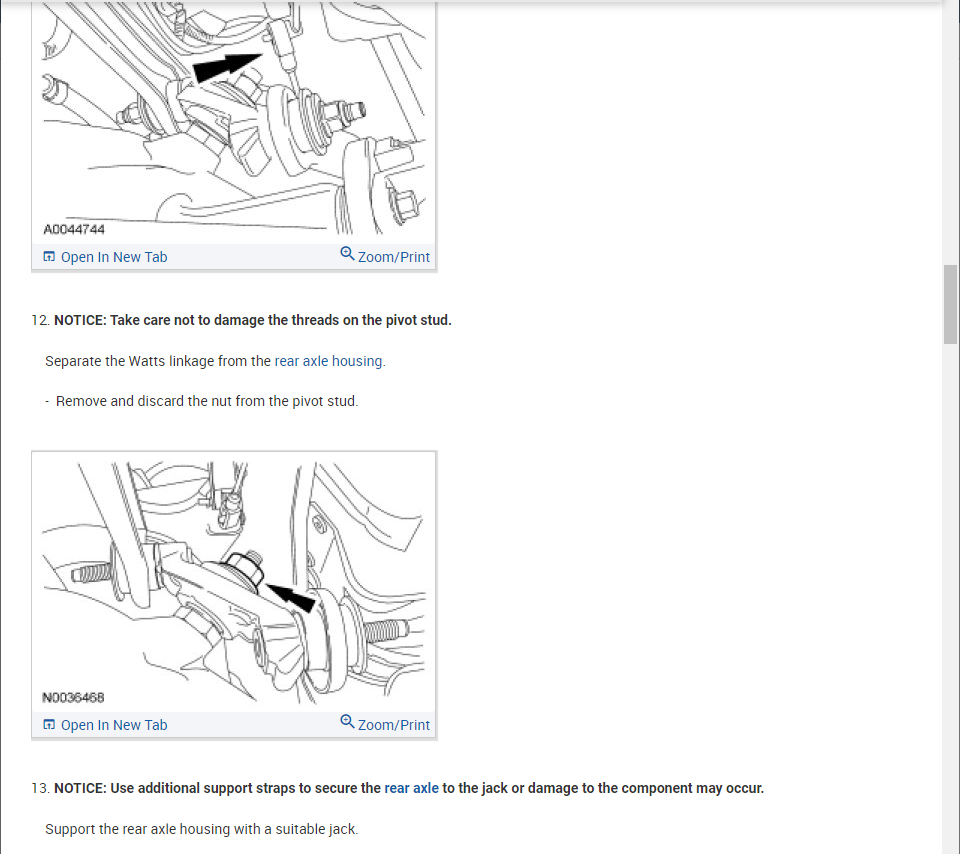

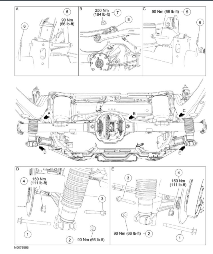

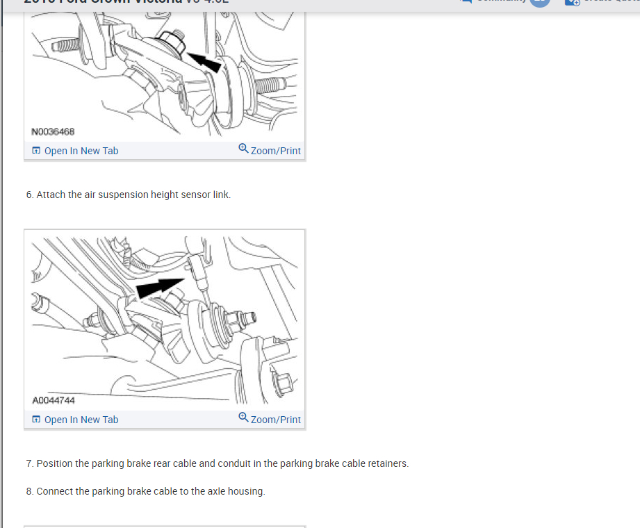

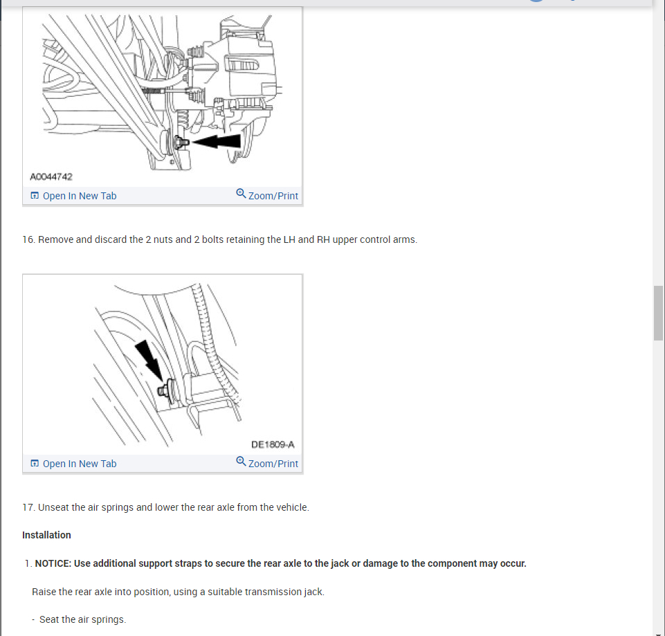

Replacing the rear end.
Friday, June 18th, 2021 AT 6:25 PM
MECHANIC
18,907 POSTS

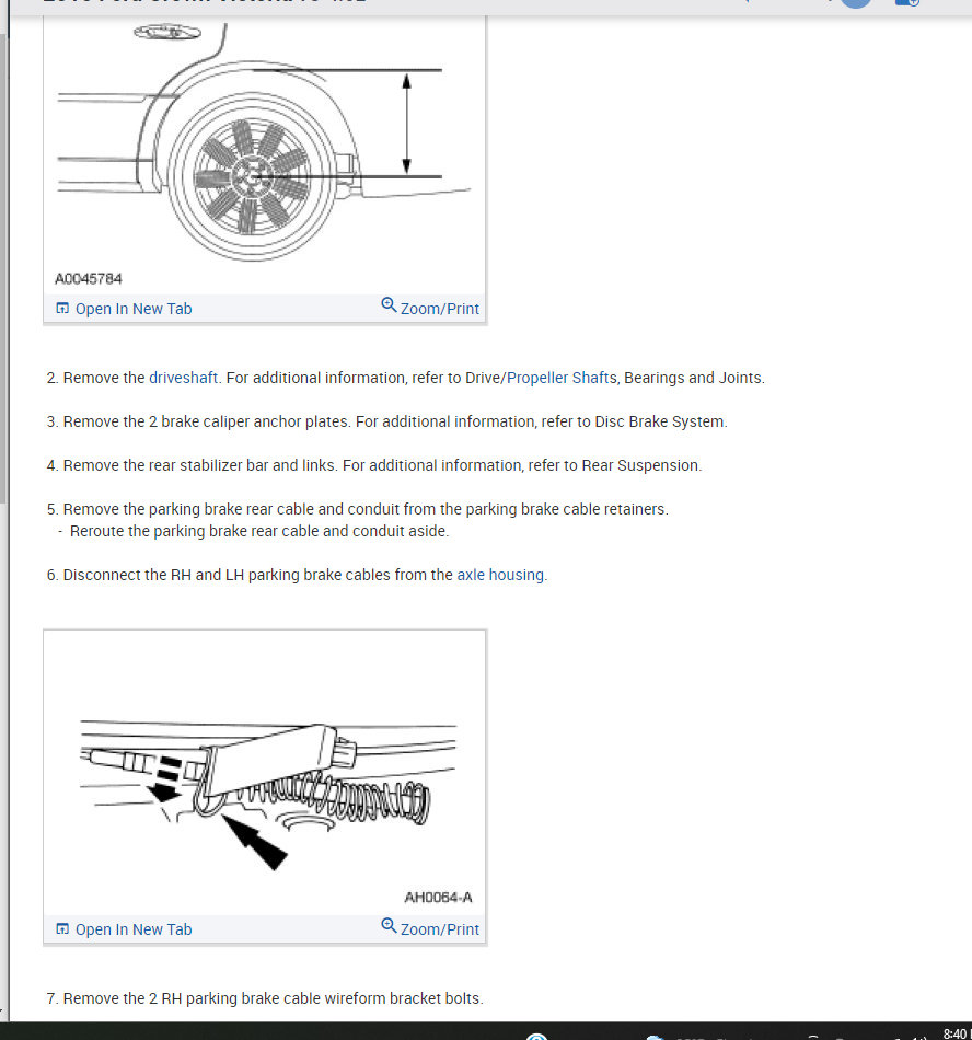

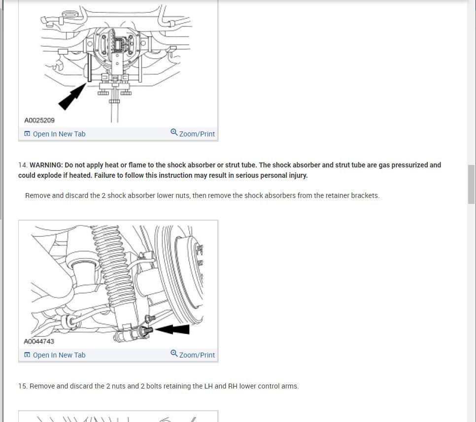

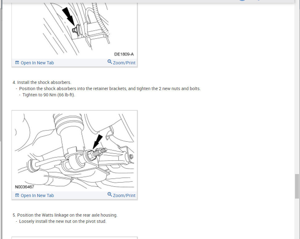

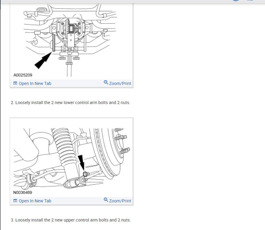

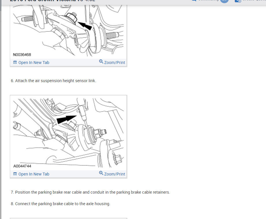

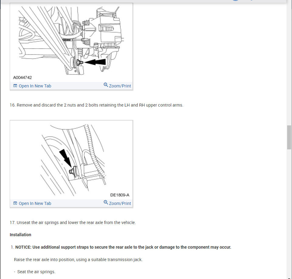

Here is the complete process from the manual on the rear axle assembly.
You are going to need a couple of these guides that will give more detail on how to do some of the things that are required to do this.
https://www.2carpros.com/articles/how-to-remove-a-drive-shaft
https://www.2carpros.com/articles/differential-service
https://www.2carpros.com/articles/how-a-differential-works
Please run through this material and let us know if you have more questions.
Thanks
