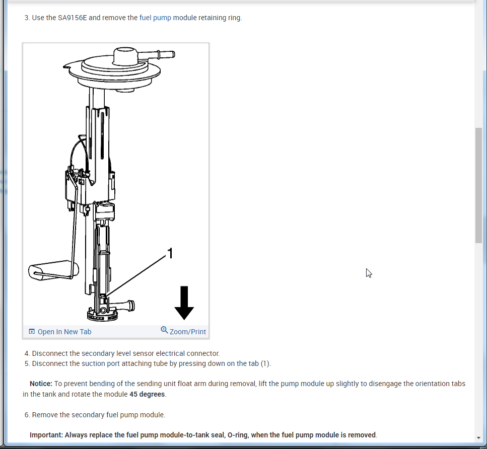

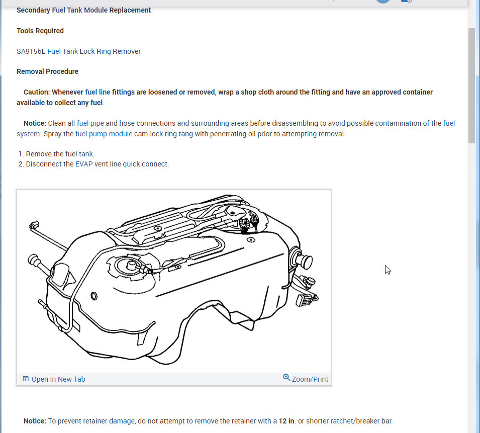

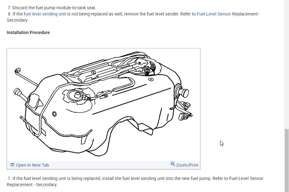

As for not starting we need to find out if we have fuel and spark as we can assume we have compression at this point. We can come back to that later.
Here are some guides that will help with that:

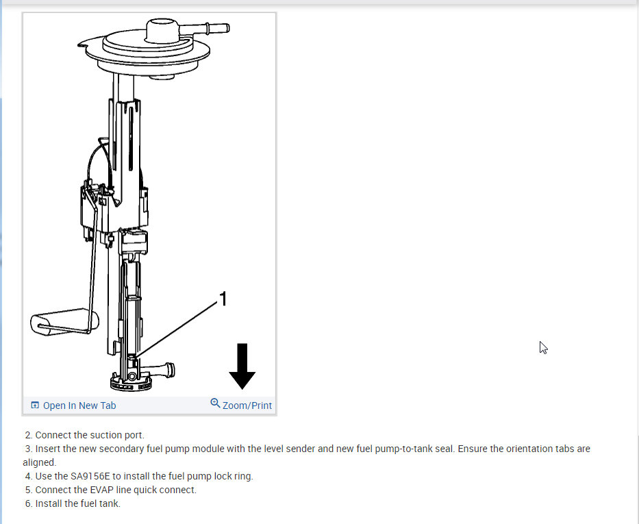

I would suggest we start with checking the fuel pressure.
Below you will find the process from the manual on how to replace the pump if it proves out to be the issue.
Let us know what you find with this material and we can go from there.

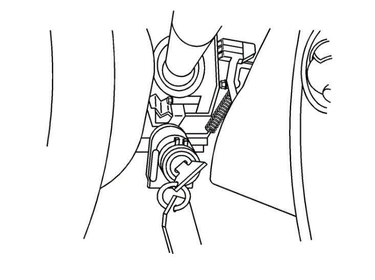

My key won't turn when I put it in the ignition to start it. I've tried everything. It's time for me to get it fixed but I would rather do it myself. Is there instructions to change an Ignition Lock Cylinder?

Good morning,
You can either call a locksmith to come to you and make a new set of keys or replace the cylinder.
It would be easier to have the locksmith come to you.
I attached the procedure for replacing the lock cylinder as well.
If the cylinder does not turn, as you indicated, then you will need to drill out that pin.
Ignition Lock Cylinder Replacement
Removal Procedure
Important: The Vehicle must be in PARK prior to ignition cylinder removal.
1. Disconnect the negative battery cable.
2. Disable the SIR system. See: Air Bag(s) Arming and Disarming > Procedures
3. Remove the steering column trim covers. See: Steering Column > Removal and Replacement > Steering Column Trim Covers
4. Remove the park lock cable from the bottom of the housing.
ImageOpen In New TabZoom/Print

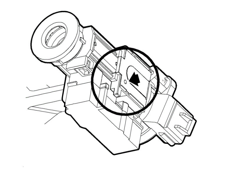

5. Insert key into the ignition and rotate to the RUN position.
6. Depress the locking button through hole on side of ignition module assembly with a thin pick-type tool.
7. Rotate the ignition cylinder back from the ACC position.
8. Slide the lock cylinder to the ignition housing.
