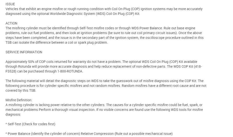

My engine shakes when at idle and this has lead to my car consuming too much gas.
Sunday, March 1st, 2020 AT 12:49 PM
MECHANIC
52,796 POSTS
Good afternoon,
Do you have any codes set?

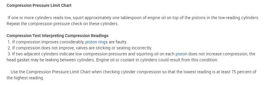

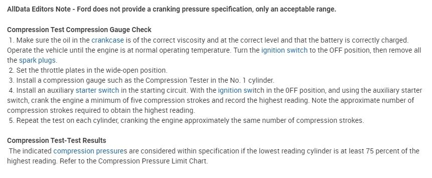

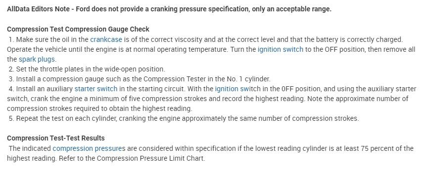

It sounds like a misfire. I would start with a compression test to test for a bad cylinder.
