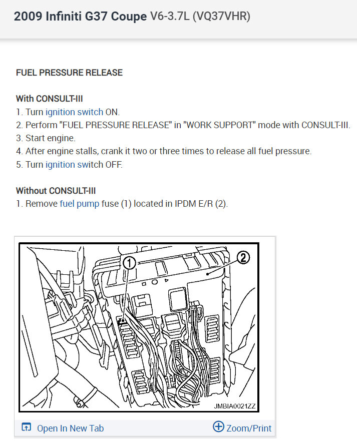

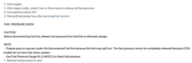

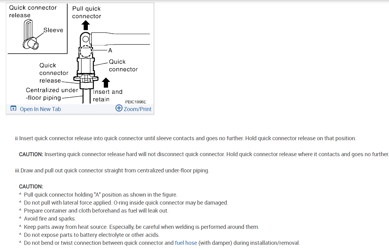

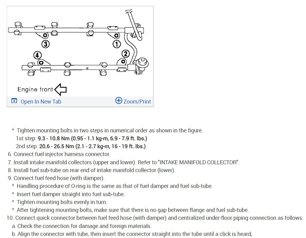

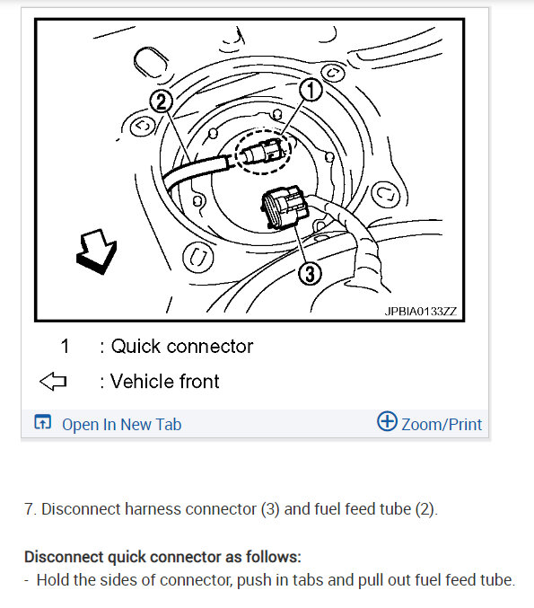

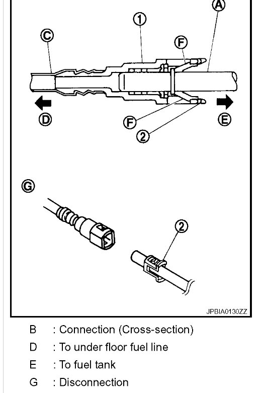

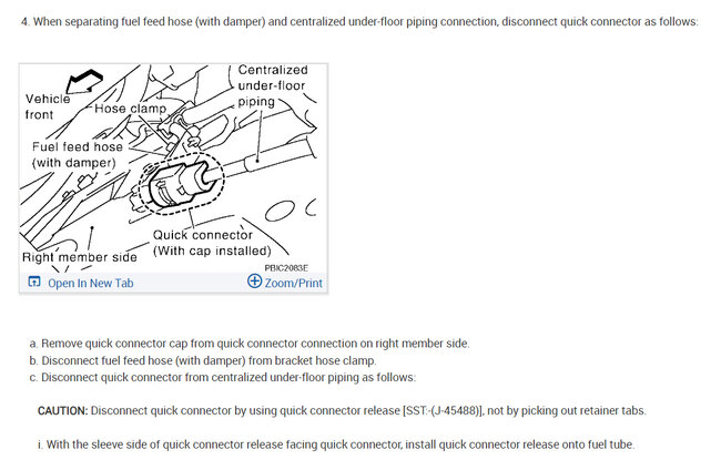

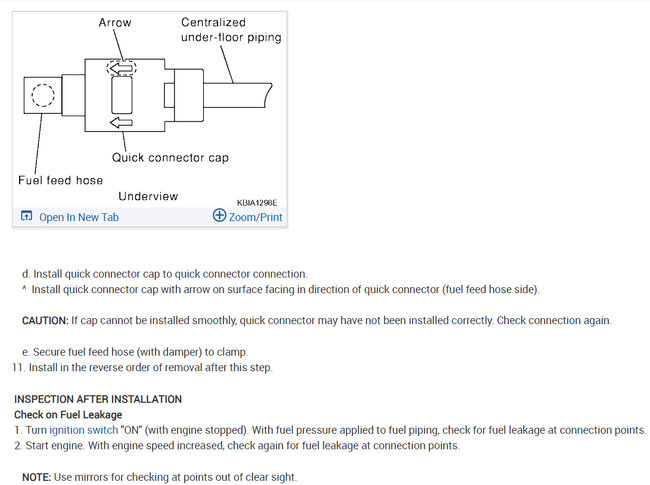

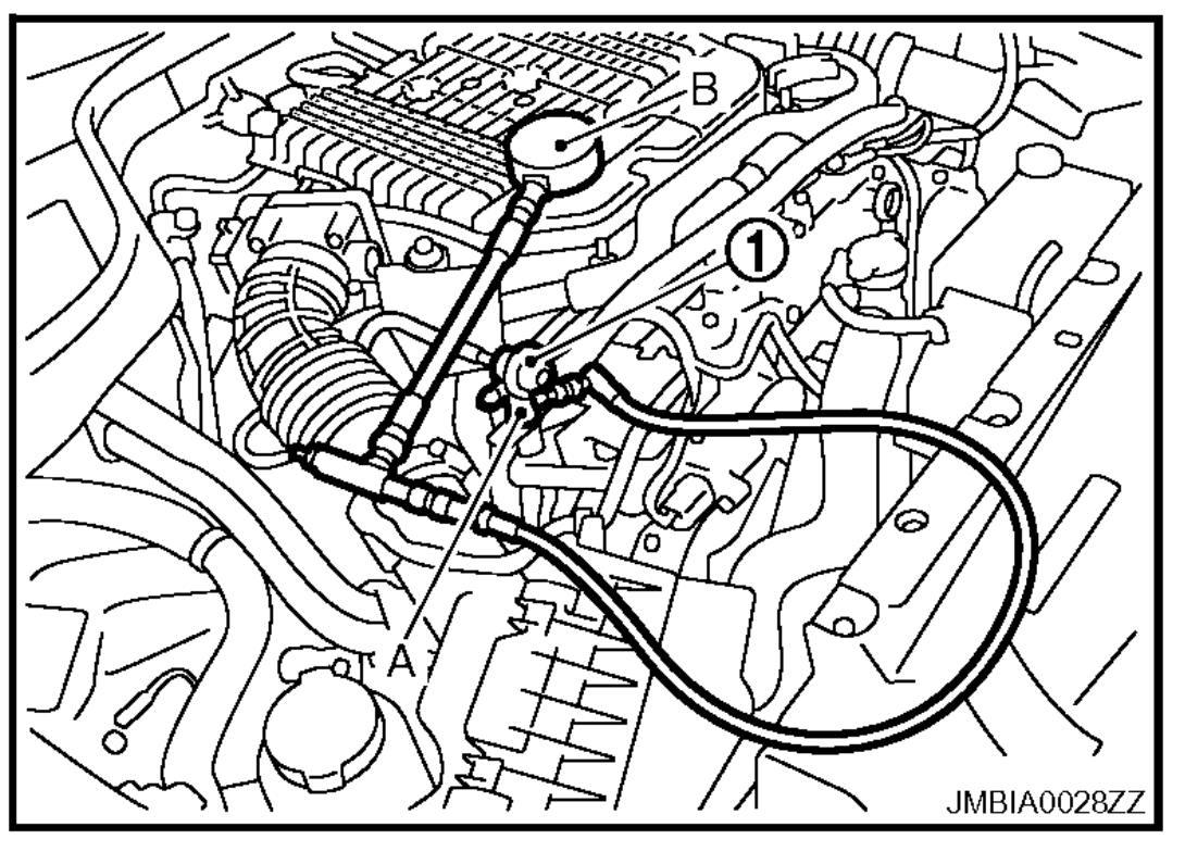

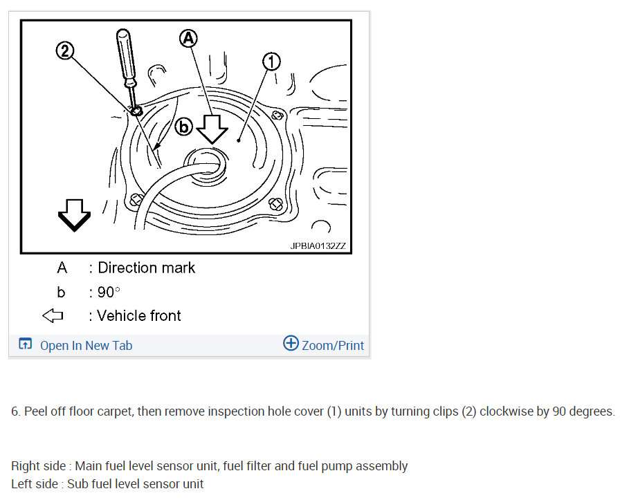

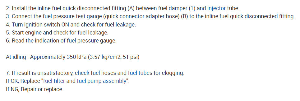

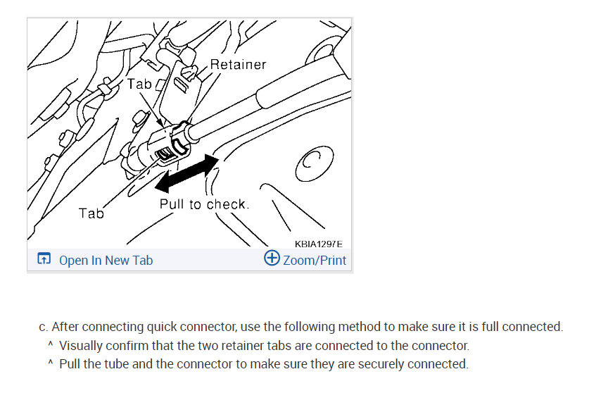

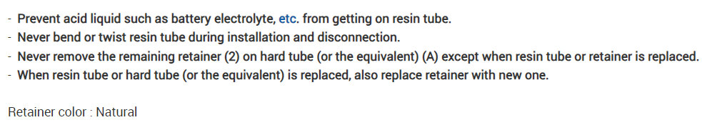

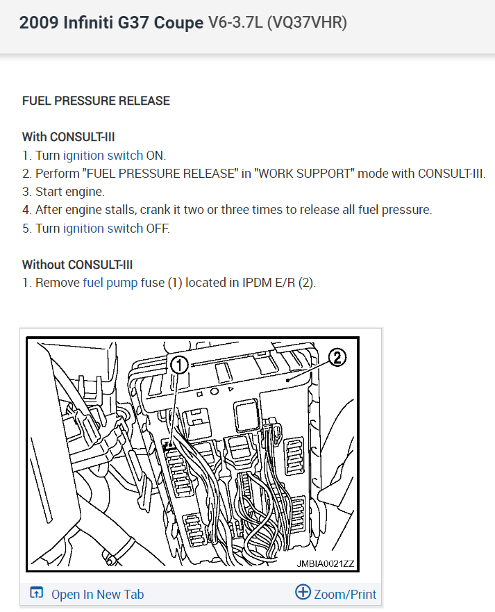

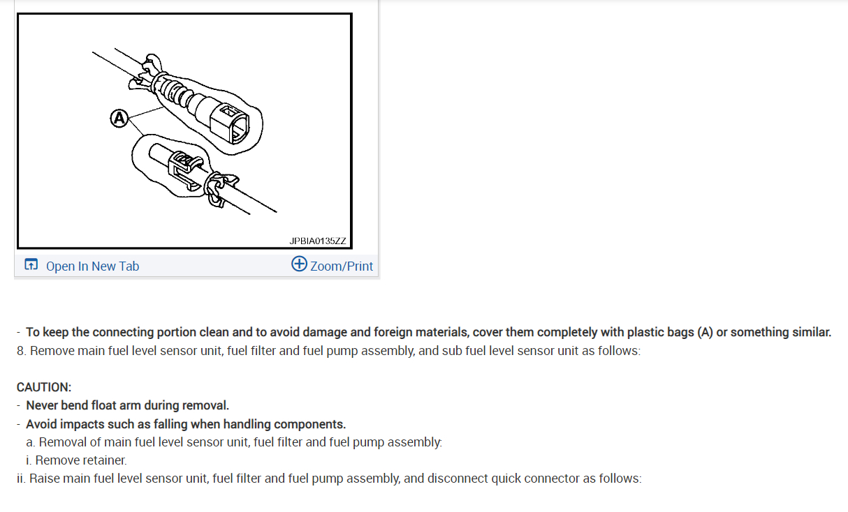

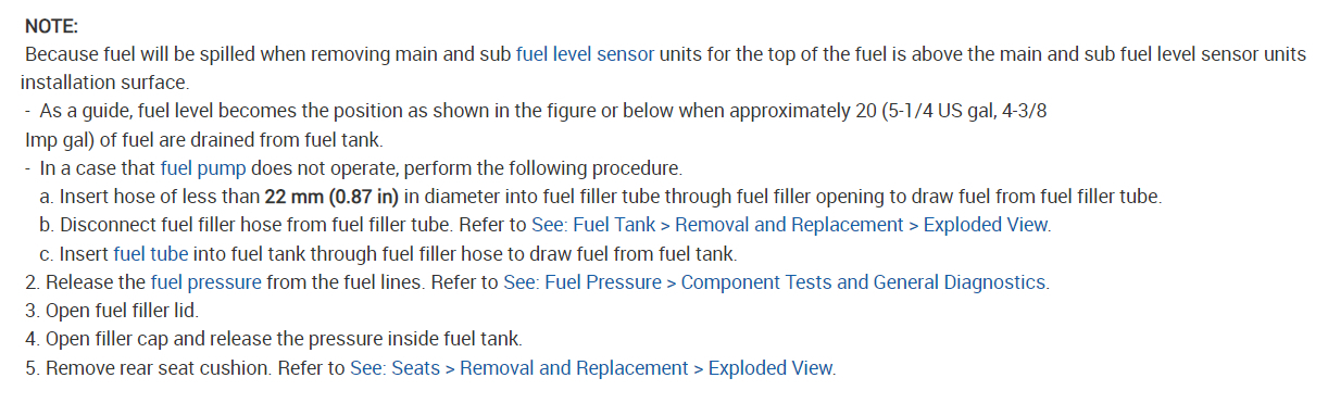

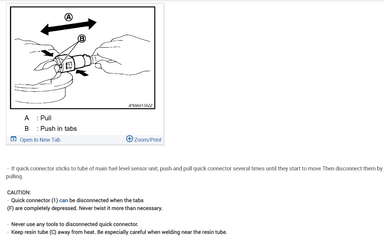

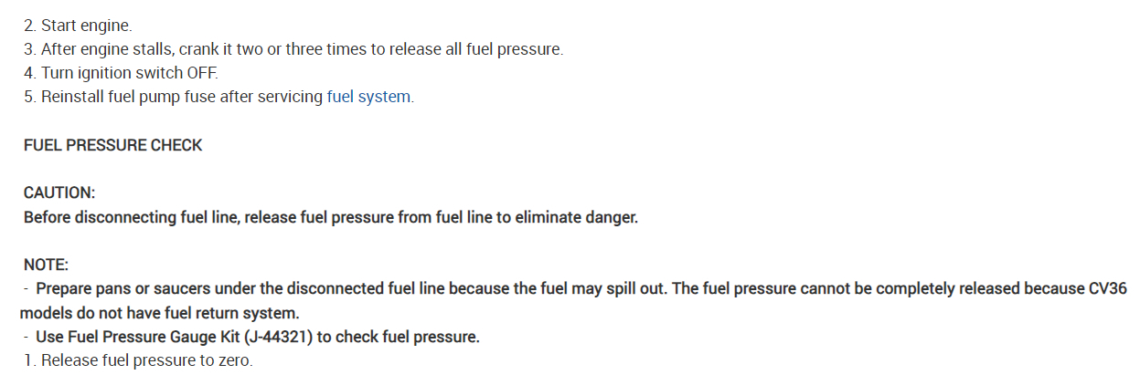

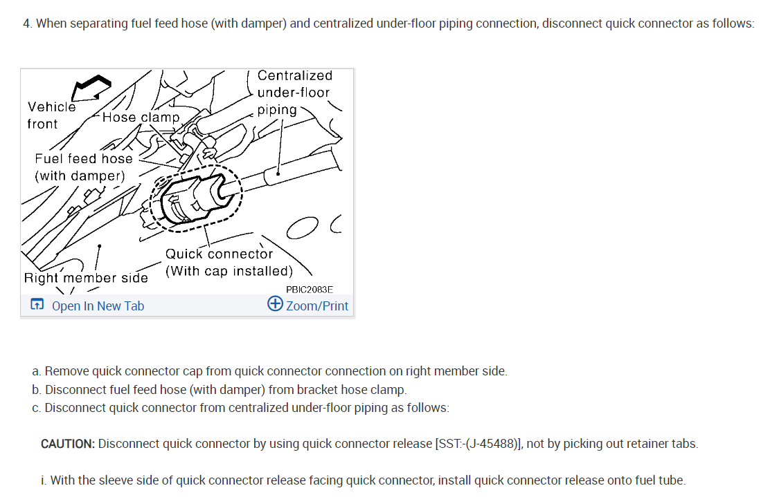

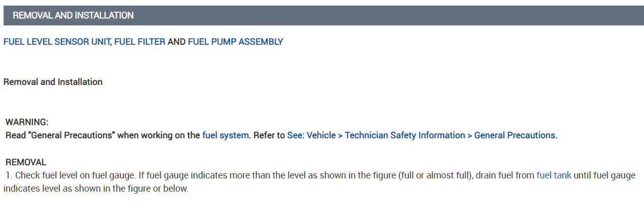

It sounds like the fuel pump is getting weak but to be sure we can do a pressure test which you can rent the gauge from the auto parts store for cheap or free. This guide can help walk you through it and I have included how to test your car in the images below:
Fuel Pressure
At idling .................... Approximately 350 kPa (3.57 kg/cm2, 51 psi)

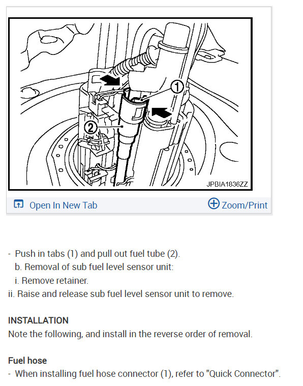

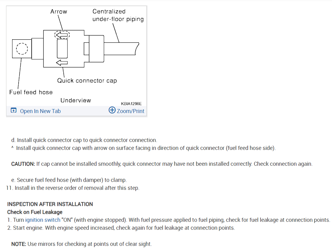

I have also included how to change the fuel pump out as well. Check out the images (below). Please upload pictures or videos in your response to the problem so we can see what's going on.

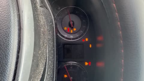

Is this what would be expected with low fuel pressure? Or is there a different direction I should be looking?

Thanks for the video, it helped. It sounds like you have low compression in one or more cylinders, let's do a compression test on the engine before we go any further. This guide can help:

I’m struggling to do the next tests. The picture shown looks like you are tapping into the fuel dampener for the fuel pressure test, but it is a solid line with no way to disconnect and insert the fuel pressure gauge. I tried to do a compression test, but my tester is too big and won’t screw into the spark plug hole.
One thing I have noticed is that there is a very strong fuel smell when it’s running but I’m not seeing any fuel leaks. Given the strong smell, would you dismiss any fuel delivery issue? What would cause such a strong fuel smell?

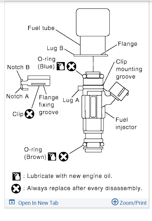

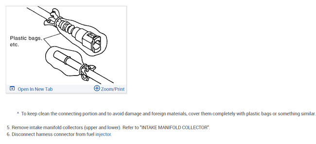

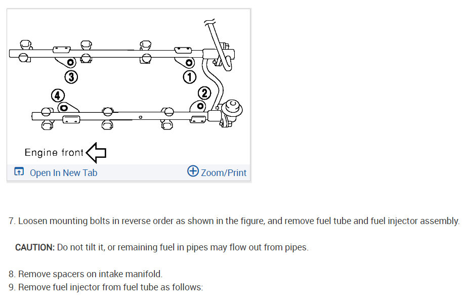

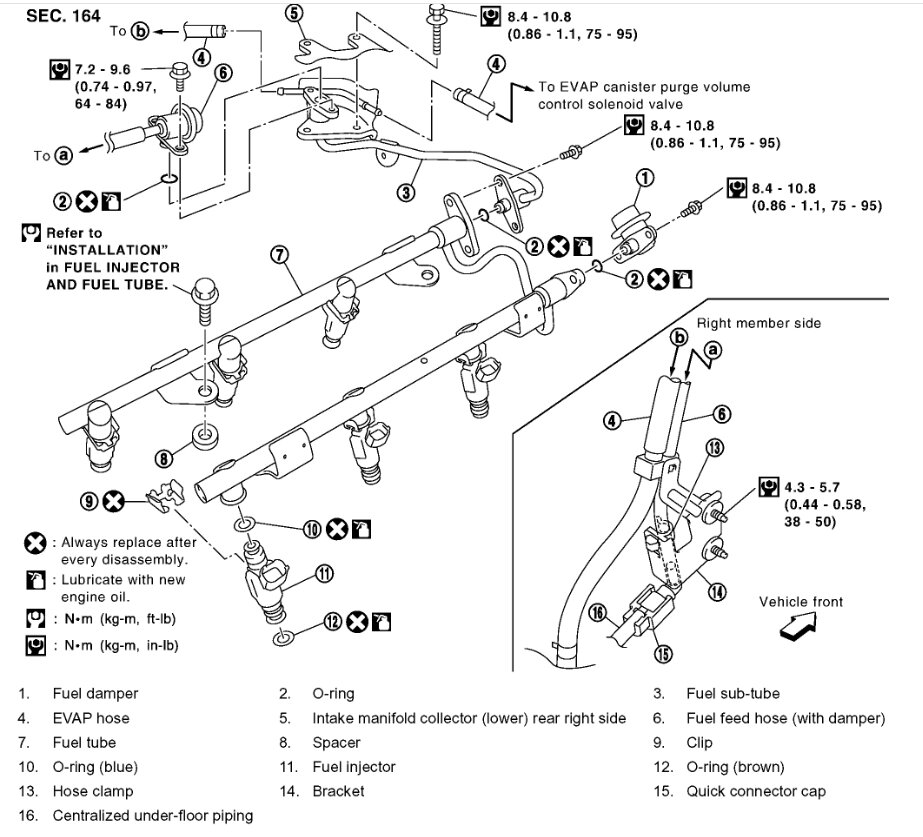

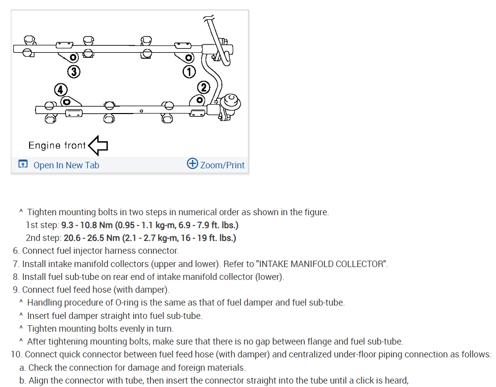

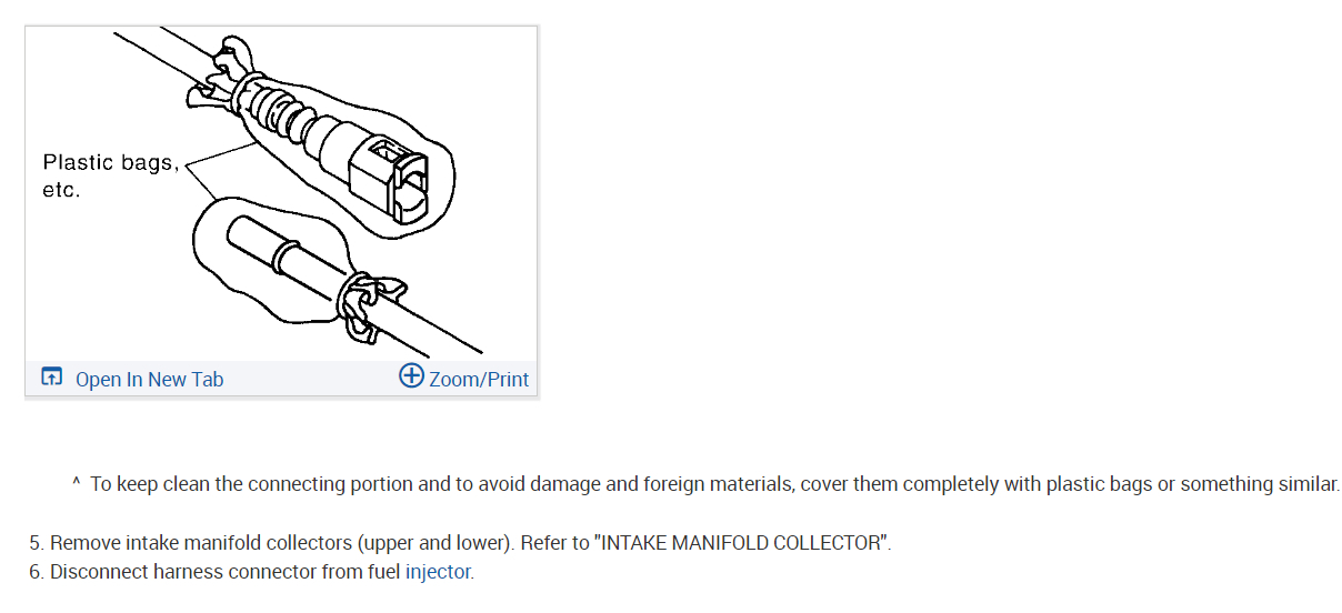

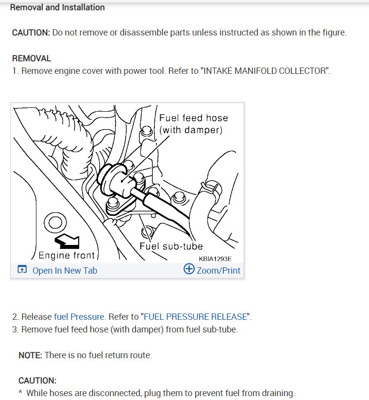

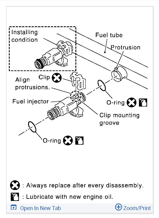

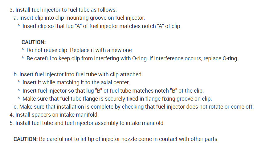

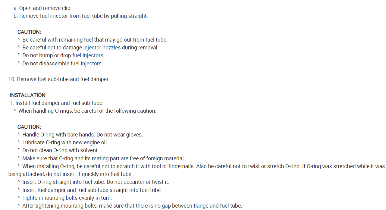

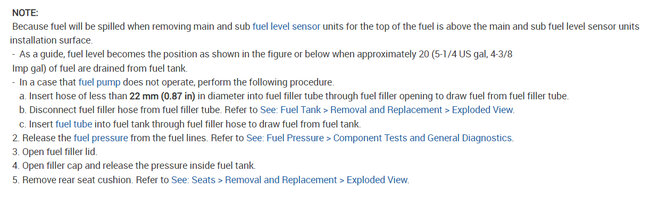

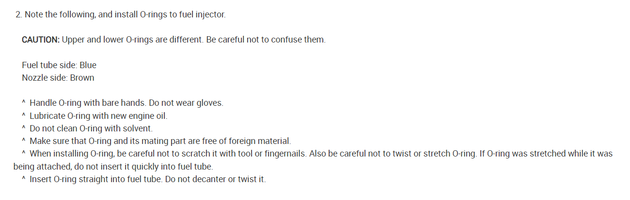

Yes, the injector sounds like it is the problem, here is how to test the injectors and how to remove them:
https://www.2carpros.com/articles/how-to-test-a-fuel-injector
If you find the injectors to be bad, I would replace them all with this kind of mileage teh others are right behind. Check out the images (below). Let us know how it goes. BTW the fuel injector can wash the oil from the cylinder wall causing the low compression.
