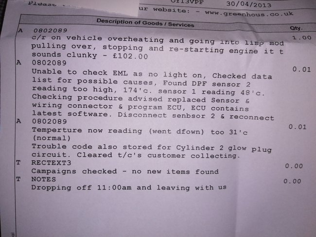

Hello Joe, been a while since I last messaged. Unfortunately since the car had the battery changed the car broke down with the same problem. My mechanic has changed the temperature sensor however said this was not the problem. I've since had the car in at Vauxhall for a test and they've responded saying the only problem they can find is a part of the exhaust was reading as high whereas the other part wasn't. Any ideas if this could be the problem? They've quoted me over £300 for something that's not a cast iron answer.

Just had the invoice back from Vauxhall. They have stated the DPF sensor (number 2)is running high and when reconnected went back down to the correct temperature. They have advised that I need a new one and connection. Could this be the issue? The mechanic explained to me the second sensor should read lower then the first and due to the second one being so high its sending a message to the ecu. Once again he caveated this by saying it's not a guaranteed fix only a known issue with Vauxhall.

Through Vauxhall it would be over £300. I've asked a local mechanic to quote it. The issue is the only thing that popped up was the exhaust sensor apparently everything else including the software of the car is up to date. Nightmare this is turning out to be. So far I've had the battery changed and the temperature sensor. When I had the temperature sensor done I also had my second glow plug changed as it had needed to be replaced for 3 years. I'm hoping that maybe the temperature sensor was the cause and if not this sensor is the problem.
My local mechanic said the same as you though. He's never known a the named sensor to cause the car to display an engine overheating message.
I stated that to the Vauxhall mechanic and he just said that Vauxhall have this as a known problem. But like mentioned above he couldn't guarantee it's the problem. I'm trying to work out now how much the sensor is to purchase and if it needs to be a manufacturer specific part.

LEWIS EVERISS
  • 7 POSTS
Please see the image.
May 19, 2020 at 2:44 AM
  • 110,190 POSTS
When you spoke with him and he said it's a known problem, did he feel it could cause the issues you experience? That is where not being familiar with Vauxhall makes it hard for me.
If he feels it could cause the symptoms, have it done. Looking at the pic you attached indicates a problem with it. Is there any other shop in your area that you trust for an opinion?
