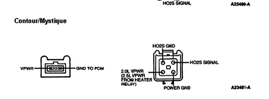

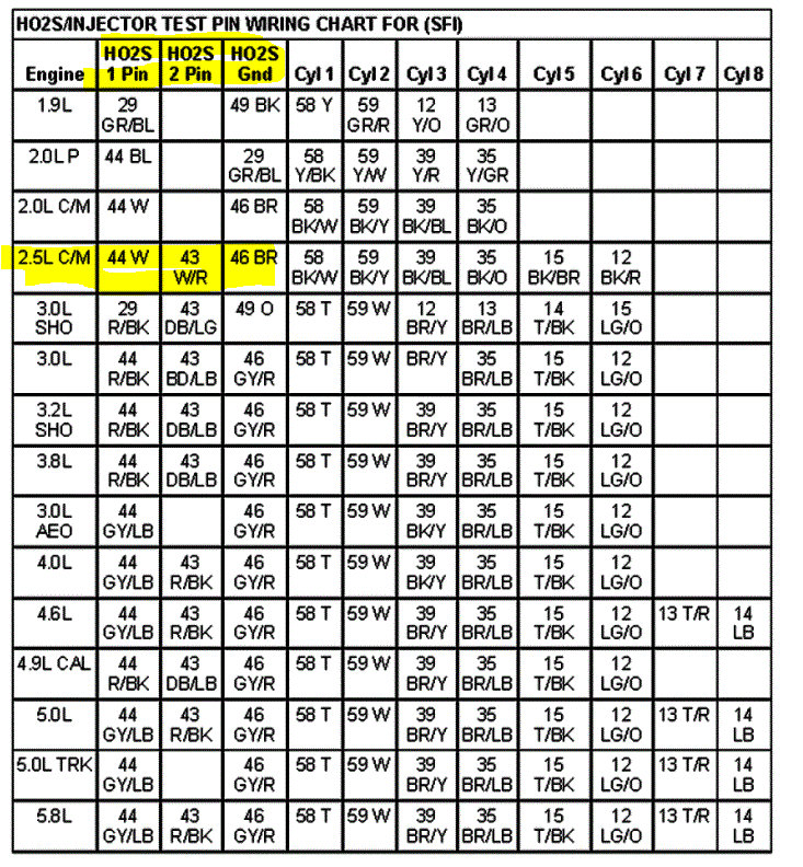

Hi Joe,
The new O2 sensors will have two white wires for the heater and a gray and a black wire. I'm confused as to which wire is the signal wire connecting to pin 43/44.
Sunday, February 6th, 2022 AT 8:41 PM
  • 110,192 POSTS
Take a look at the two pics below and let me know if they help.

I installed the 2 O2 sensors and the car ran much better. No black soot coming out of the exhaust. I'll take it for a road test soon.

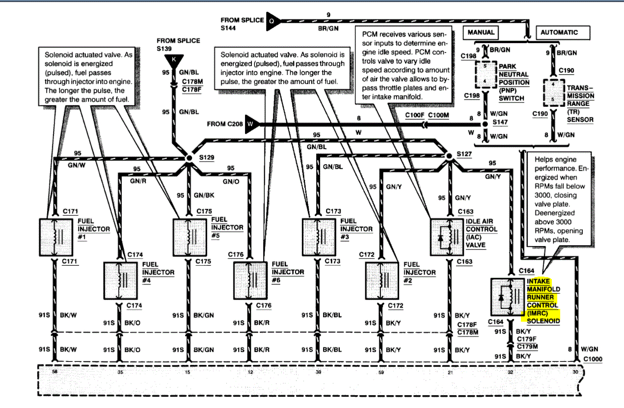

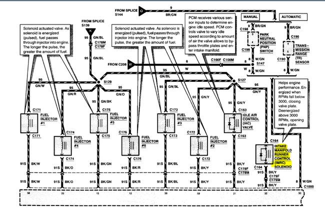

Hi Joe, the road test was so-so but first I'd like to know about the intake manifold runner control. The Alldata-diy shows two wires going to the valve. But the actual valve has 3 wires going to it. One wire comes from pin 32, the other comes from pin 57, the power. The third wire is a mystery. Also, I can't tell which wire goes where in the IMRC connector. Between the two outer wires the resistance is 60.2 ohms.
Putt
Sunday, February 13th, 2022 AT 3:49 PM
  • 110,192 POSTS
I dug through the OEM schematics, and they show the same. I did notice there is a splice that the runner wiring is part of.
Take a look at the pic below. Let me know your thoughts.
See pic below.
+1
Sunday, February 13th, 2022 AT 6:36 PM
QFONG
  • 92 POSTS
That's the same as the ALLDATA-DIY picture I have. I'll follow the wire back toward its other end. This car is a headache.

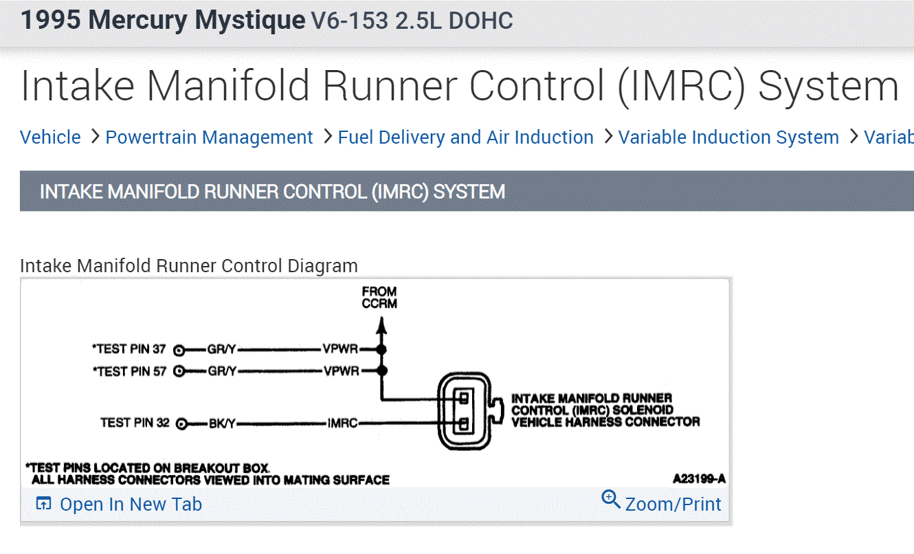

I attached the connector below for the IMRC. Although there are two pins at the connector, there are three wires involved. One comes from pin 32 one from pin 57. There is a third that goes to pin 37. It is spliced 57.
Take a look and let me know if that helps.
See pic below.

No luck with the IMRC, it seems to have 60 ohms resistance between the two outer wires and putting 12 V to it does nothing.

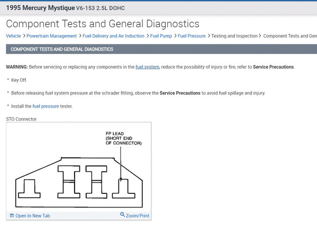

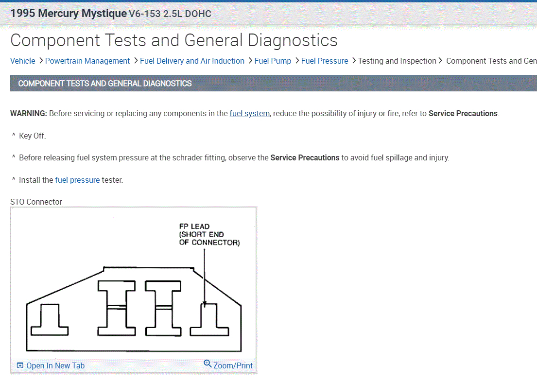

Meanwhile after the car runs for about 1/2 hour it starts blowing black smoke and will not idle. Fuel pressure regulator?
Thursday, February 17th, 2022 AT 3:24 PM
  • 110,192 POSTS

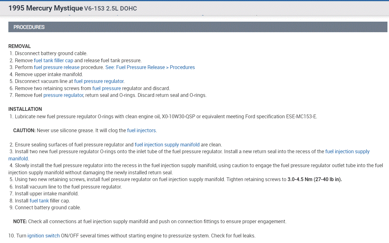

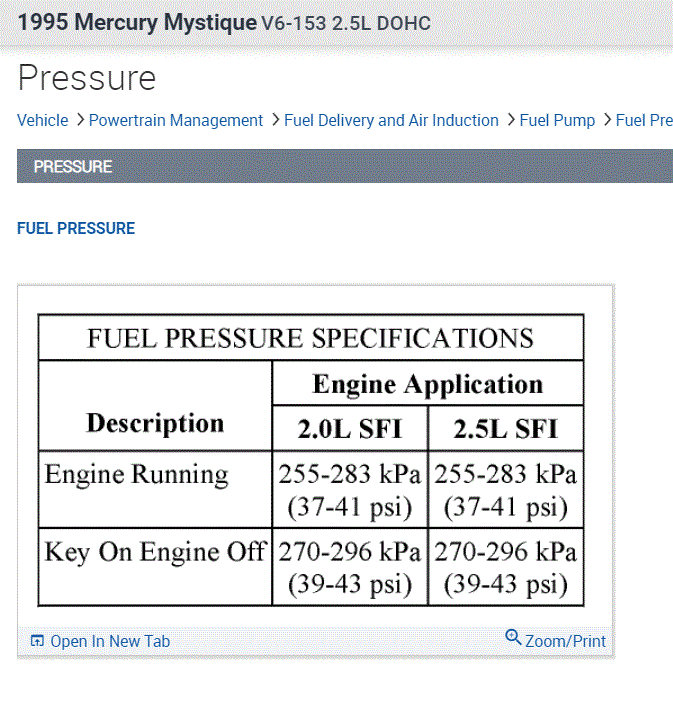

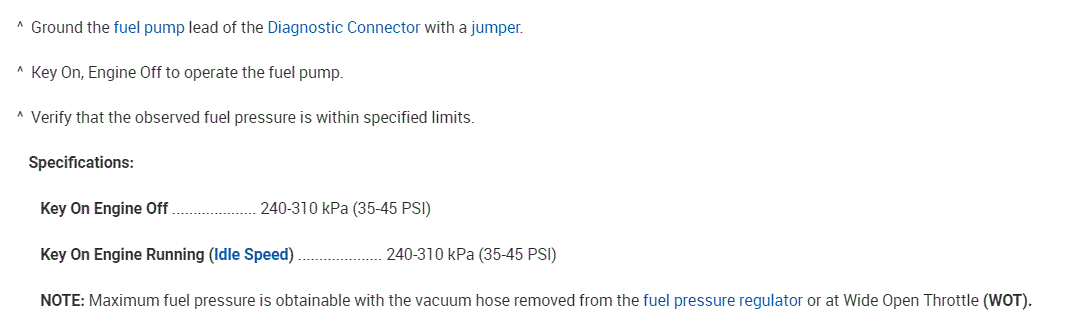

Black smoke indicates a rich fuel mixture. So, it is possible that the pressure regulator is bad.
I hope you are sitting down. I just ran through the procedure for replacing one (which is attached below), and the intake needs to be removed.
As a result, I would check fuel pressure first to confirm that it is the issue. Here is a link that explains in general how it's done:
Also, pic 2 shows the pressure specs, and pics 3 and 4 are the directions specific to this vehicle.
Let me know if this helps, and by no means am I tired of hearing from you. I'm a little jealous you are warm, but what can I say. lol 60 here today, rain, tonight, rain to sleet, then to snow. Temperature to drop to 20 degrees. Ugh!
