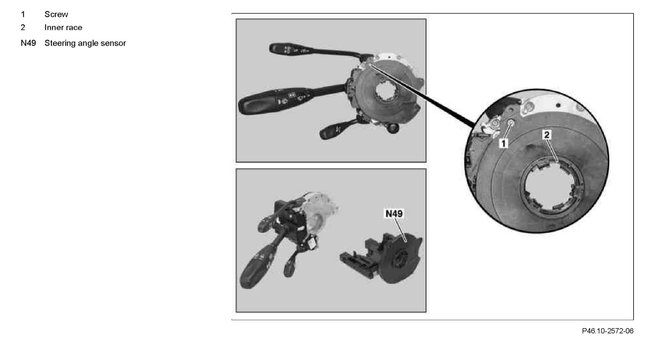

This car has the ABS light on when we start driving. after scanned we found following codes :
- D409 : the left front wheel rpm signal from the traction system is unavailable on the can bus(can timeout fault).
-9336 : Component N49 (steering angle sensor (SAS) is faulty.
-9334 : Component N49 (steering angle sensor (SAS) is faulty..
-9353 : Steering angle sensor (SAS) has overflow .
After cleared and re-start engine no warning lights on , but when we turn steering wheel to left or right warning triangle light come on( light number two in attached photo ). Then when we start driving the car ABS light come on also!
Your assistance please.
Thanks

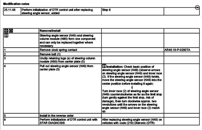

i would say that the sensor is giving incorrect vector angles to the BCM i feel that the sensor is faulty and it should be replaced. a steering angle calibration will have to be done with a new sensor fitted. i would think that a dealer will have to do this procedure.

could well be a side affect of the steering angle signal being incorrect, fix this first.
