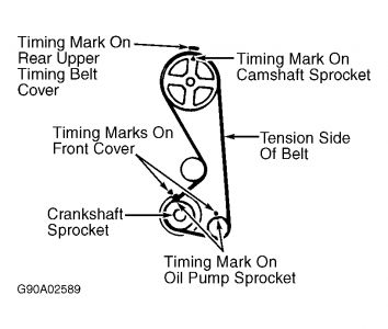

my timeing belt broke on this car and I had to replace every thing. Now all the marks line up but the car will not start it sonds like it is 180 out. How would I fix this? Do I need to take off the head and turn the crank so it does not bend the vaules again. This is a dual over head cam does this make a difrence? I have checked compression on the car all of them is 120-130 and it is geting gas. Now what?

Need to do a compression check on the cylinders to see whats going on first

Hi there,
If the engine timing marks are aligned as per pic, check compressions, and check spark, injection pulse and fuel pressure, start here.
https://www.2carpros.com/forum/automotive_pictures/61395_mitsi_1.jpg
