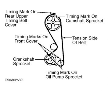

How do I replace timing belt on a 1994 mitsubishi eclips
Tuesday, May 26th, 2020 AT 8:31 PM (Merged)
  • 110,192 POSTS
Replacing the belt is an involved process. IF you only need timing mark information, refer to the DIY section on our homepage. If you need detailed instructions from start to finish, I recommend getting a good repair manual. For me to try to explaine it via the Internet allows too much room for error.

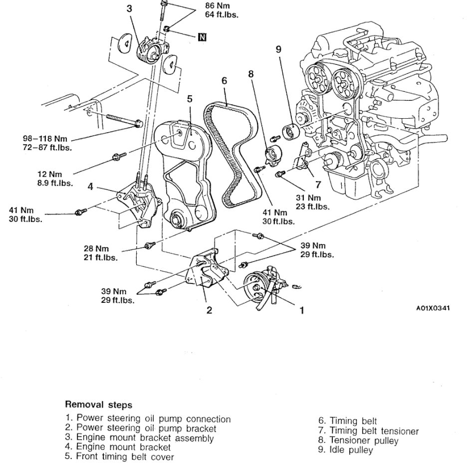

How to remove the timing belt cover?

KEN L
  • MASTER CERTIFIED MECHANIC
  • 55,260 POSTS
You should disconnect the battery and then raise the car up to do the job.
Then you will need to remove the harmonic balancer.
https://www.2carpros.com/articles/how-a-harmonic-balancer-works
Here is a diagram for the rest (below)
-1
