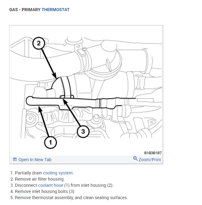

Starting car today it made a popping noise. On second attempt it started but runs rough and makes a hissing noise like air is escaping from somewhere. There's two lightning bolts flashing from my dash and the car seems to be in limp mode. Recently replaced coils and all fuel injectors. Because I was getting a number one cylinder misfire. It's showing 3 codes after this episode today. P0300,
P0171, and P0128. The last code refers to a thermostat issue.
Which I removed 6 months ago.
Friday, July 23rd, 2021 AT 11:11 AM
18 Replies
Good afternoon,

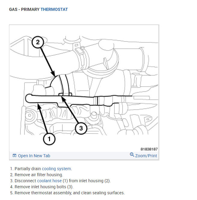

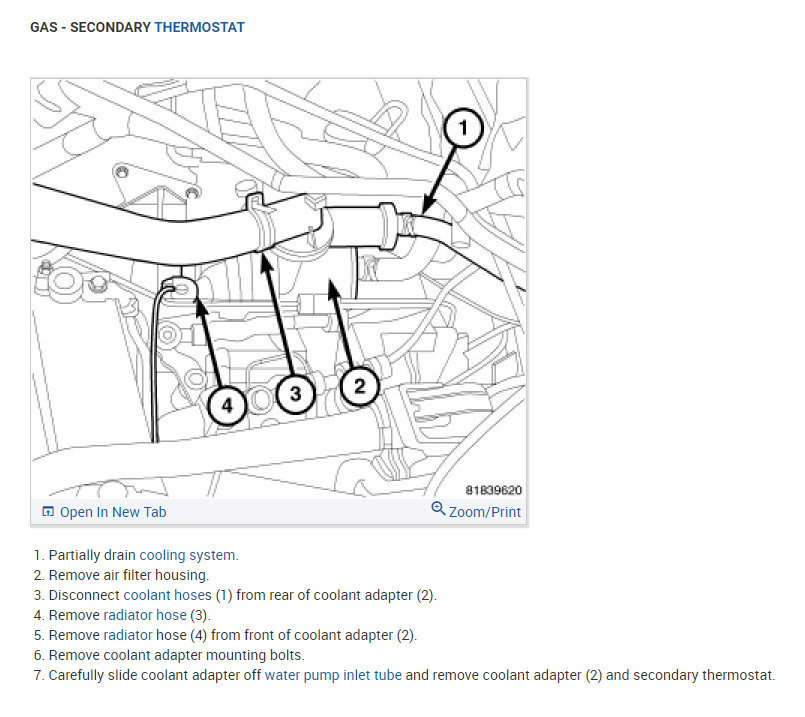

First, if you removed the thermostat and drove for 6 months, there is a very good chance you have damaged the motor. The thermostat must be there for circulation to work correctly. Without it in the motor, only a portion of the block is getting the correct cooling.
This system has 2 thermostats and they both must be there and functioning.
https://www.2carpros.com/articles/how-an-engine-thermostat-works
I would start with a compression test to see if the motor has any internal issues. Pay attention to the number one cylinder.
The 171 is part of the misfire issue. Once that is repaired, that code will go away.

Last year I completely disassembled the thermostat housing and only found one thermostat. So I'm not sure about that but your the professional so if you say so. But what would any of that have to do with a cylinder misfire? And what's the compression ratio per cylinder so I can check it?

If the block gets too hot it can cause cylinder damage.
Compression should be 140-160 in each cylinder. You can rent a tester at a parts store.

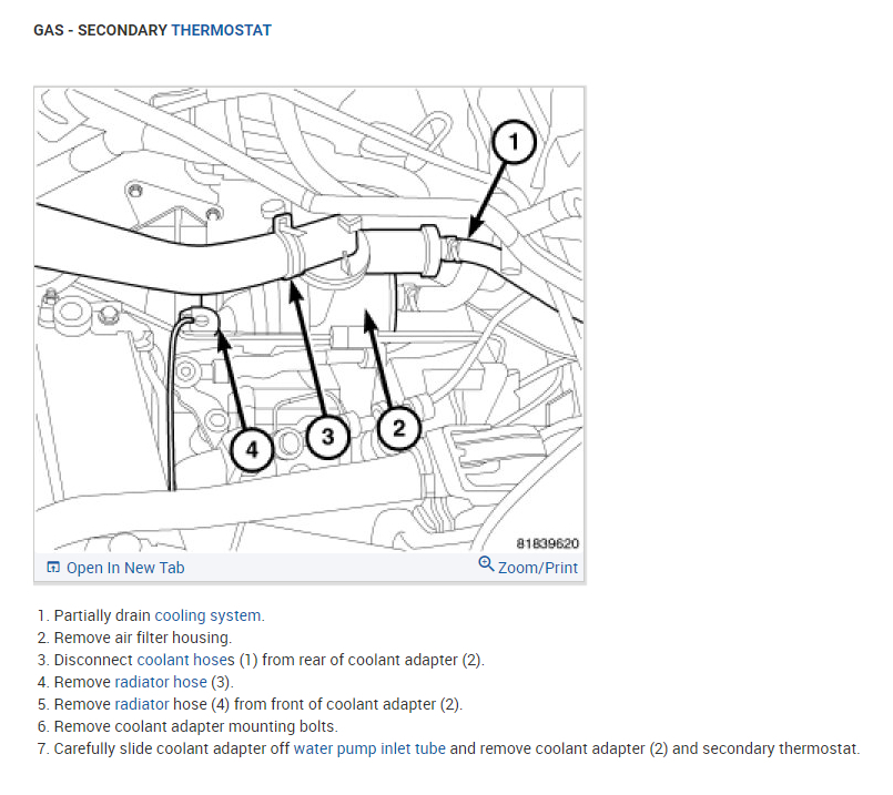

I already have one. All cylinders are fine with no leak down apparently. I will take the thermostat housing back off and replace both therms. If I can find the other one. Where is the second located? In the link it appears to be around power steering pump I think.
Friday, July 23rd, 2021 AT 2:28 PM
What was the compression?
I would change the plugs while you have them out.
https://www.2carpros.com/articles/how-to-change-spark-plugs
I attached the location in a previous post.
Friday, July 23rd, 2021 AT 3:43 PM
JC-842
  • 181 POSTS
Thank you. I did not see a second thermostat. But you should know so I'll figure it out. Do you know anything about the intake runner and if it gets stuck could it cause it to sound like air being expelled and loss of power?

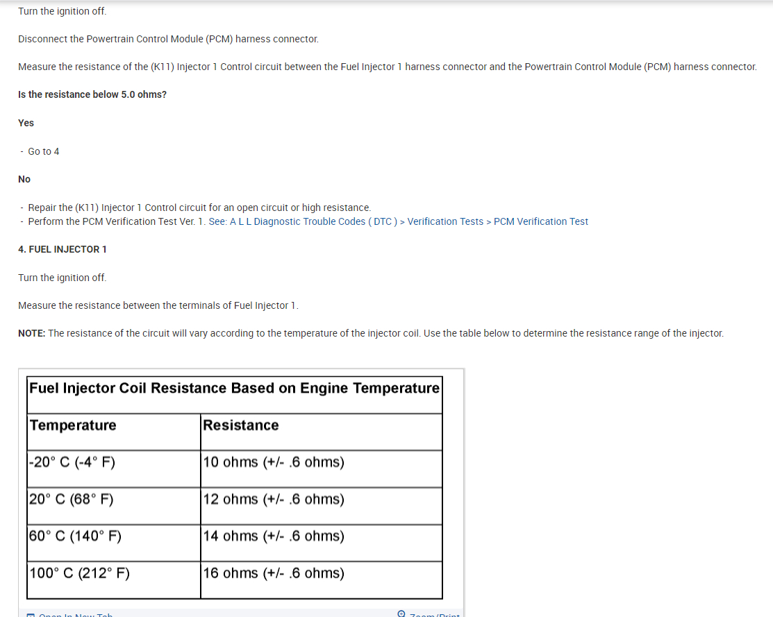

You are never not going to believe this Roy but I got 15 codes this morning. I installed the battery and hooked up my tool and I was shocked at what I saw. This has got to be a glitch. Do you want all the codes? I think the problem is in my throttle body. And that code did not show up.

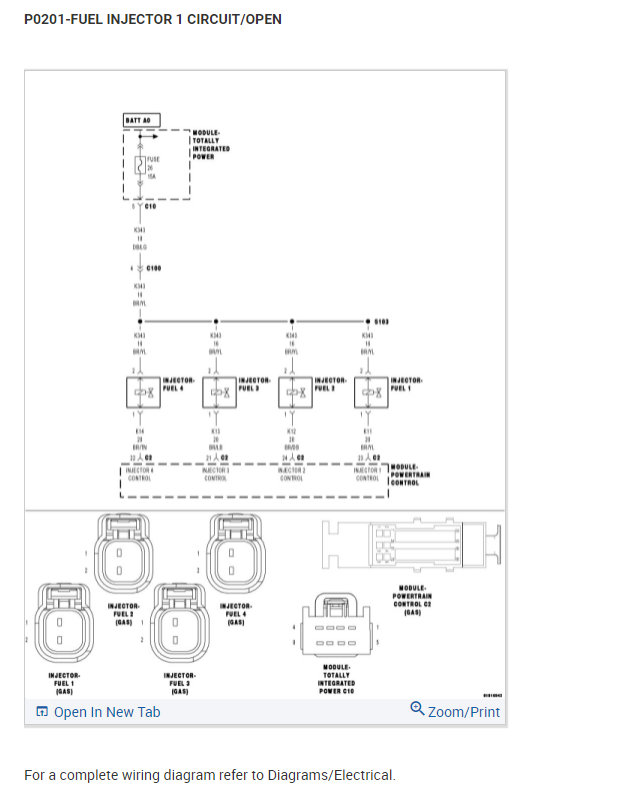

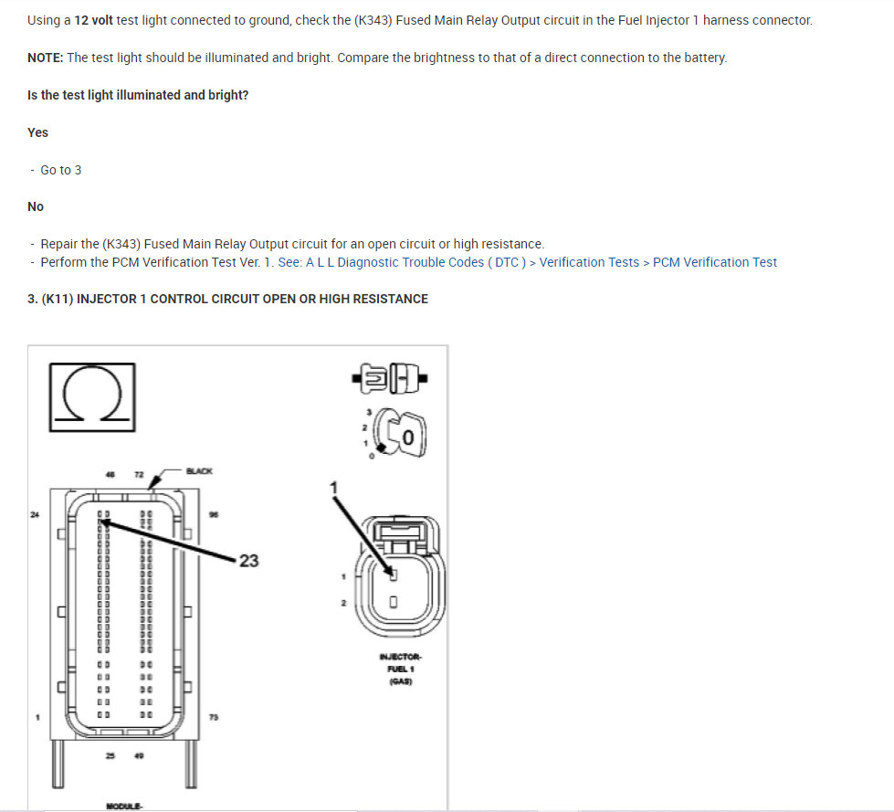

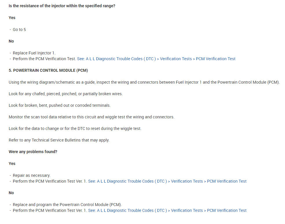

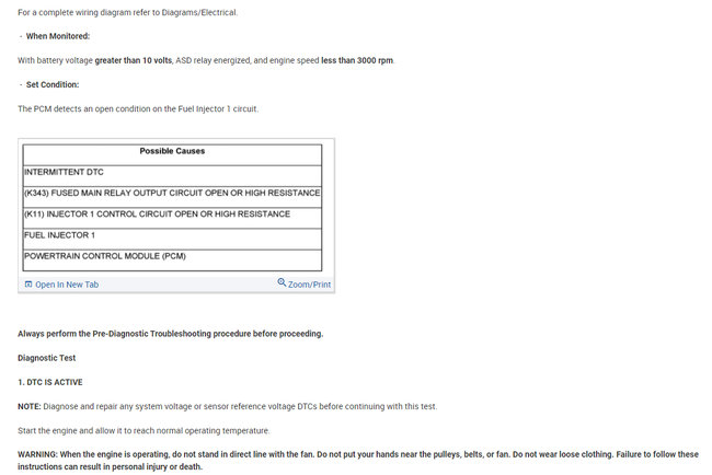

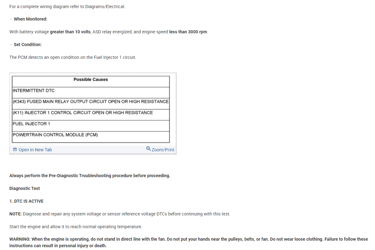

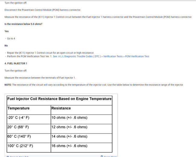

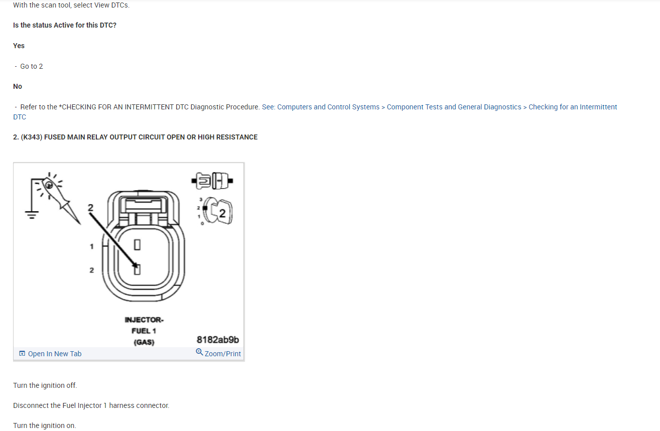

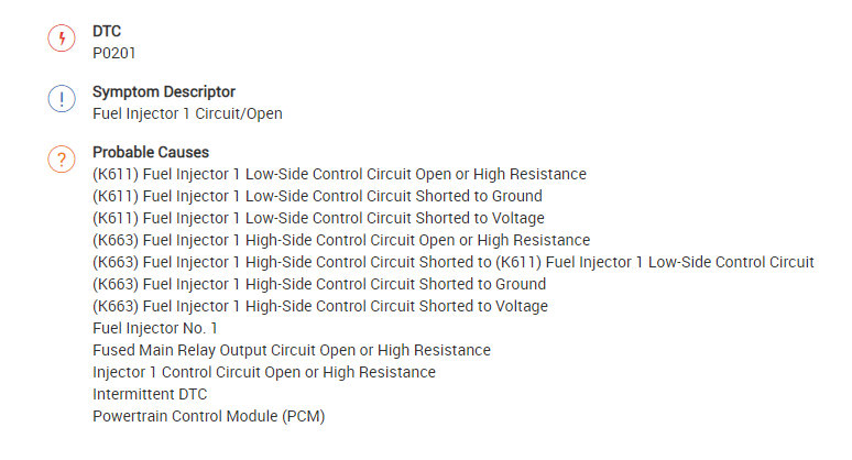

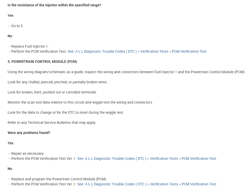

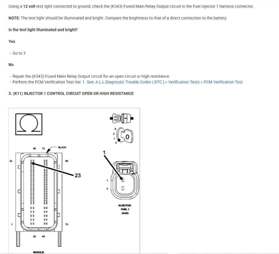

P2004/U0101/ po123/ PO 463/UO141/PO113/P2017/PO480/ PO481/P2311/UO402/PO203/PO202/PO201/U110C
Saturday, July 24th, 2021 AT 12:37 PM
Okay, the key here is the 200 codes for the injectors. Once they are repaired, the other codes most likely will go inactive for the engine controls.
I attached the flow chart for the injectors. Follow the chart and keep me updated on the results.
https://www.2carpros.com/articles/how-to-test-a-fuel-injector
