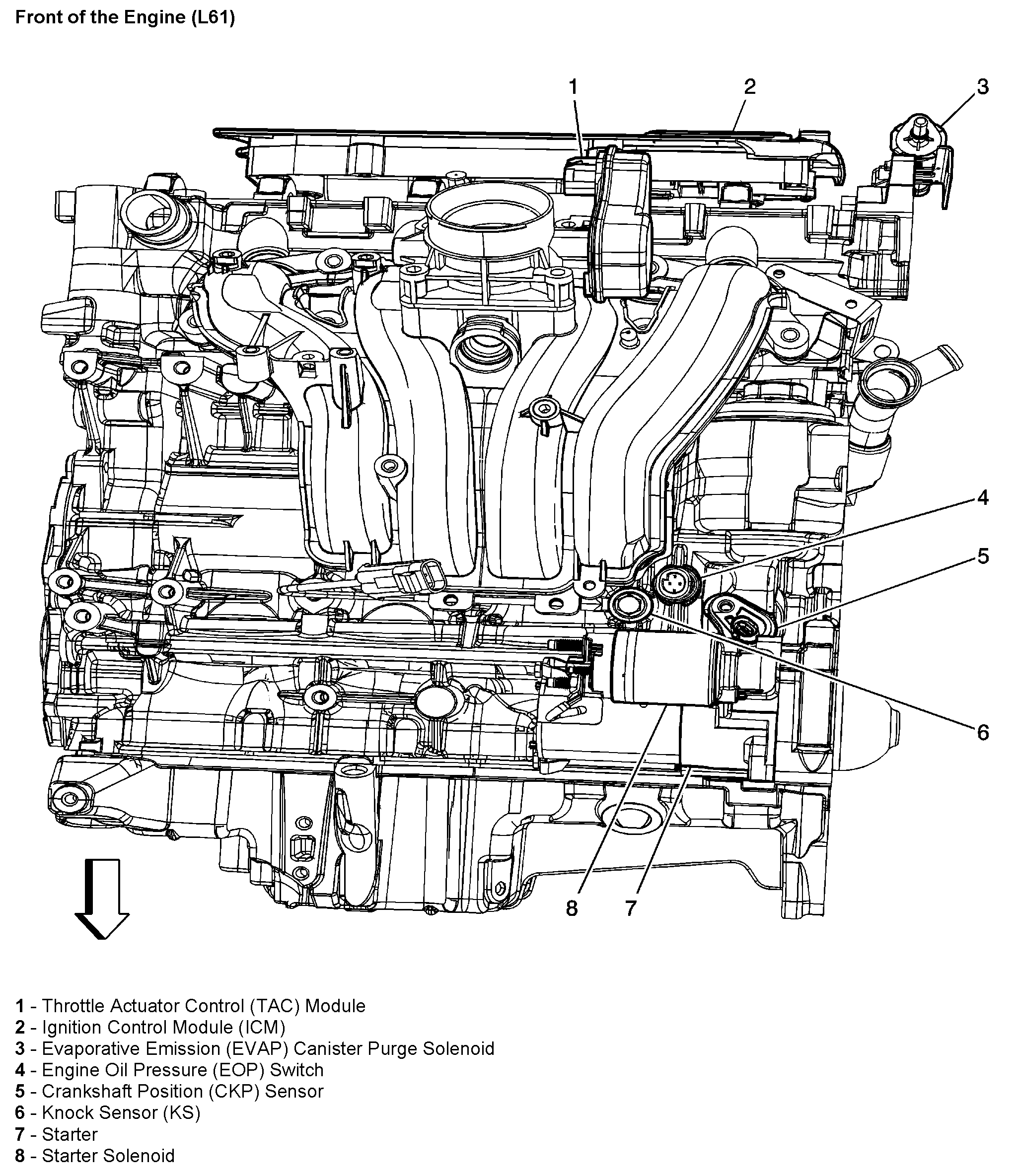

Here are the directions specific to your vehicle for testing compression. In the directions, it says to disconnect the ignition module. I attached a picture of its location.

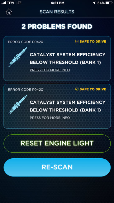

The catalyst converter code is P0240.
Sunday, May 12th, 2019 AT 8:22 PM
CSTIGLET
  • 7 POSTS
Sorry it is P0420.

That code indicates the catalytic converter is operating below threshold. With that code, 99% of the time, the converter needs replaced. If it is causing issues with back pressure, it may be the source of the problem. However, I would strongly recommend checking for head gasket issues.
If you get the chance to check for head gasket issues, let me know what is found. Also, let me know what compression is found. With that, I will be better able to direct you. However, the converter will most likely need replaced.

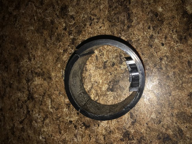

Hey so I did the compression test. It was the head gasket. I am replacing the thermostat and the thermostat retainer broke. I have looked everywhere for it and it is a discontinued part so can I run the car without it? Where can I find a replacement for it?
Saturday, May 25th, 2019 AT 7:02 PM
  • 110,194 POSTS
That's not good. Have you tried a salvage yard? Also, are there any u-pull it salvage yards near you? There are several near me and I know there are many 2.2L GM engines. I'm sure if there is a place where they allow you to remove the parts from the salvage vehicles, you could find one.

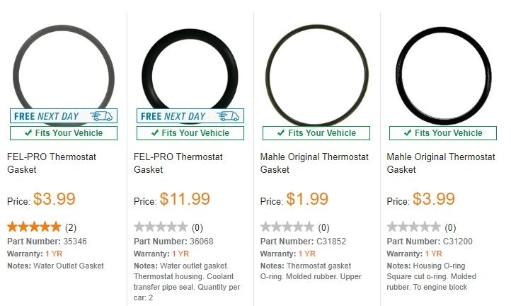

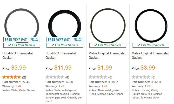

I am going to try and look tomorrow. I have been to 7 different places trying to locate the thermostat housing o-ring. Nobody has them!
Saturday, May 25th, 2019 AT 8:39 PM
  • 110,194 POSTS
Wow! That was such a popular engine. I just went to a nationally recognized parts store web page and looked up the o-ring. I'm not to use company names here, but the initials of the store are A Z. Take a look at the attached picture. The picture is for a 2005 cobalt 2.2L.
Do any of those look like what was removed?
