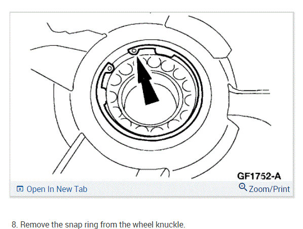

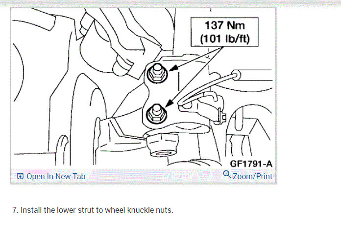

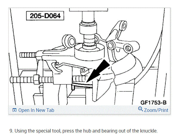

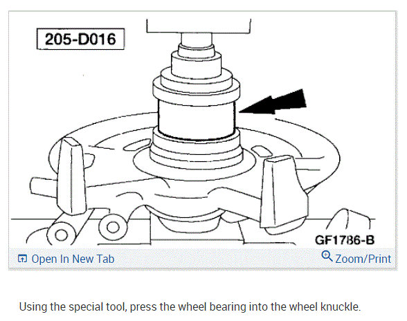

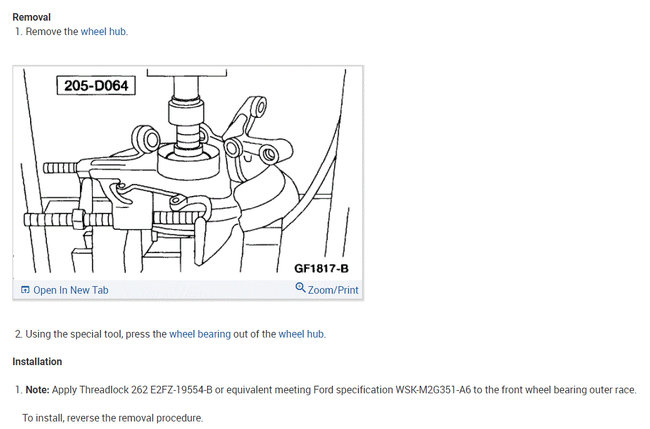

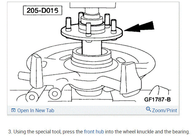

Getting a thumping sound/grinding sound in my front end while I go straight but it will go away when I turn left but as soon as I come out of the turn starts right back again.
Sep 5, 2021 at 5:34 PM
TIM JOLLY JR.
  • 11 POSTS
Getting a thumping sound / grinding sound in my front end while I go straight but it will go away when I turn left but as soon as I come out of the tourn starts right back again
  • CAR REPAIR CONTRIBUTOR
  • 110,190 POSTS

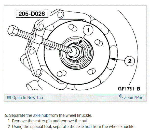

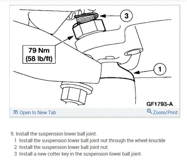

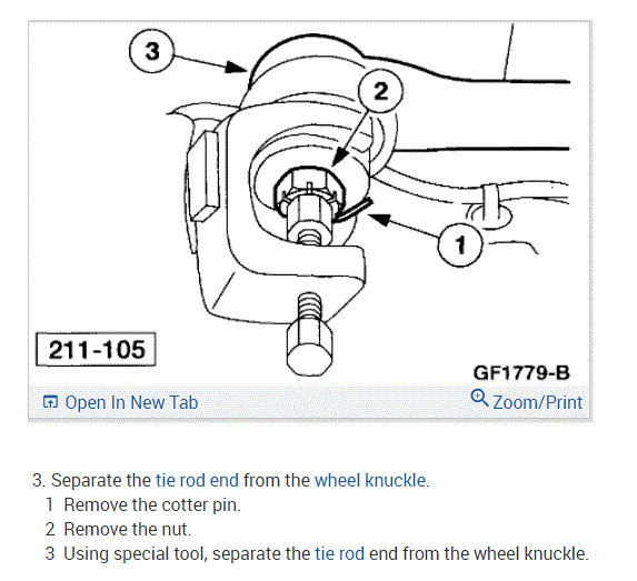

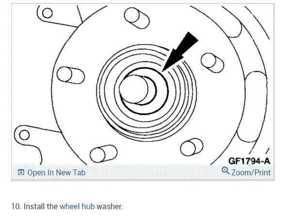

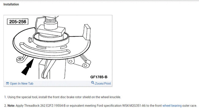

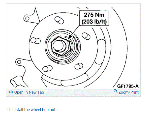

That sounds like a wheel bearing. When you turn left, the vehicle's weight distribution shifts to the right. Thus, it removes weight from the left front wheel bearing. Does it get louder if you turn right? Also, does the sound seem to come from the left front?
Sep 5, 2021 at 6:47 PM
TIM JOLLY JR.
  • 11 POSTS
It's hard to say where the noise is coming from X I swear sounds like it's coming from the middle of the front but other times it sounds like it's coming from the driver's side of the noise stays the same when I turn right there's no difference and the noise gets louder the faster I go.
Sep 5, 2021 at 7:30 PM
  • 110,190 POSTS

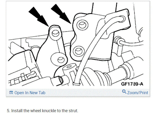

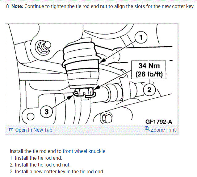

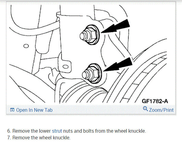

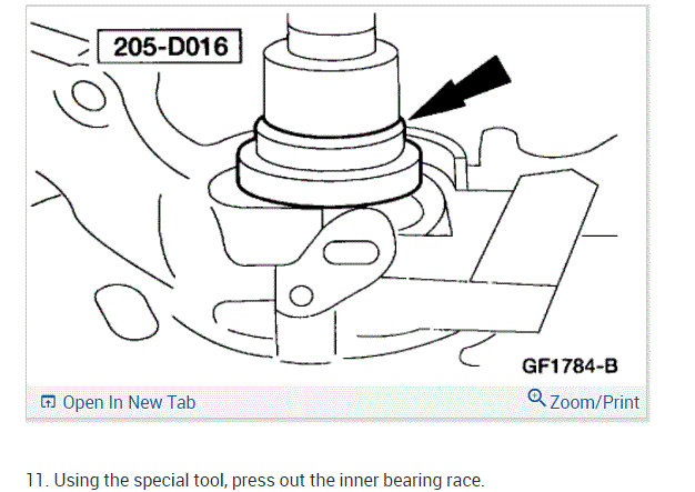

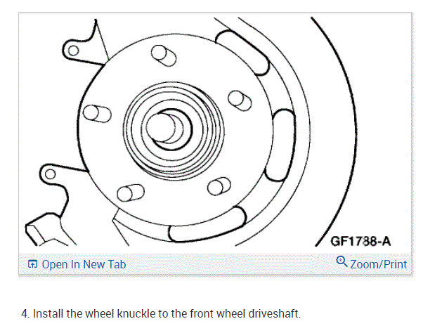

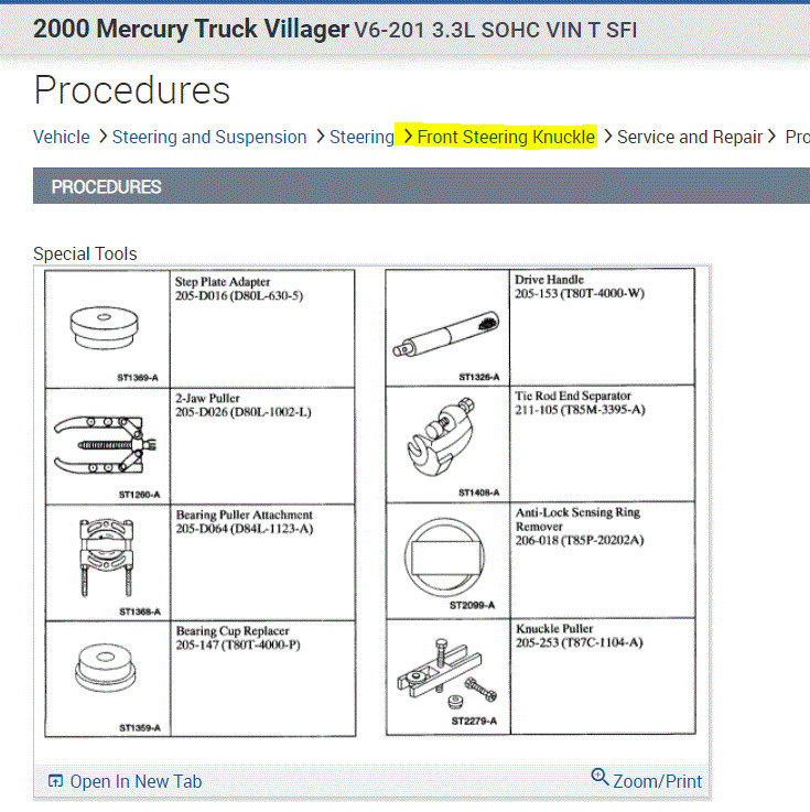

Tim,

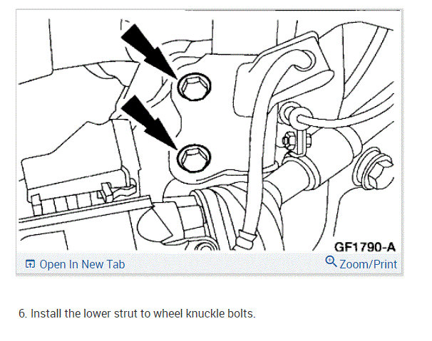

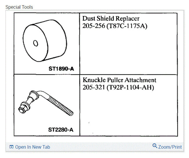

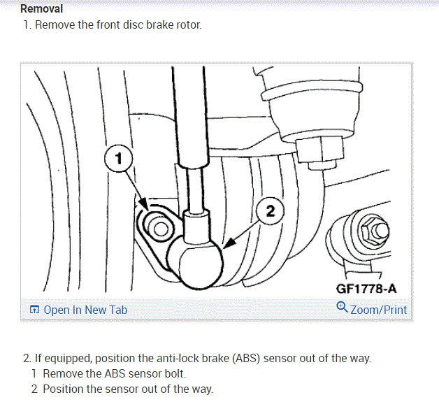

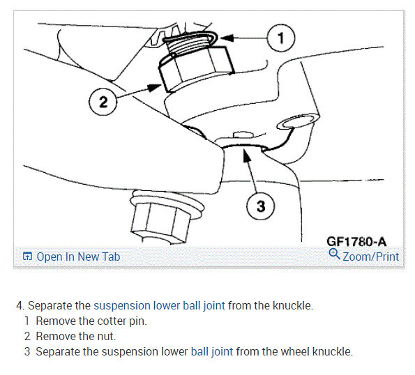

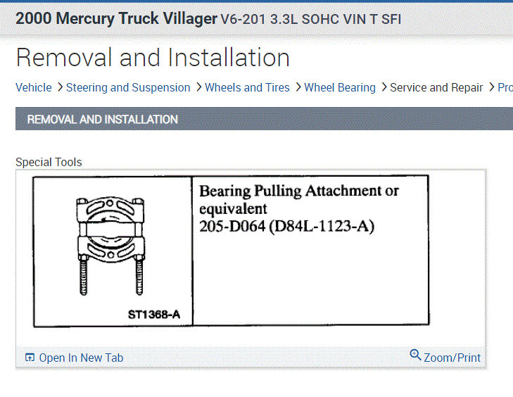

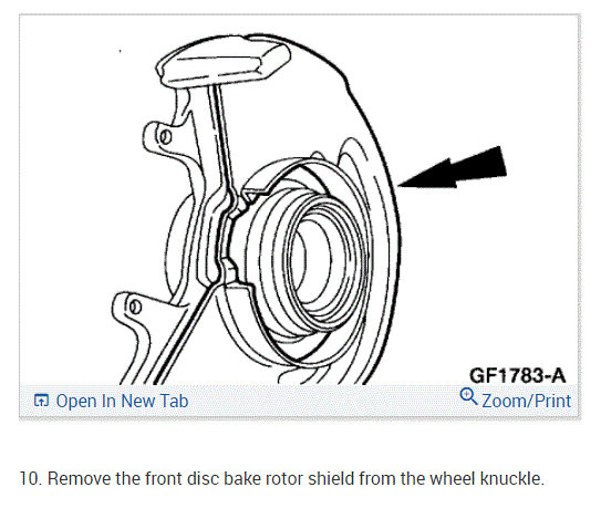

Chances are it is the left front wheel bearing. Safely lift the left rear wheel from the ground and see if there is any play in the wheel (left/right, up/down, in/out). Even if it feels tight, it could be bad. Hopefully, this will test will identify the issue for certain.
As far as replacing the bearing, this one will require you to fully remove the steering knuckle. Also, you will need a press and a bearing puller.
If you look at the first two pics below, they show the directions for the replacement once the knuckle is removed. The remaining pics are the directions for removing the steering knuckle. I noticed the directions for knuckle removal discuss the bearing replacement as well.
