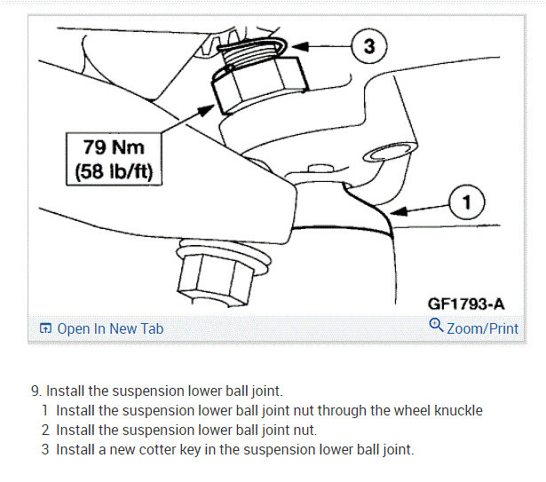

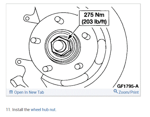

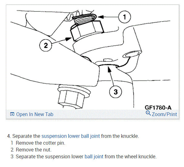

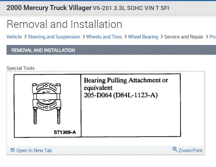

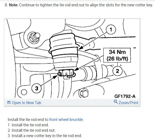

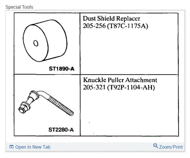

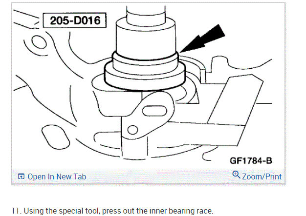

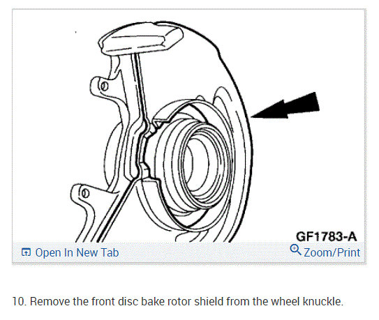

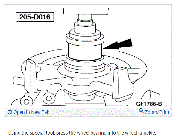

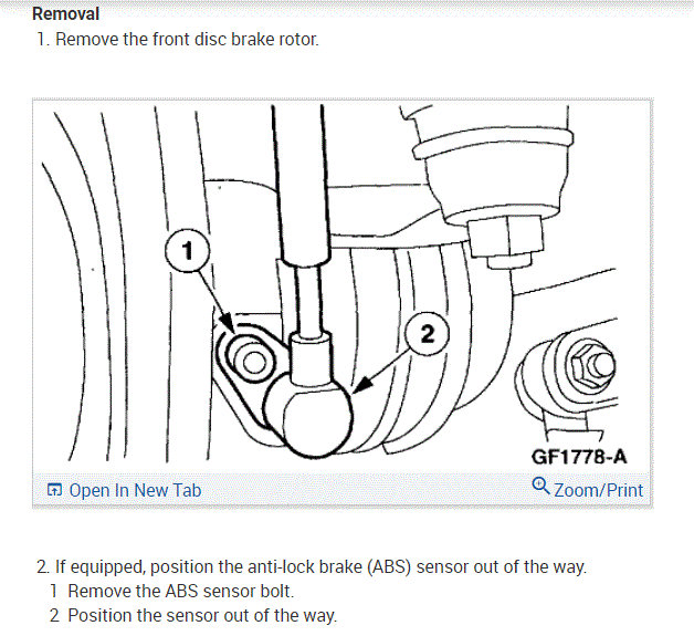

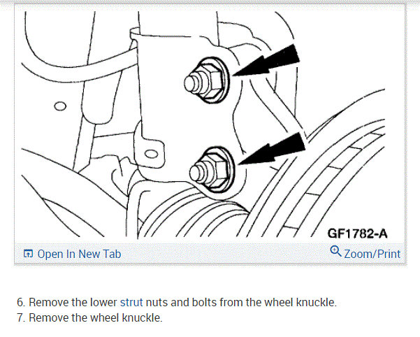

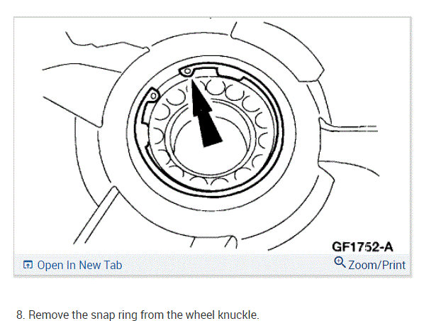

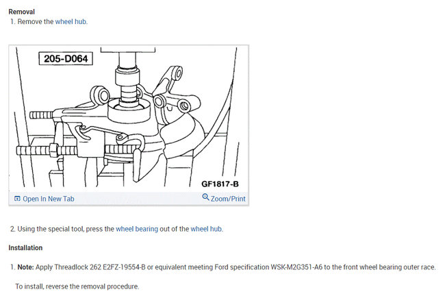

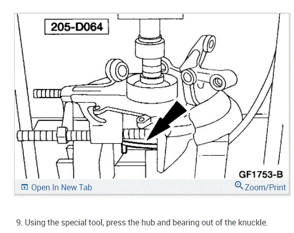

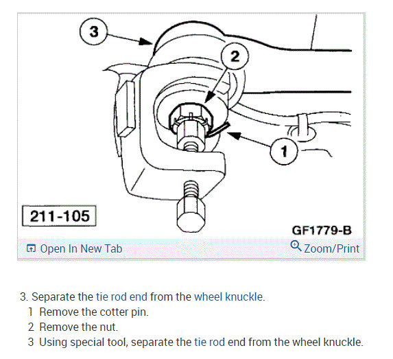

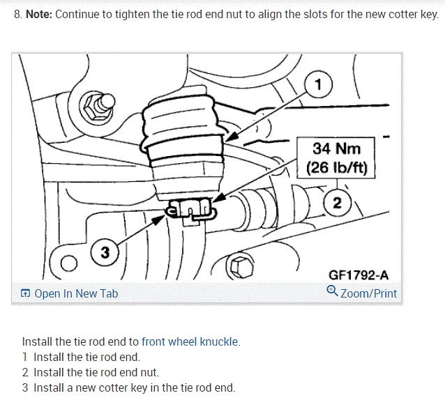

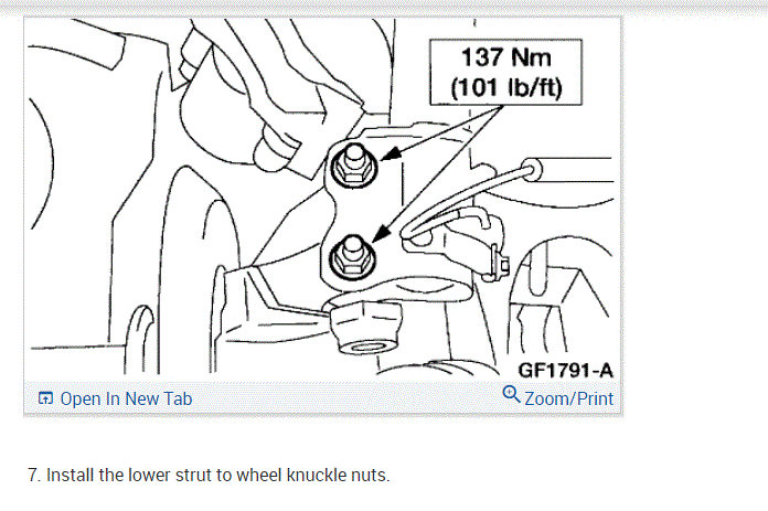

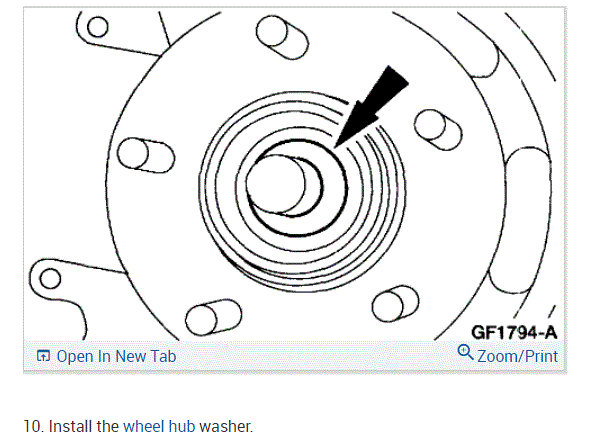

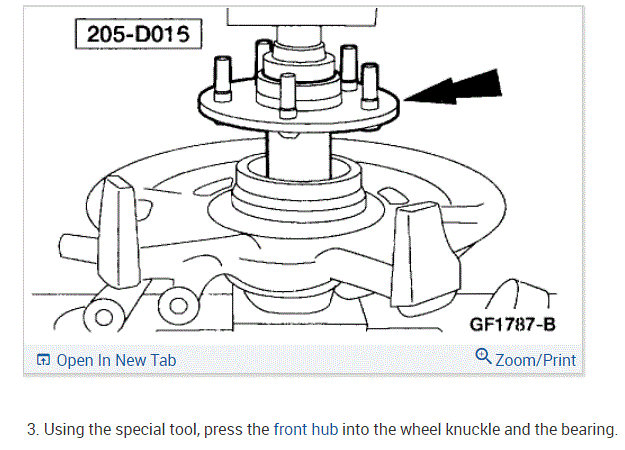

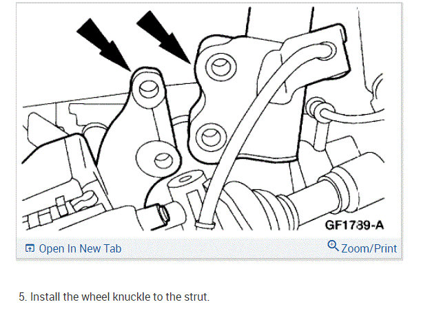

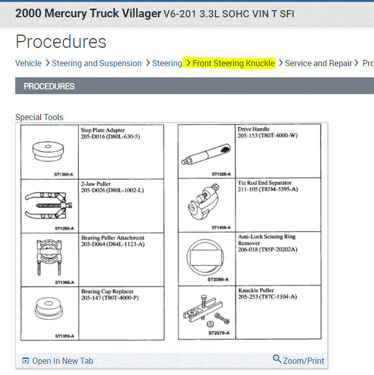

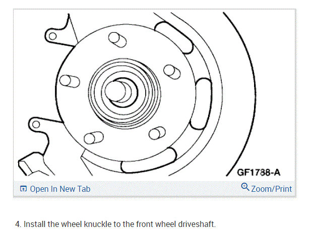

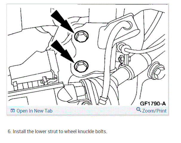

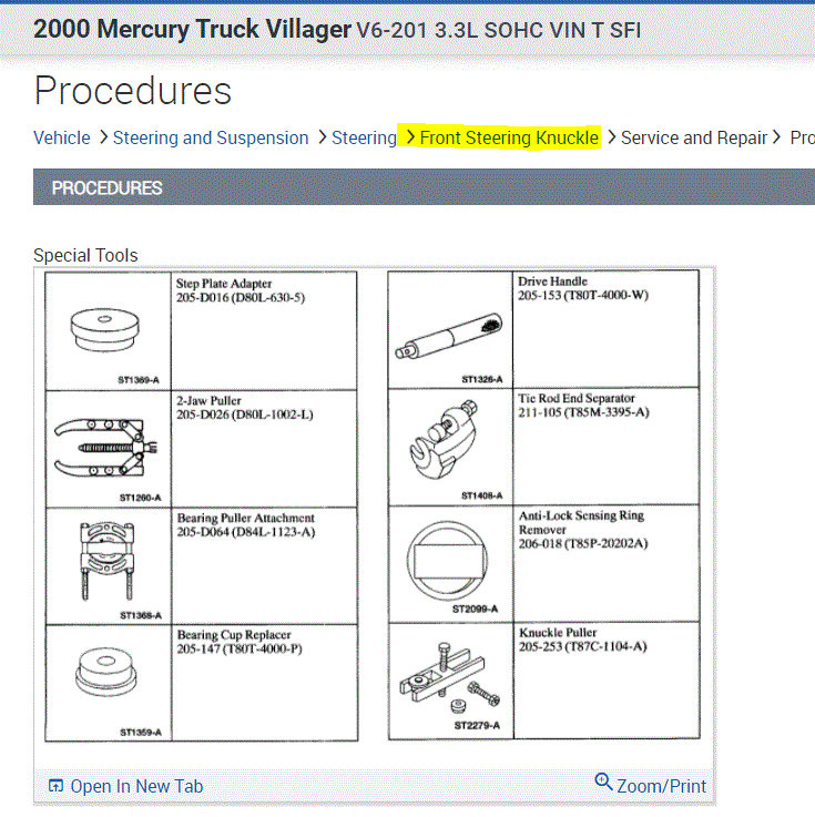

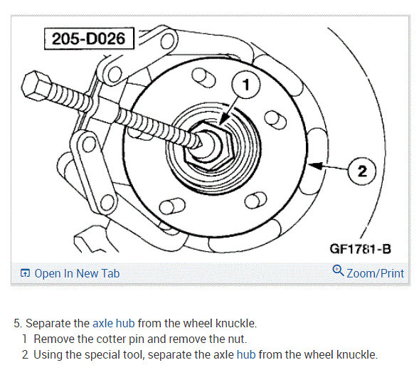

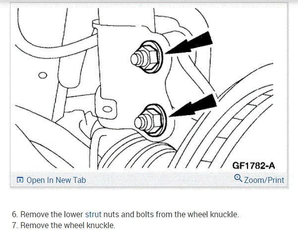

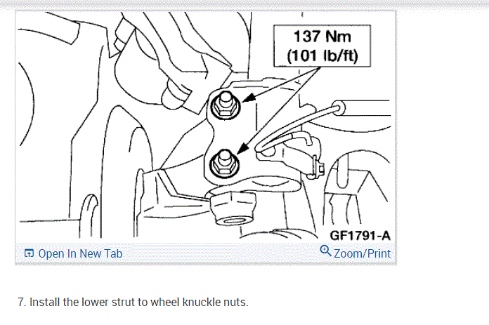

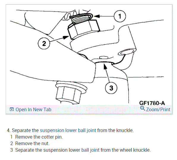

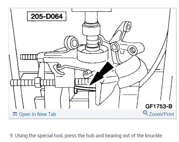

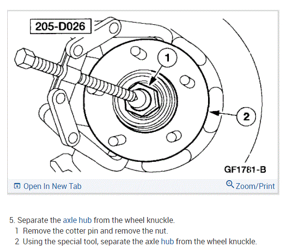

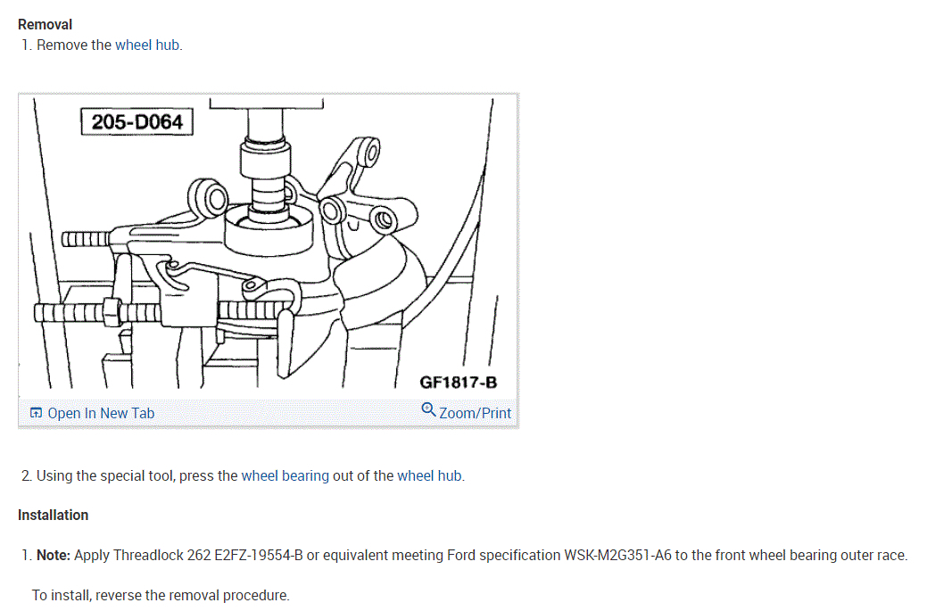

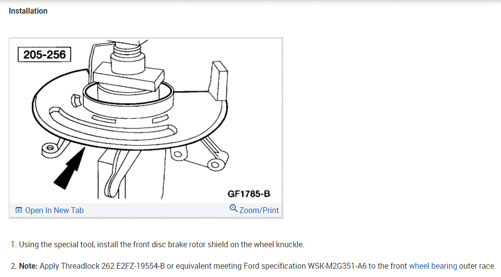

Tim,
Chances are it is the left front wheel bearing. Safely lift the left rear wheel from the ground and see if there is any play in the wheel (left/right, up/down, in/out). Even if it feels tight, it could be bad. Hopefully, this will test will identify the issue for certain.
As far as replacing the bearing, this one will require you to fully remove the steering knuckle. Also, you will need a press and a bearing puller.
If you look at the first two pics below, they show the directions for the replacement once the knuckle is removed. The remaining pics are the directions for removing the steering knuckle. I noticed the directions for knuckle removal discuss the bearing replacement as well.
