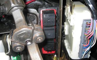

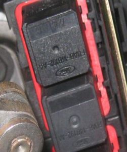

I do have another semi-related question for you. Under there, I found a bank of relays, that I can't find an explanation for. There are 4 slots, with 3 relays occupying 3 outta 4 slots, and it's got a cover upside down, but no idea what they are for.
Sometimes when the car doesn't start, I swear coming from there, is this rapid clicking sound. I get the feeling one of them isn't so swift, but I can't tell what they are for, as I disconnected them, and could still drive the car fine.

Can you include a pic of the relay's with the cover off but in the pic and tell me where this relay box is located and I will look to find what they do.

Had to shrink it down a lot, but this is a general idea. That metal thing is the steering knuckle.

So these should be Door lock relay, Door unlock relay and flasher relay. Nothing to do with the running of the car. As for the bolts that broke I would anti seaze them unless there are in a water jacked area then I would use thread sealer.
