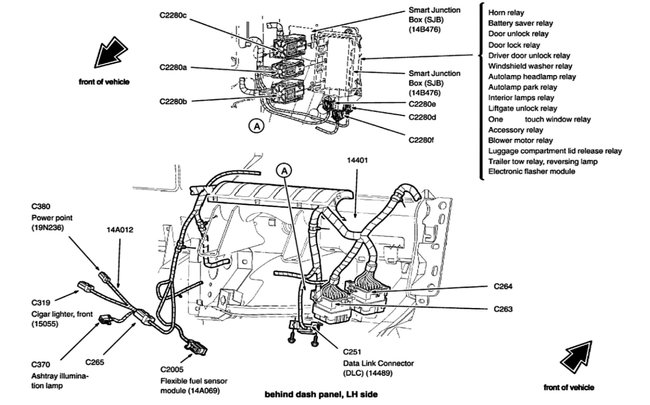

the horn and cruise control stopped working and the fuses and horn are good. what could be the problem.
Sep 7, 2009 at 12:57 PM
BRAVESTAR1
  • 234 POSTS
There is a smart junction box that sounds like it not working here is the location so you can replace it. Check out the diagrams (Below). Please let us know what happens.

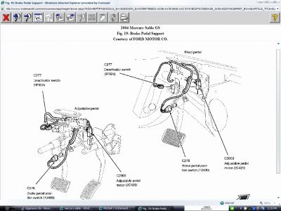

We have a 2004 mercury sable 3.0 engine, 69,000 miles and automatic. our cruise control will not work and we have no brakes lights and back up lights are on constantly. There is no smells, leaks or noises. Any suggestions.
Nov 16, 2020 at 12:21 AM (Merged)
MERLIN2021
  • 17,250 POSTS
Try these switches, 1 is the brake position, and the other is the cruise deactivator, for the revrse lights check the neutral switch on the top of the tranny
