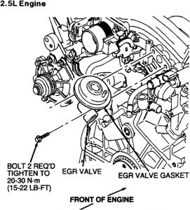

The EGR system is a Differential Pressure Feedback EGR (DPFE) system, controlled by the Powertrain Control Module (PCM) and composed of the following components: DPFE sensor (also referred to as the backpressure transducer), EGR Vacuum Regulator (EVR) solenoid, EGR valve, and assorted hoses.
The EGR (Exhaust Gas Recirculation) valve is pictured below.
https://www.2carpros.com/forum/automotive_pictures/261618_0900c152802531de_1.jpg

Thanks, for the diagram, I'll give that a shot as well.
