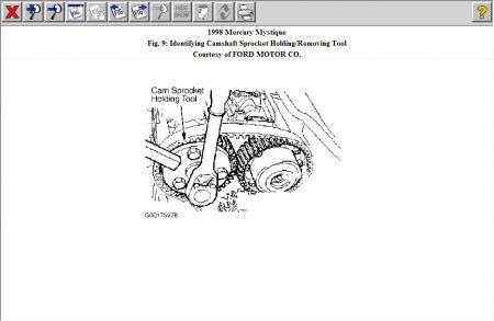

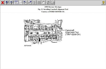

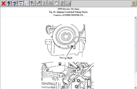

Need to know how to set the camshaft pulleys have no markings. Putting on a new timing belt need to knoe how to line up.

You need a special tool to align the camshafts see below
