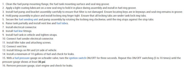

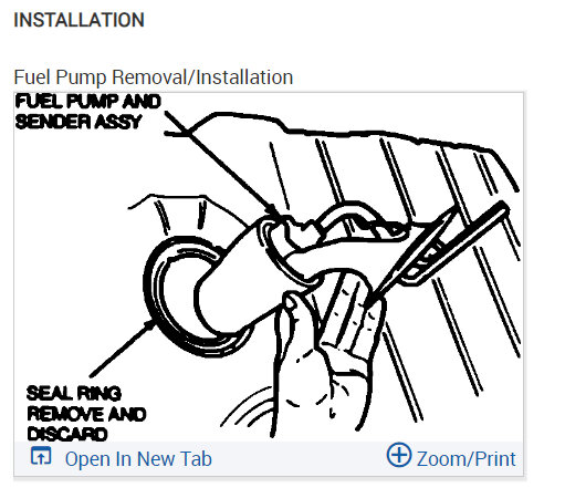

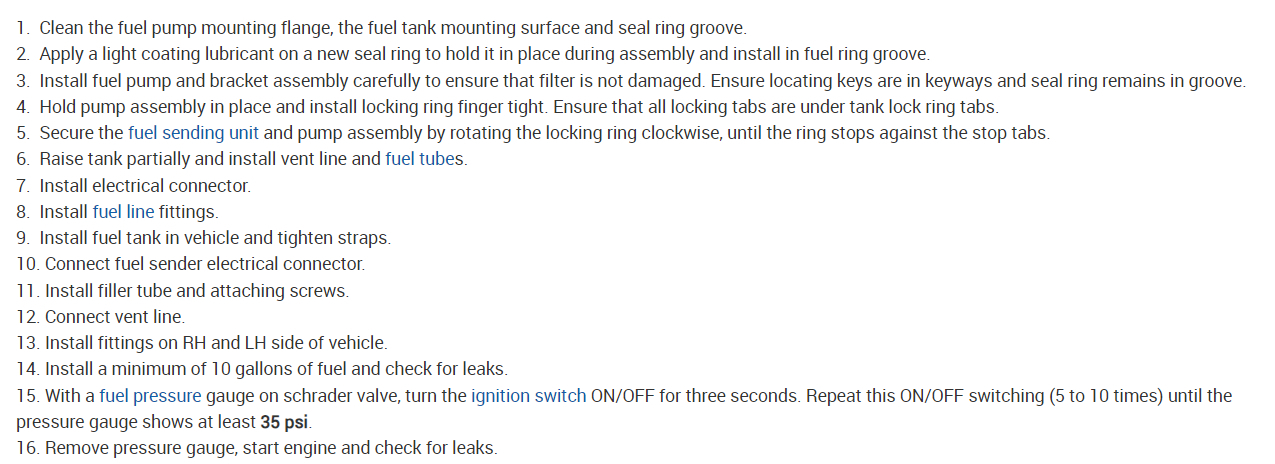

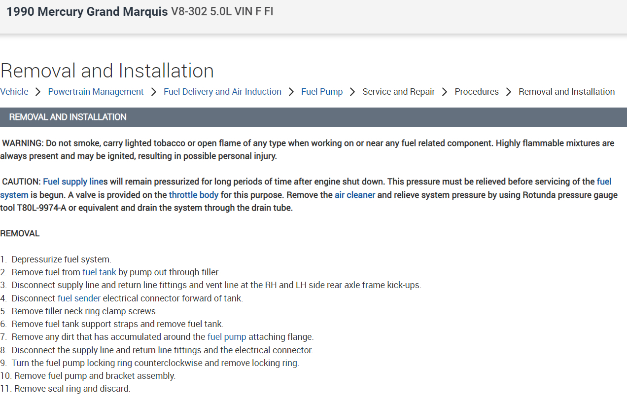

It sounds like the fuel pump has gone out but to be sure you can use starting fluid to see if it will run for a short time, and if so, here is how to change the fuel pump out.
This guide can help as well:
https://www.2carpros.com/articles/car-not-running-advanced
