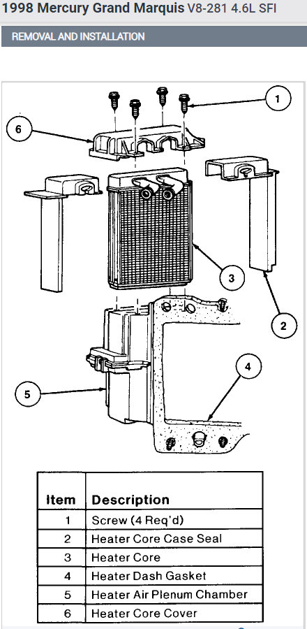

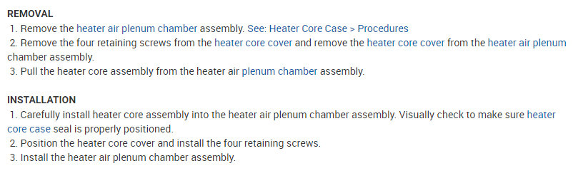

Need diagram and instructions for removal and install of heater core.

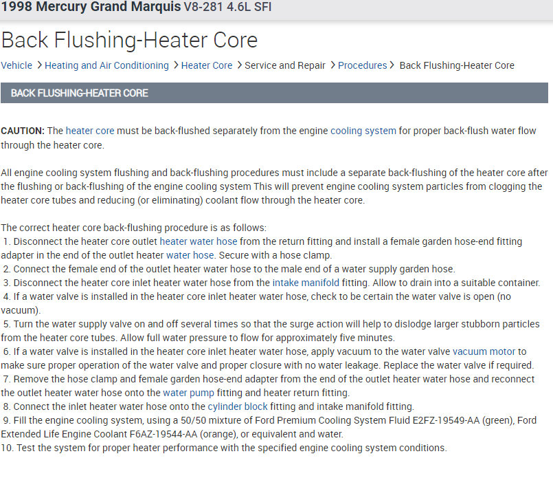

Here are couple of helpful articles on heater core replacement:
https://www.2carpros.com/articles/replace-heater-core
https://www.2carpros.com/articles/replace-heater-hoses
I have also attached the replacement instructions.
Let me know if you have any questions.
