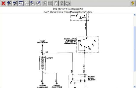

The car won't start but has power. Tried to jump it anyway that didn't work. It doesn't turn over when you turn the key. It just makes a clicking noise. I don't know what the problem is. Anybody have a suggestion?

Make sure your battery has 12.4 volts or better and cleaned/tight connection-
Probable causes: Ignition switch/Manual lever position switch at transmission and starter itself. Hold key at crank position and look for power at the starter red and light blue wire-power there replace starter-No power backtrack to the switch at tranny.
