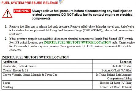

How would I go about depressurizing my fuel line, to change a fuel filter?

Disconnect the inertia switch, remove fuel cap and crank engine 15 secs
