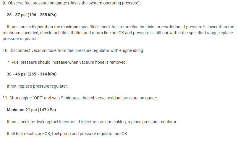

I have this truck b2600 it starts but won't stay on I changed fuel filter and check the fuel pump its still good i've check every thing and I can't seem to find the problem what can't it be.
Monday, February 18th, 2008 AT 4:23 PM
SQM
  • 6,383 POSTS

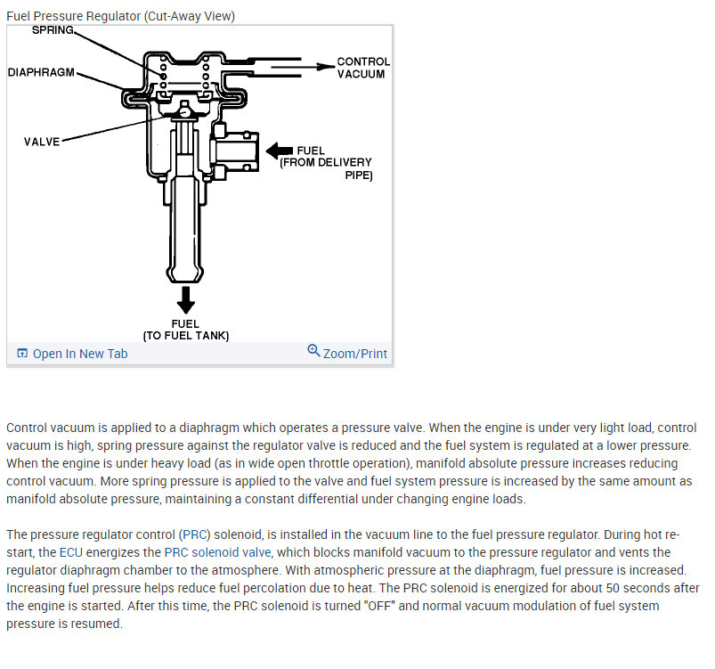

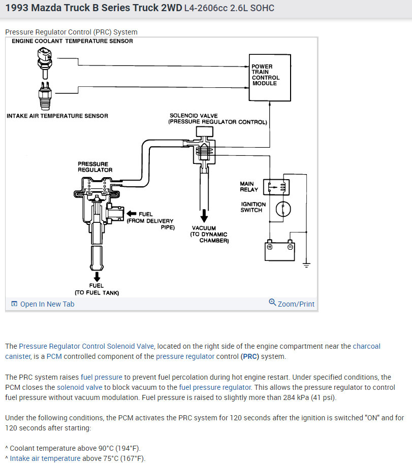

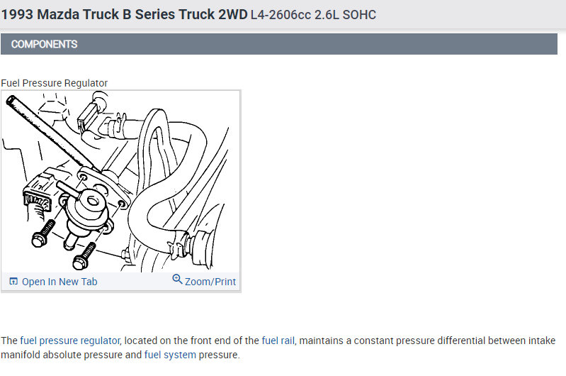

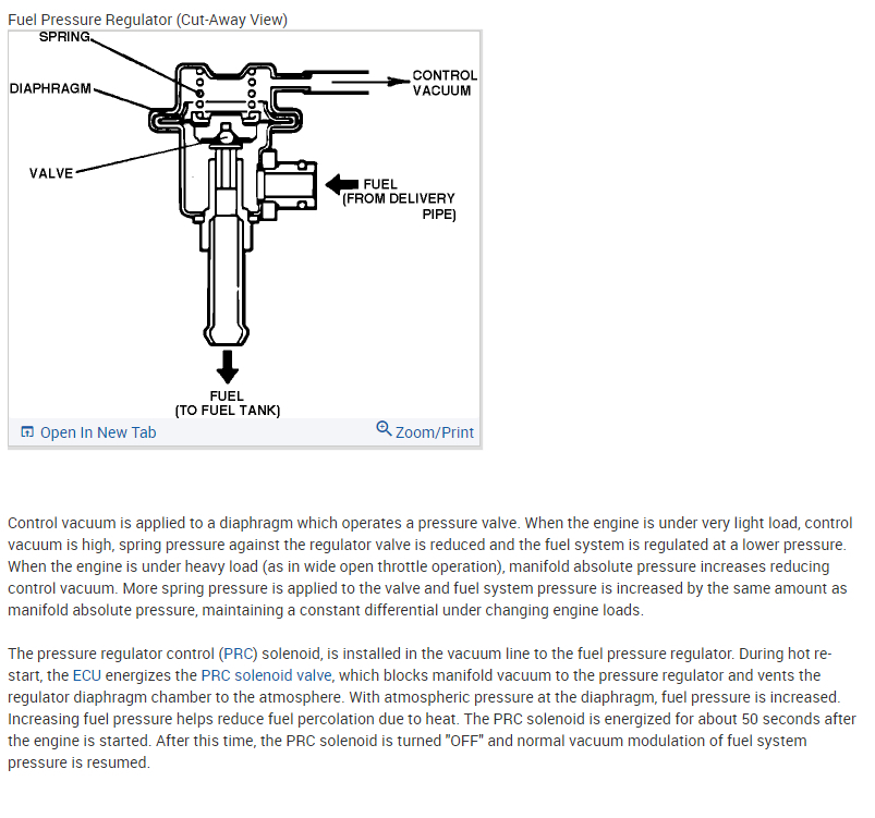

It sounds like you an issue with the fuel pressure regulator.
You might not be getting enough fuel. That's why it will start by then stall of fuel starvation.
Overtime with heat and vibration the internals of the regulator can collapse and not let enough fuel thru.

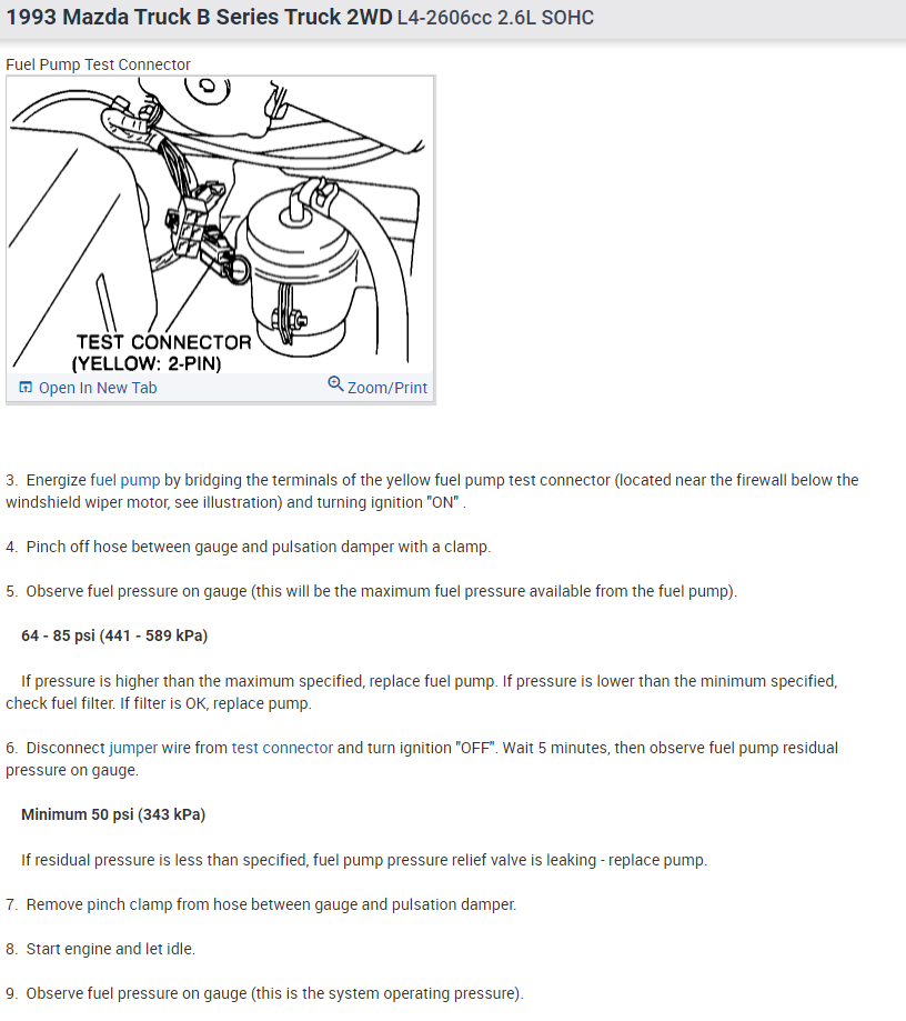

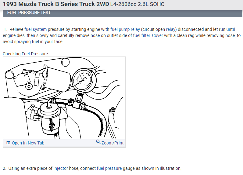

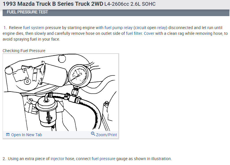

Check the fuel pressure using a fuel pressure test tool.
You should be able to get the tool to use from your local auto parts store.
Attach the tool on the test port (see diagram).

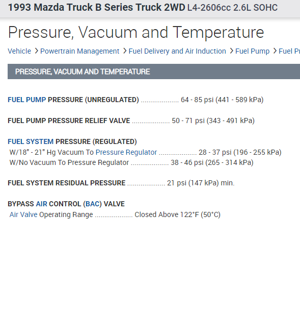

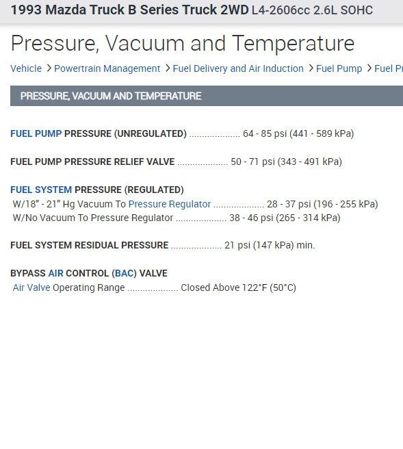

You should have 64-85 PSI of fuel pressure with the key on and engine off:
Here is a helpful video of how to check fuel pressure:
https://youtu.be/aITQclp7zIE
If you do not have adequate pressure you will need to replace the pressure regulator.
