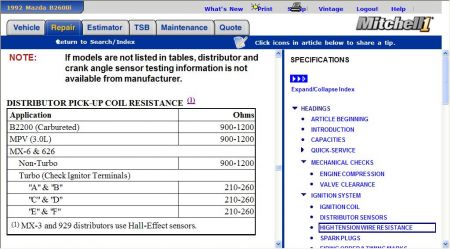

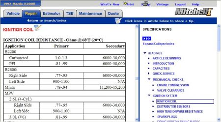

I checked at the plug wires. I've replaced the coil with the one from my B2200 and put the one from the B2600 in my B2200 and the 2200 started no problem. I haven't checked power TO the coil.
I also changed the ignition control module (changed it with the one from the B2200) and it didn't seem to be the problem.
I'm a HD mechanic so I'm fine digging as deep as needed, but I'm not used to diagnosing spark ignition unfortunatley.
I'll check the + wire to the coil and check the distributors continuity. Any idea of what my resistance should be between any of the pins?
Sunday, January 20th, 2008 AT 1:00 PM
  • 75,992 POSTS
See below
https://www.2carpros.com/forum/automotive_pictures/12900_coil1_1.jpg
https://www.2carpros.com/forum/automotive_pictures/12900_coil2_1.jpg
Good Luck
