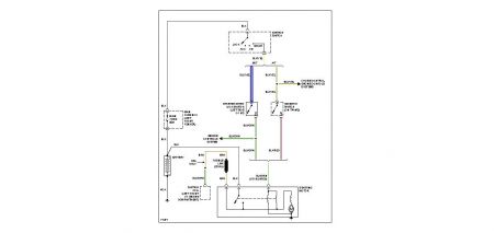

When I try to start it, all the power comes on but the starter don't turn over. I've checked thye neutral switch, but still no starter. Is there an in-line fuse to the starter? Or what else might it be? It started just fine yesterday. I did hit a snow bank, yat all the wires are connected.

Find the clutch interlock switch left side of I/P disconnect it check it for power , has power jumper it and see what happens. Don't work test out the igniton switch start circuit.
Or do this hold key at start position and bang on the starter if it kicks over replace the starter.
