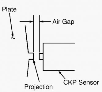

I have the same problem with my Mazda 2001 protege, I am not sure what else to do. This has been going on for about a few years now since I changed the timing belt, which did not really need changing. The same week the check engine light came up, and I took it back to the mechanic that mentioned I should change the plugs, the O2 sensors coils and all. Later changed the catalytic converter, this is the 5th change. I am really tired of working on the car now and just need some insight into this problem.
The engine still acts as if its trying to stall, and by pushing on the breaks I usually stop the car fro shacking soo much. This usually happens as I a stopping at a light or something.
Please please, if you have any ideas on how to resolve this let me know, and also I tried the higher octane for a few months and did not see any changes.

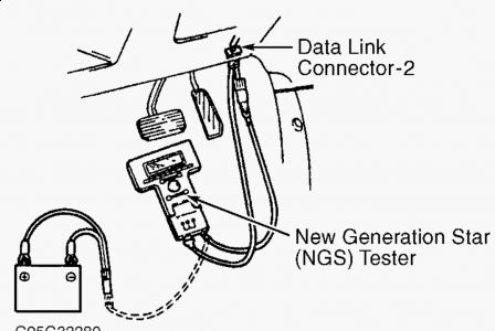

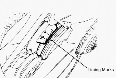

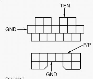

MIATA & PROTEGE 1.6L Loosen CKP sensor bolt. Using feeler gauge, adjust air gap between sensor and crankshaft sensor plate projections to .020-0.59" (0.5-1.5 mm). See Fig. 10 . Tighten CKP sensor bolt. If clearance is still not within specification, replace CKP sensor or sensor plate behind crankshaft pulley. Fig. 10: Identifying Crankshaft Position Sensor Air Gap Courtesy of MAZDA MOTORS CORP. IGNITION TIMING B2300, B2500, B3000, B4000 & TRIBUTE Engine is equipped with an electronic distributorless ignition system. Base (initial) timing is preset and is not adjustable. Inspection of timing is done through World Diagnostic System (WDS) scan tool or equivalent. Information is not available for this procedure from manufacturer. MIATA, MILLENIA, MPV & PROTEGE 1. Connect NGS scan tool to DLC-2 located under left side of instrument panel, right of steering column. See Fig. 12 . Connect a jumper wire between terminals TEN and GND at DLC-1 in engine compartment. See Fig. 13 . 2. Ensure idle speed is correct. See IDLE SPEED under IDLE SPEED & MIXTURE. On all models except Millenia 2.3L, connect timing light to high-tension lead No. 1. On Millenia 2.3L, connect Inductive Timing Light (49-T018-002) lead to ignition timing checking harness (Black/White wire) located next to engine compartment relay box. See Fig. 11 . Start engine and allow it to idle. Check timing. See IGNITION TIMING SPECIFICATIONS table. See Fig. 14 . Fig. 11: Identifying Ignition Timing Checking Harness
NOTE: Before adjusting or inspecting ignition timing, warm engine to normal operating temperature. Turn off all accessories. Place transmission in Neutral (M/T) or Park (A/T). Wait for cooling fan to stop. Ensure idle speed is correct. See IDLE SPEED under IDLE SPEED & MIXTURE. NOTE: New Generation Star (NGS) scan tool is used to perform following procedures. NOTE: On Millenia 2.3L, ignition timing is not adjustable. NOTE: Standard inductive timing light may not work on ignition timing checking harness. Recommend using manufacturers Inductive Timing Light (49-T018-002) or equivalent. 3. On all models except Millenia 2.5L, if ignition timing is not within specification, check CMP sensor, CKP sensor, TP sensor, ECT sensor and transmission range switch. See appropriate SYSTEM & COMPONENT TESTING article. If all sensors and switches are okay, replace PCM. 4. On Millenia 2.5L, if ignition timing is not within specification, loosen distributor lock bolt. Rotate distributor until timing marks align. Tighten lock bolt. Recheck timing. 626 1. Connect NGS scan tool to DLC-2 located under left side of instrument panel, left of steering column. See Fig. 12 . Ensure idle speed is correct. See IDLE SPEED & MIXTURE . 2. Connect timing light to high-tension lead No. 1 and check timing. See Fig. 14 . See IGNITION TIMING SPECIFICATIONS table. If ignition timing is not within specification, check CMP sensor, CKP sensor, TP sensor, ECT sensor, neutral switch, clutch switch and transmission range switch. See SYSTEM & COMPONENT TESTING - MIATA, MILLENIA, MPV, PROTEGE & 626 article. If all sensors and switches are okay, replace PCM.

I had the exact same problem. No power, rough idle, blinking CEL. I changed the timing belt, tensioner and idler, pluggs, wires, and o2 sensors before I found this site and the info on the crank position sensor. I cleaned mine and started my car and it ran great. I'll replace it now that I know it's been causing my problems. I almost put a used engine in or a new head. Glad I did some research!
