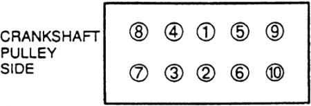

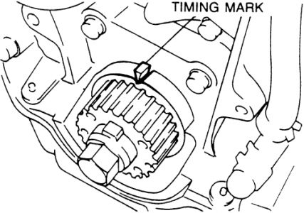

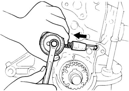

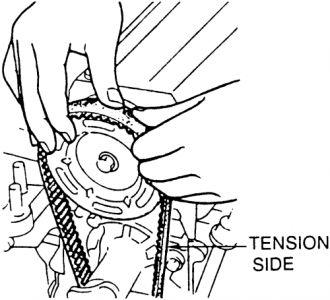

Here is the removal and install for your engine the figures at bottom are the timing diagrams to set the timing
REMOVAL & INSTALLATION
See Figure 1
CAUTION
When draining the coolant, keep in mind that cats and dogs are attracted by the ethylene glycol antifreeze, and are quite likely to drink any that is left in an uncovered container or in puddles on the ground. This will prove fatal in sufficient quantity. Always drain the coolant into a sealable container. Coolant should be reused unless it is contaminated or several years old.
http://www.2carpros.com/forum/automotive_pictures/52960_0900c15280039788_1.jpg
Fig. 1: Cylinder head bolt tightening sequence for all 4-cylinder engines

Remove the timing belt cover(s). Rotate the crankshaft, in the normal direction of rotation, until the No. 1 cylinder piston is at TDC on the compression stroke. Make sure the timing marks on the crankshaft and camshaft sprocket(s) are properly aligned and mark the direction of rotation of the belt.
Loosen the timing belt tensioner and remove the belt. Do not rotate the crankshaft until the timing belt is reinstalled.
When everything is disconnected, loosen the cylinder head bolts in the reverse of the tightening sequence. Remove the bolts and lift the head off the engine.
To install:
Thoroughly, clean the cylinder head and the block contact surfaces. Examine the head gasket and check the cylinder head for cracks. Check the cylinder head for warpage using a feeler gauge and straightedge. The maximum allowable distortion is 0.004 in. (0.10mm) on 1.8L engine.
Clean the cylinder head bolts and the threads in the block. Make sure the bolts turn freely in the block.
Install a new head gasket on the engine block. Make sure the camshaft sprocket timing marks are still aligned, as set during the removal procedure. Install the cylinder head.
Lubricate the bolt threads and seat surfaces with clean engine oil and install them. Torque the bolts in 2-3 steps to 56-60 ft. lbs. (75-81 Nm) in the proper sequence.
Make sure the crankshaft and camshaft sprocket timing marks are aligned, install the timing belt and set the tension. Carefully rotate the crankshaft 2 turns to make sure the timing marks still line up.
