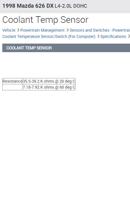

This no start could be due to coolant temperature sensor malfunctioning.
The overheating could have malfunctioned the sensor. When a temperature sensor malfunctions, it sends incorrect data to the ECM, it could send a signal that the engine is 'too hot' and the ECM will not let the engine to start.

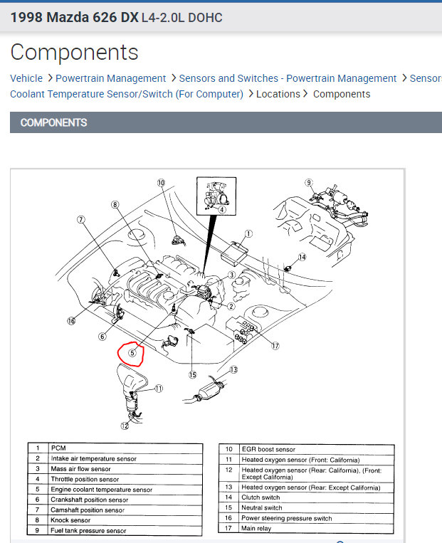

The coolant temperature sensor is located on the top of the engine (see diagram below).

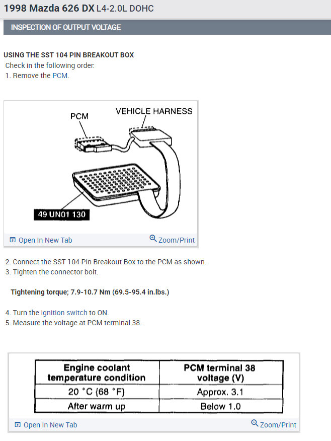

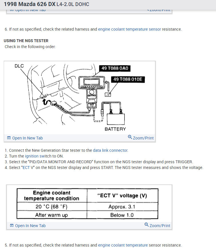

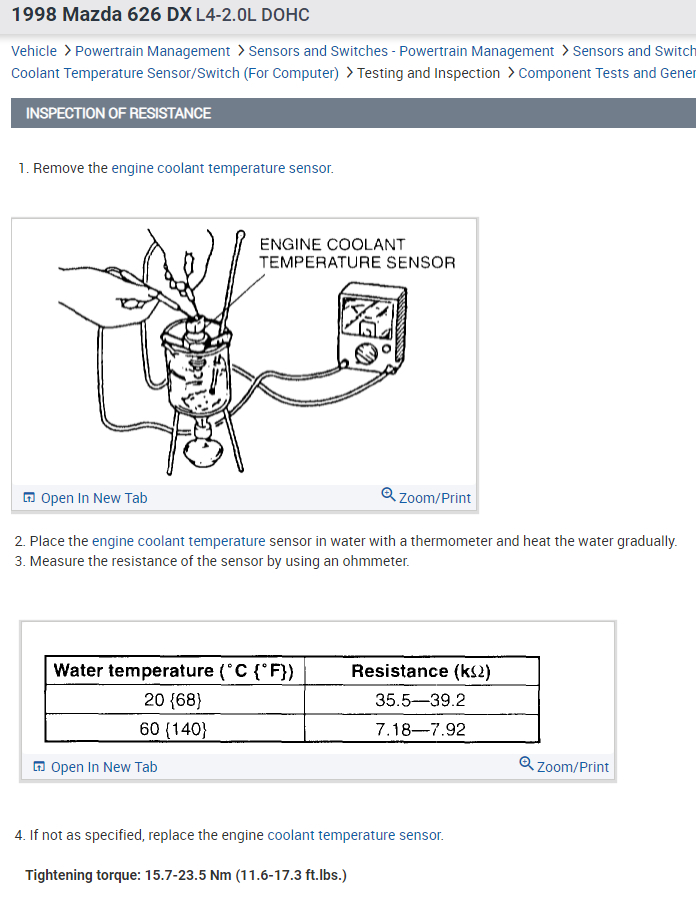

Check the resistance value of the temperature sensor. I included the testing procedure and the resistance value below.
