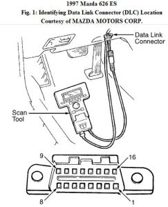

I started having a problem with this several weeks ago. I have to turn on the parking or the headlights to activate the ignition other wise it wont start. I installed a new battery and checked to see if it was the nuetral safrty switch, also where would the hookup for the computer check is on this model, thanks norm.

Here is a location diagram.
https://www.2carpros.com/forum/automotive_pictures/192750_DLC97Mazda626Fig01_1.jpg
I need some clarification on the problem.
If the parking lights are not turned on, what happens when ignition switch is turned ON?
Does the dash lights shows ?
Are you able to crank the engine?
