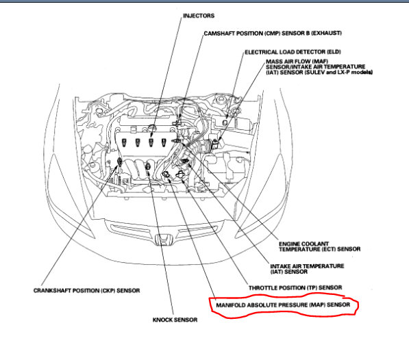

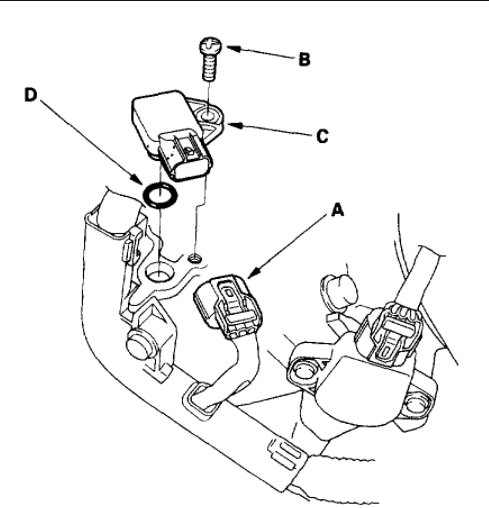

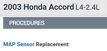

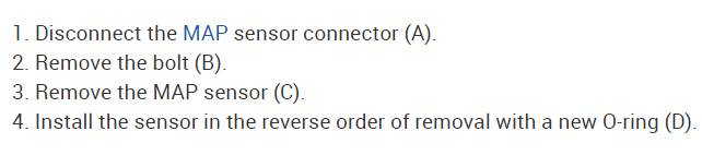

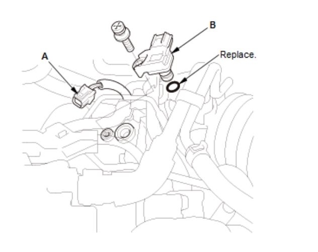

Hey guys, need help locating the MAP on my car. I can't seem to find it, could it be before the air filter?
Thanks in advance!

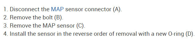

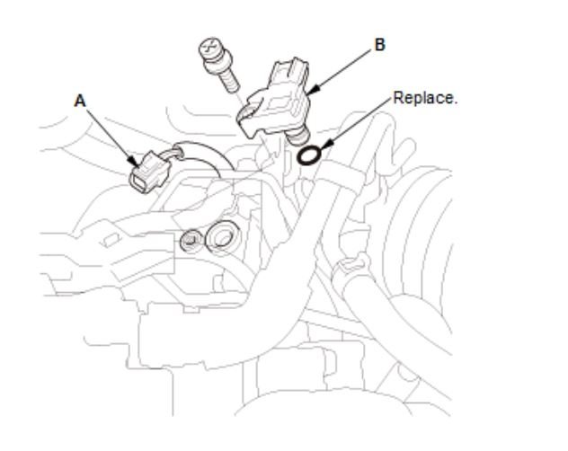

Hello, I'm Danny.
I've attached pictures below on how to replace the MAP sensor and included its location. Hope this helps and thanks for using 2CarPros.
Wednesday, December 30th, 2020 AT 12:09 PM (Merged)

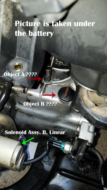

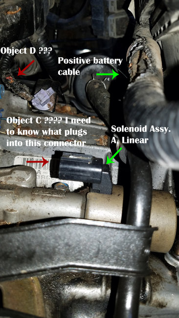

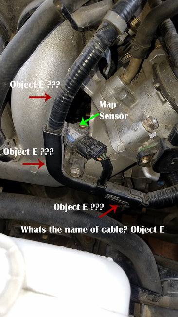

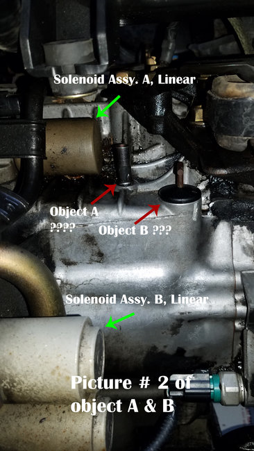

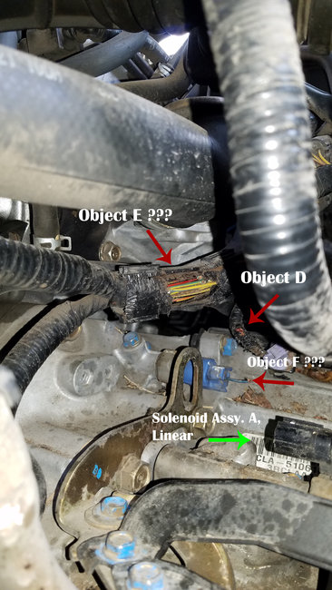

I'm having problems finding out the name of the harness that connects to the MAP sensor. I need to replace the whole harness because I had a rodent built a nest in my engine bay and made a snack out of a lot of wires/harness. : '( I don't have the money to pay a professional mechanic to fix the problems, so I plan on fixing all the wires that where damaged myself! I have pictures! If you can tell me the names of the objects It would help me greatly.
I have red arrows pointing to the objects (A-F) I need to replace. Anything would help and any information that's necessary of the objects.

Hello and welcome to 2CarPros. Aren't critters fun. With the damage you have found you would probably be better off getting the entire front engine harness assembly from a salvage yard. You could cut and splice all the damage but that is a lot of work that could be avoided by just replacing the entire harness. Plus there is likely other damage you have not discovered yet as there are harnesses that run underneath the intake and more.

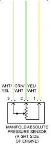

my car is running really richand im having and idle surge idle will be jumping up and down, was told from map sensor since its not connected. Picked up the plug for it from a junk yard and im trying to rewire it but cant seem to find the wire for it so im trying to make my own wiress since the engine harness costs 700 can u please help me and tell me which and what goes where thank you

Hi src,
Is the Check Engine Light showing and what is the trouble code?
The MAP sensor and TPS sensor wires are near each other, check the harness where they meet the main engine harness.
Here are the wire color codes.
https://www.2carpros.com/forum/automotive_pictures/192750_MAPSensorWire97Accord_1.jpg

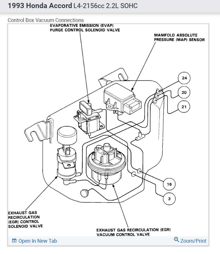

The book says map sensor someone over the phone told me it was a mass air flow sensor and im not sure. My car does the hick a buck and jerks when I give it gas like its not getting any gas. Just replaced fuel pump and filter but the problem is still there. Am I on the right track to fix it?
Wednesday, December 30th, 2020 AT 12:10 PM (Merged)
  • 75,992 POSTS
Check the MAP and throttle position sensor-might be wise to check also the fuel pressure with a gauge here is the MAP sensor location. Check out the diagrams (Below). Please let us know if you need anything else to get the problem fixed.

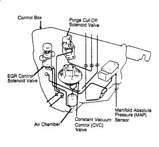

ROBYNWILLETTE
  • 1990 HONDA ACCORD
1990 Honda Accord 4 cyl Two Wheel Drive Manual
I need to replace my map sensor and I don't know where to find it's location

BLUELIGHTNIN6
  • 16,542 POSTS
MAP sensor is located in conrtol box at right rear corner of engine compartment, pictured below..
