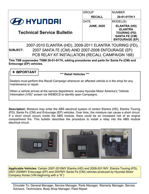

your car has 4 wheel abs with EBD it stands for electronic brake force distribution also if its the se model it also has brake assist and electronic stability control ...I think the problem may be in the ebd unit its basically like a electronic brake distribution block of a sorts it works with all 4 wheels might be sticking ..I'd have it checked soon it might need re calibration watch for the abs light on the dash or a check engine light it might have brake fault codes...good luck

I believe there was a recall on the electronic braking system in 2020 for the Elantra it talked about moisture problems in the electronic control unit or something maybe call the nearest Hyundai dealer and see if there's a braking recall to see ft yours is covered they'l most likely need your vin number and can probably tell you right over the phone and if it is on the recall list theyl probably fix it for free..until then drive safely best of luck

be sure to check out the recall info down below. I'm not sure if its still active but it think there's a case number and it says Wich cars are included... anyway be well

Thanks for that information. Too bad they didn't spell out any other symptoms that could occur. It seems like too often, "increased risk of fire" is a catch-all to cover themselves of any liability issues.
