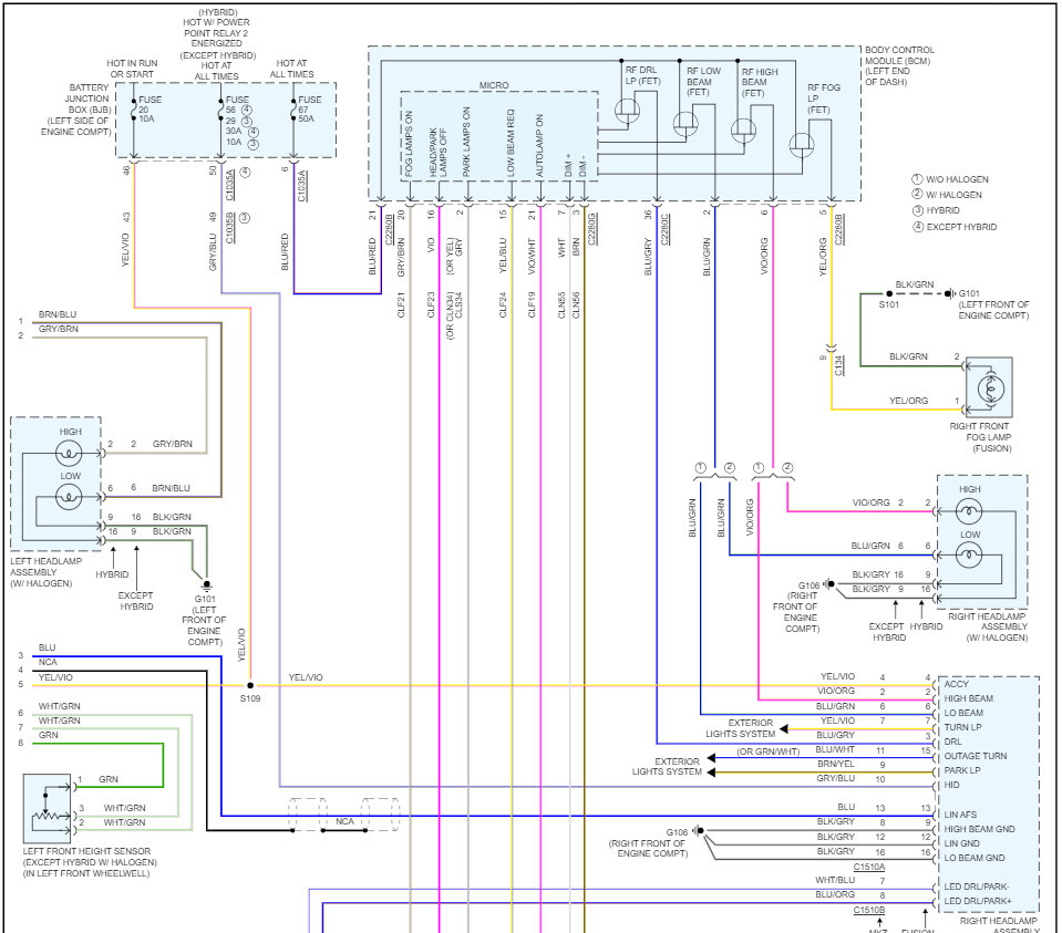

We have the car listed above SE. Just noticed copilot low beam headlight is out. We replaced the whiter and brighter bulb we just installed in September, still nothing.
Replaced overheated socket (when new bulb didn't work, we next thought the socket had overheated by the way it looks, see attached picture), still nothing.
Now totally perplexed!

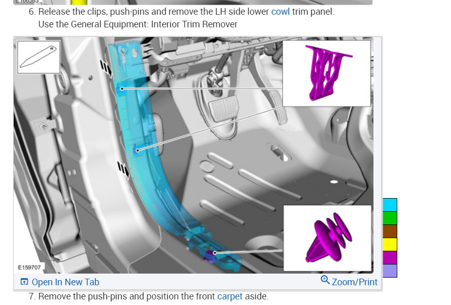

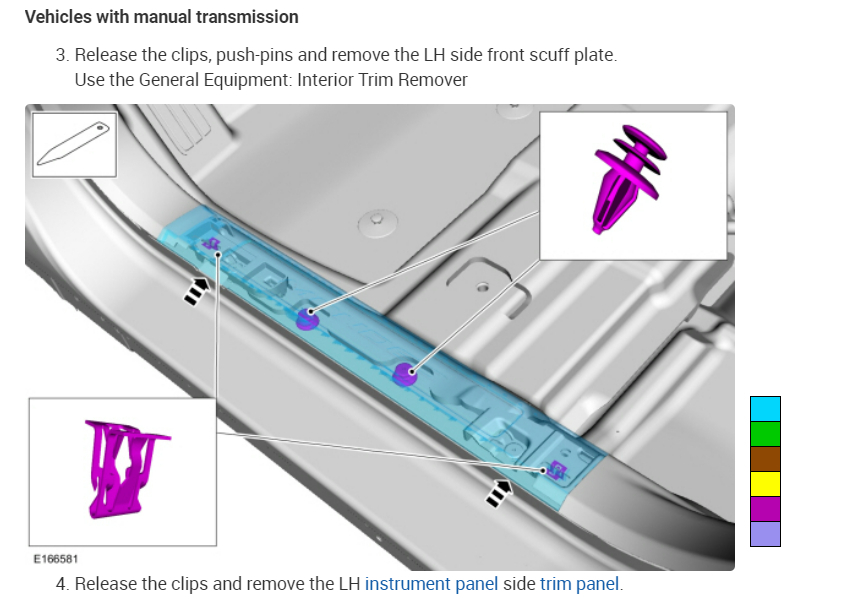

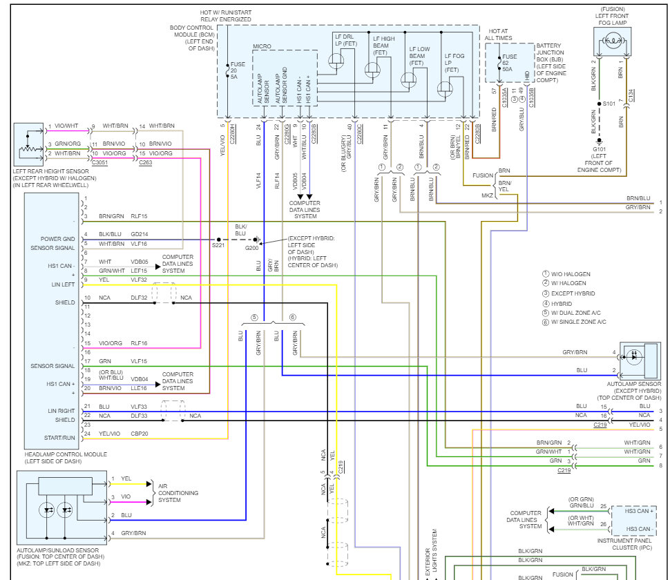

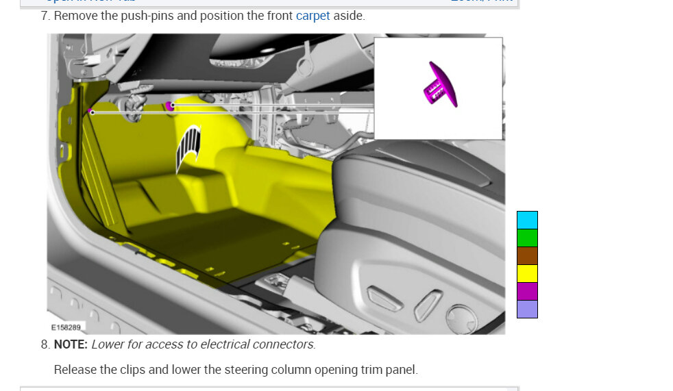

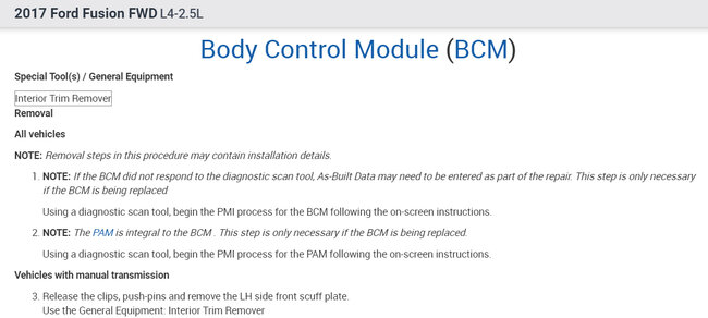

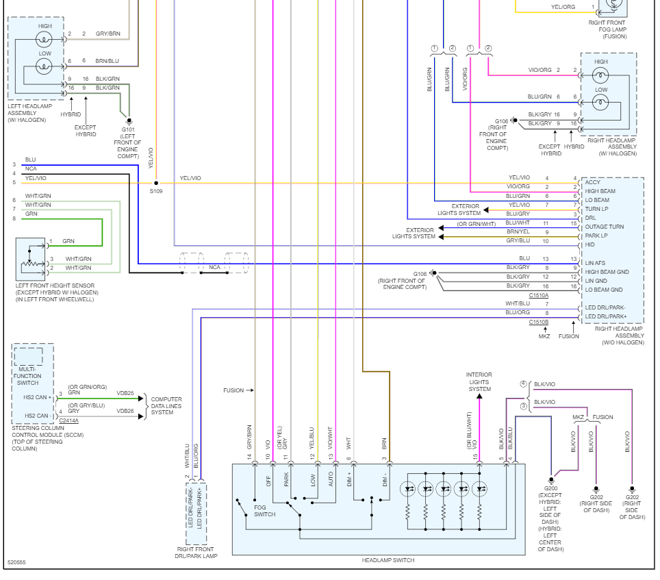

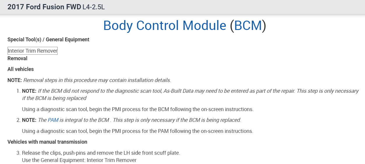

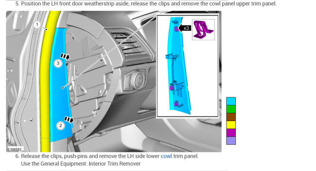

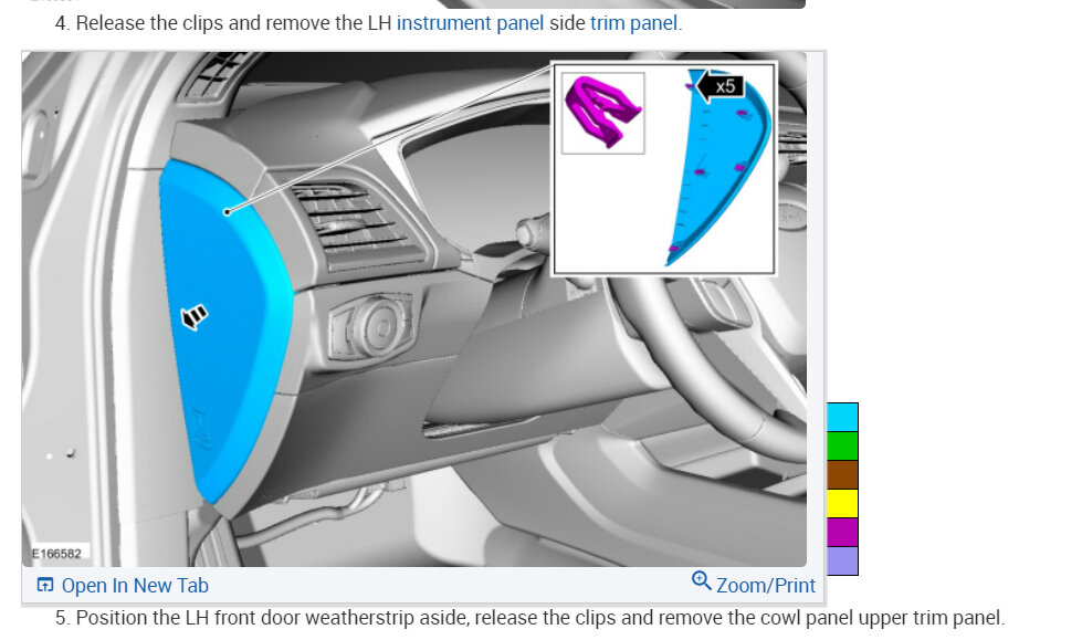

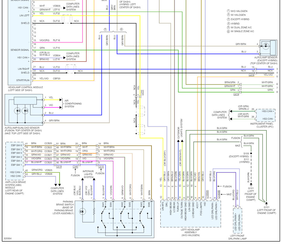

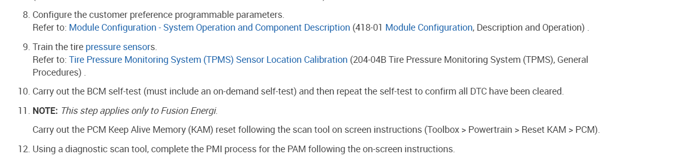

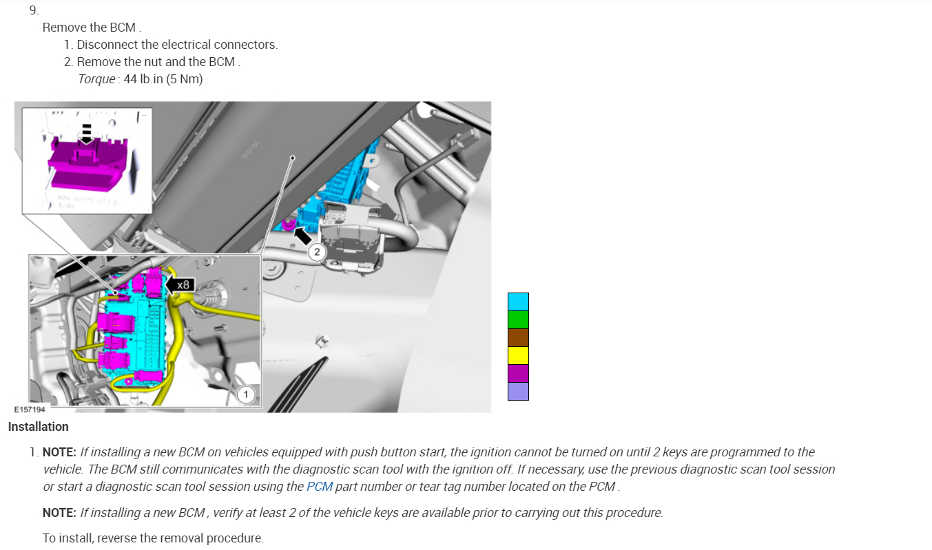

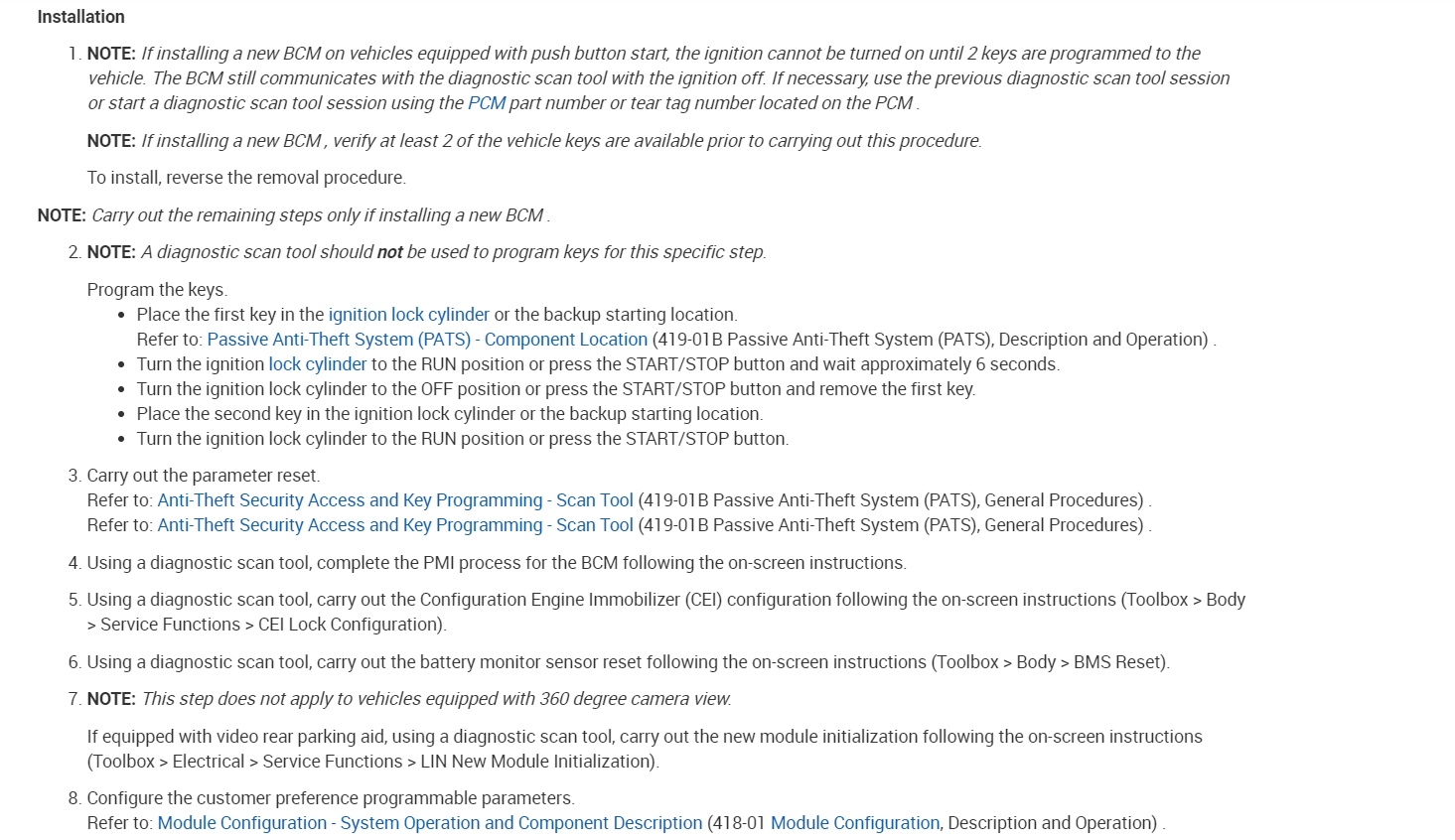

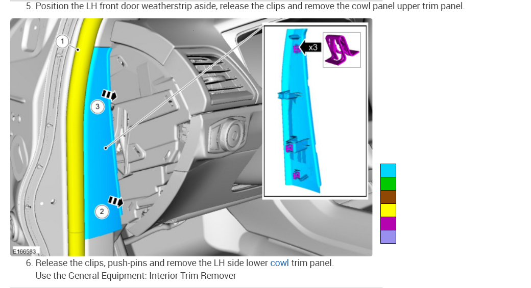

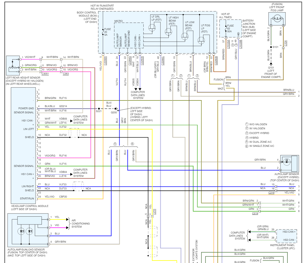

I don't see the picture. With the socket overheated I would say the BCM has gone out, which is what controls the headlights, but you should check all fuses first with the systems on.
We can confirm the BCM failure by doing a CAN scan. You can get a CAN scanner (Controller Area Network) which will work on most cars from Amazon.
https://youtu.be/u-4syLc-ifQ
and

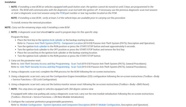

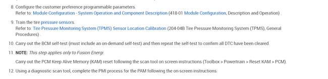

Here is he wiring diagrams for the headlights which show you how the headlights work and i have included how to change out the BCM in case you need it. You can get a preprogrammed unit by searching Google or Ebay. Check out the images (below). Please let us know what happens.
