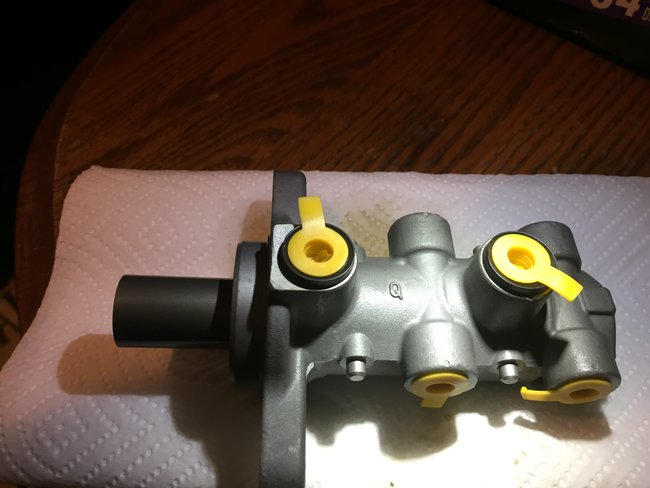

Well, the fun continues.
Installed the HCU but no improvement.
Went to install the new master only to find the reservoir would not fit.

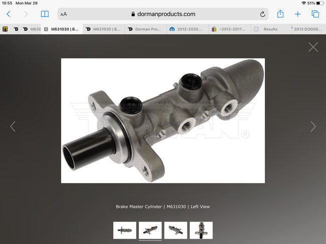

Okay, checking Dorman’s site and finding a photo of my unit but fitment is for a 2014 Journey.
They do cross reference to OEM.
Dodge site shows and lists a different number.
When I searched the Dodge site for the Dorman number it brings up a match to my unit and lists it for my 2013 but no pic.
So at least I have a line on the the proper master.
