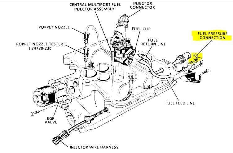

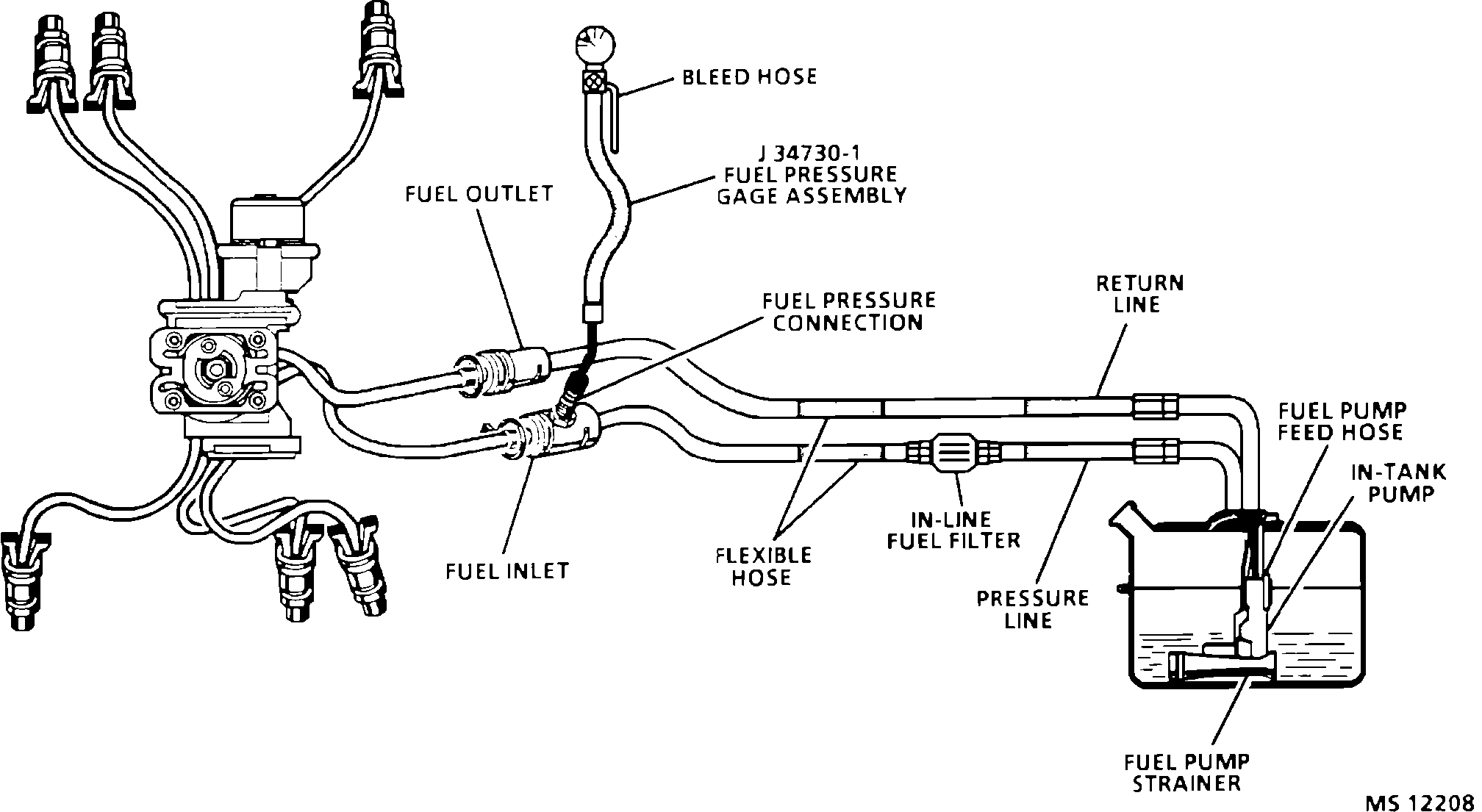

On starting, I click key real quick and then next click it turns over? Then once on the road, anything over 45 mph vehicle surges and backfires very loudly out the tailpipe!?

Here are the directions specific to your vehicle for testing fuel pressure. In the first pic below, I highlighted the place where the fuel pressure gauge will attach. I realize most people don't own one, but most parts stores will lend you one. Also, the manufacturer's specs for pressure are listed in the directions.

1994 Oldsmobile Truck Bravada V6-262 4.3L VIN W CPI
Fuel System Pressure Test

pic 1
Fuel Supply System CMFI
Pic 2
