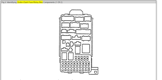

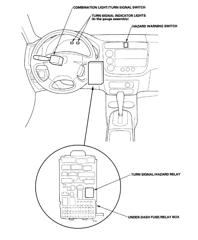

There are 2 relays in the circuit. You mentioned swapping, was both swapped or only the hazard flasher? In the underdash fusebox there is another side marker flasher relay.
Sunday, June 16th, 2013 AT 12:36 AM
BEASLEY2013
Swapped turn signal relay, not the other relay!
Tuesday, June 18th, 2013 AT 2:59 AM
KHLOW2008
  • EXPERT
Check out the side marker relay. Seems that is the only component that can cause the symptoms described.
