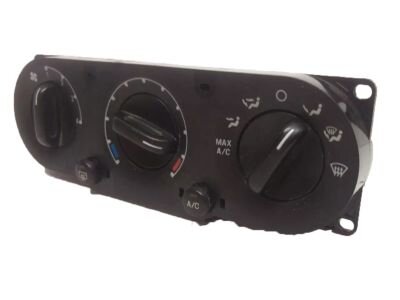

Air is coming out of wrong vents. When i put the control lever to floor vents, air comes out of the front vents then when i switch to front vents, air comes out of the defrost vents. I tried resetting by pulling the climate control fuses, but it doesn't seem to help. I want to change the mode door actuator to see if that helps, but I can't find it. Where is it located? My 2010 Explorer has manual controls and an auxillary a/c and separate manual controls for the rear (which works as it should). Ocassionally when I do a reset, the air comes out of all the correct vents, but only for one cycle through the vent control settings. When I go from floor only back to front vents, the air goes to defrost vents and then when I put it in the floor only position it, it comes out of the front and it stays that way (front=defrost vents, floor=front vents).

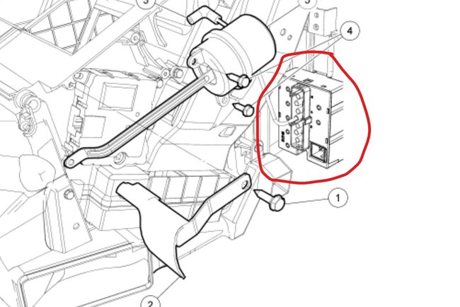

You won't find a mode actuator like you are looking for, your truck uses vacuum actuators to move those parts. From your description of it working once when you reset the controls it isn't one of the actuators that is the problem, it is either the control head or the vacuum control solenoid block that selects which ports are active based on the position of the control switch. These are only on-off valves and you say that a reset sometimes returns function, that would point me to the control head in the dash as the problem. It is the only electronic part that a reset can effect. If it were a different failure you could replace the individual switches but as yours works after a reset it isn't the switch that is bad but something in the electronics of the control panel itself. Replacement of that part ( 7L2Z19980AA ) however isn't going to be easy as it has been discontinued for a while You might get lucky and find one on a shelf somewhere or opt for a used one.
Replacement isn't that hard, the central trim panel comes off and the module has a few screws that hold it in place. You remove them and swap in the replacement. Then connect the scan tool to tell the module what vehicle it is in. Attached are images of the control solenoid location as well as one of the vacuum door motors, the other is where I believe the problem is, the control head itself.

Thanks very much for your explanation. I did find a used control module on EBay from a 2010 Explorer and installed it but the issue stayed the same. What would you recommend checking or replacing next?

I changed the control module with the knobs:

Strange as that part has the controller in it. You said that it would work correctly now and then with a reset. About the only other item would be the control solenoid box, it would be rare for that fault but if it was worn in an odd way it could lock up and block the vacuum. The easiest way to test that would be to use a hand held vacuum pump and apply the vacuum to the hoses and see if the vents change, if they do the solenoid box is bad. (it's called a solenoid box but it's actually valving inside it)
