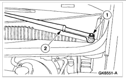

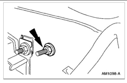

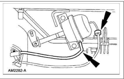

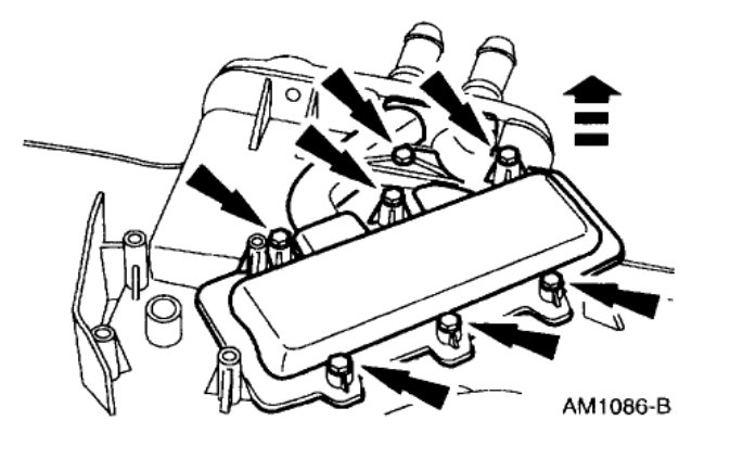

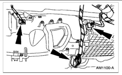

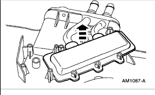

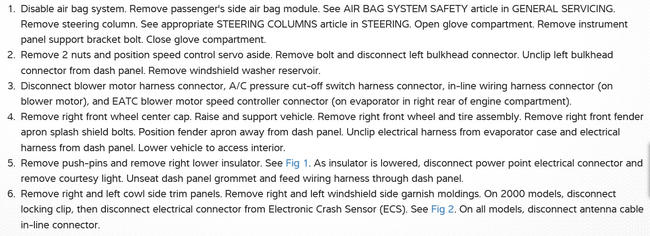

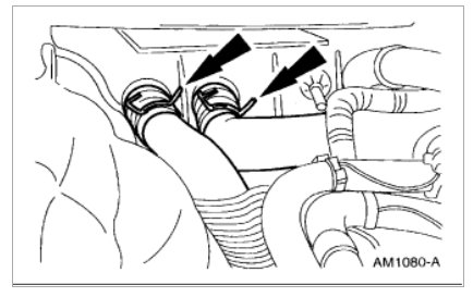

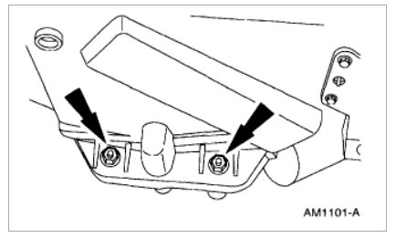

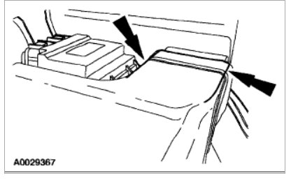

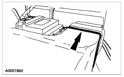

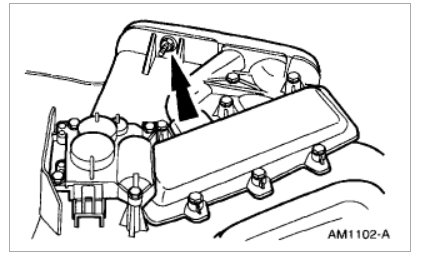

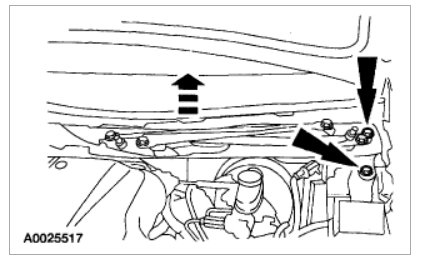

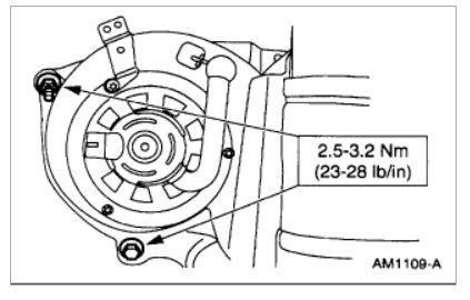

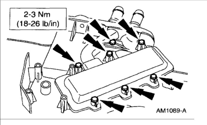

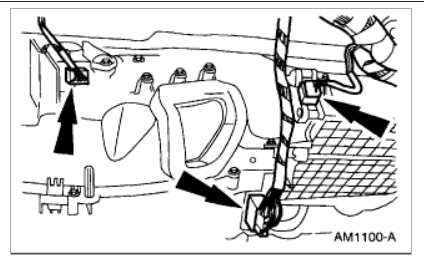

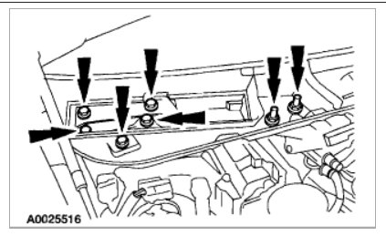

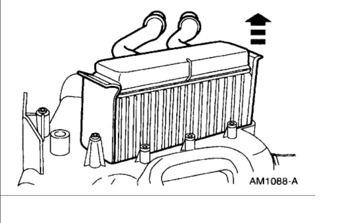

This jog is not to bad, it will take a little time but well worth the money you will save doing the job. Here is a guide that will give you an idea of what you are in for doing the job.
https://www.2carpros.com/articles/replace-heater-core
You might what to replace the heater core hoses as well
https://www.2carpros.com/articles/replace-heater-hoses
Here is what the job will be like for your car (below)

To by pass just get a piece of pipe that fits on hoses and clamp it on both ends with hoses. To replace the heater core the dash has to come out.

The hoses will connect behind the motor.

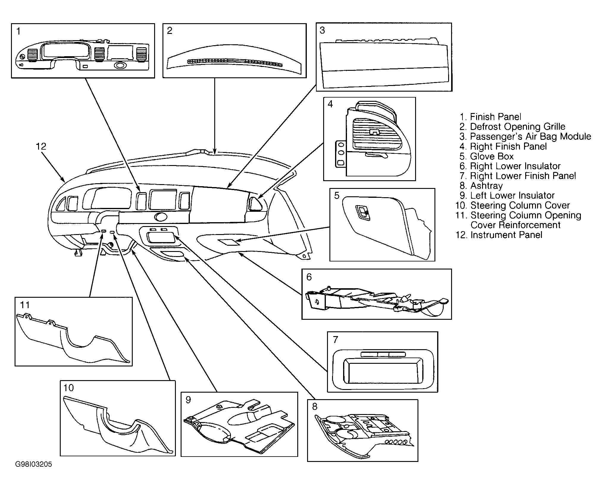

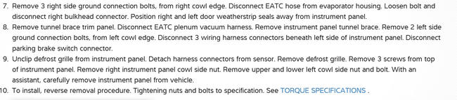

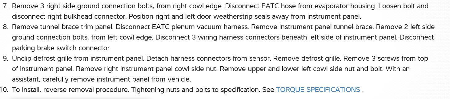

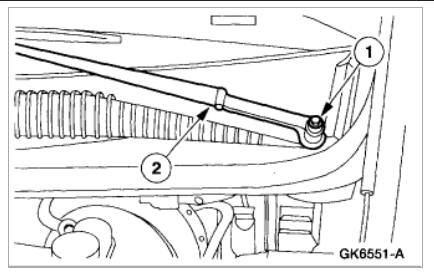

Have everything off, dash is loose except drivers side, does steering have to be dropped completely down, and is there something else I'm not seeing. Thanks
Monday, November 13th, 2017 AT 5:18 PM (Merged)
HMAC300
  • 48,601 POSTS
Yes it has to come out. See pics

POPPYJOHN
I don't see any pictures
-2
HMAC300
  • 48,601 POSTS
They are there unless there is an x in a box. Click on them and try to enlarge them so you can read it easier. I can't do much on this end with that.

This is an 8.2 hour job for a shop to do so it is no easy task. There are way to many things to try to tell you to do that have to be done right so that you don't deploy the air bags and so on. So I either recomend that you go to your local parts store and buy a repair manual like haynes or chilton so you have all the steps as you need to remove the entire dash board to get to it or find a trusted shop and let them do it. I am sorry I can't give much more but like I said it is just so much to try to tell on how to replace it, that it would take hours just to write it out. Once you have a book if you get stuck in area's then get back to me and I will try to walk you through it.

O.K. Major job instrument panel needs to be removed if you attempt get a manual and take your time
