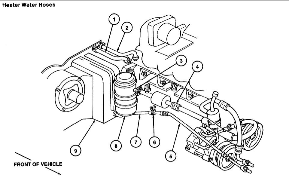

Where is the hose to charge the AC on a 1996 Lincoln Town Car?
Tuesday, August 18th, 2009 AT 12:40 PM
18 Replies
KEN L
  • MASTER CERTIFIED MECHANIC
  • 55,488 POSTS
The low side charge port is on the accumulator #8, here is a couple of guides and a diagrams (below) to help you get the recharge done.

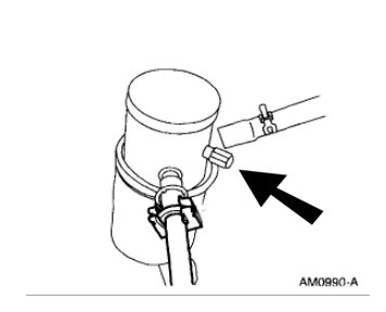

i bough a can of 134 with the hoses but I cant find the low side port to connect the port next to the high voltage fuse box is to big will not fit. Can you tell me were to find the port
Thursday, July 13th, 2017 AT 6:20 PM (Merged)
  • 75,992 POSTS
Hi champion2165, Welcome to 2carpros and TY for the donation
The low pressure service port is located on the accumulator.
The accumulator looks like this: (below)
