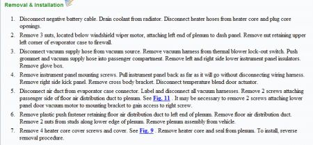

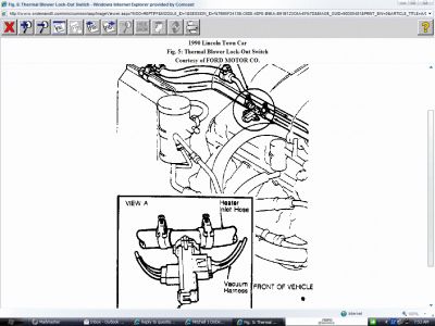

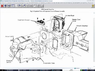

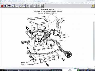

I have had my radeator back-flushed two times, replased the termastat, and put in a new water-pump. The heater only blows out warm air. It blue out hot air before I took it in to be worked on, ( the water looked like mud) I don't have the money to replace the core. Is there anything that I can do my slef. Or can I replace the core myslef. Don't know how though.
