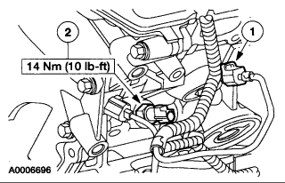

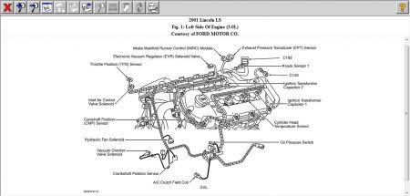

Were is the oil pressure switch located on a 2001 lincoln ls 3.0 v-6
Sunday, June 6th, 2010 AT 7:13 PM
MECHANIC
75,992 POSTS
See below-Good Luck
