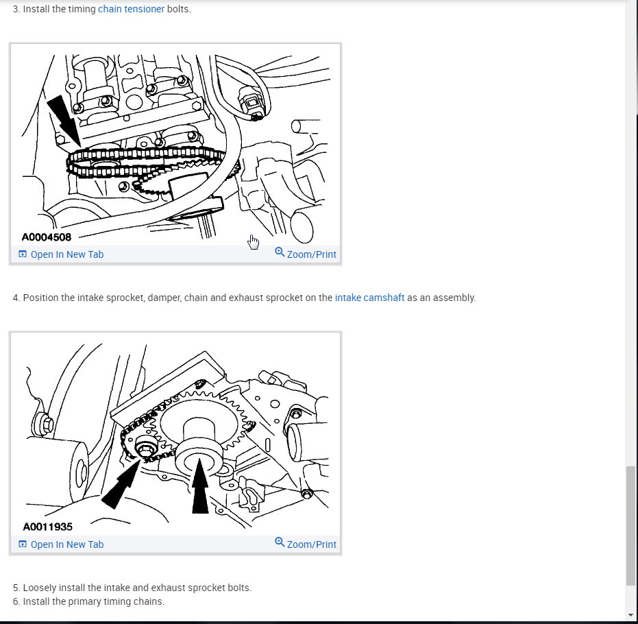

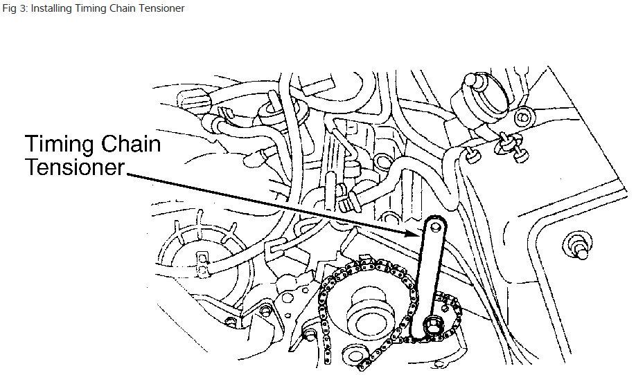

Timing Chain Tensioner 303-532
Timing Chain Tensioner Adjuster
http://www.2carpros.com/forum/automotive_pictures/99387_image_resize_2.jpg
and also you need
OTC 303-645A
Crankshaft Alignment Tool
http://www.2carpros.com/forum/automotive_pictures/99387_Graphic2_1.gif
http://www.2carpros.com/forum/automotive_pictures/99387_Graphic1_498.jpg
