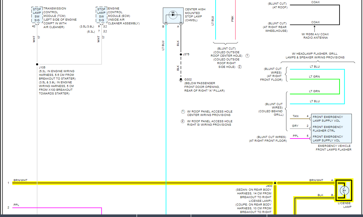

I bought a new wiring receptacle, a new bulb and still not working? Can anybody help
Wednesday, May 5th, 2021 AT 6:11 PM
MECHANIC
52,796 POSTS
Good evening,

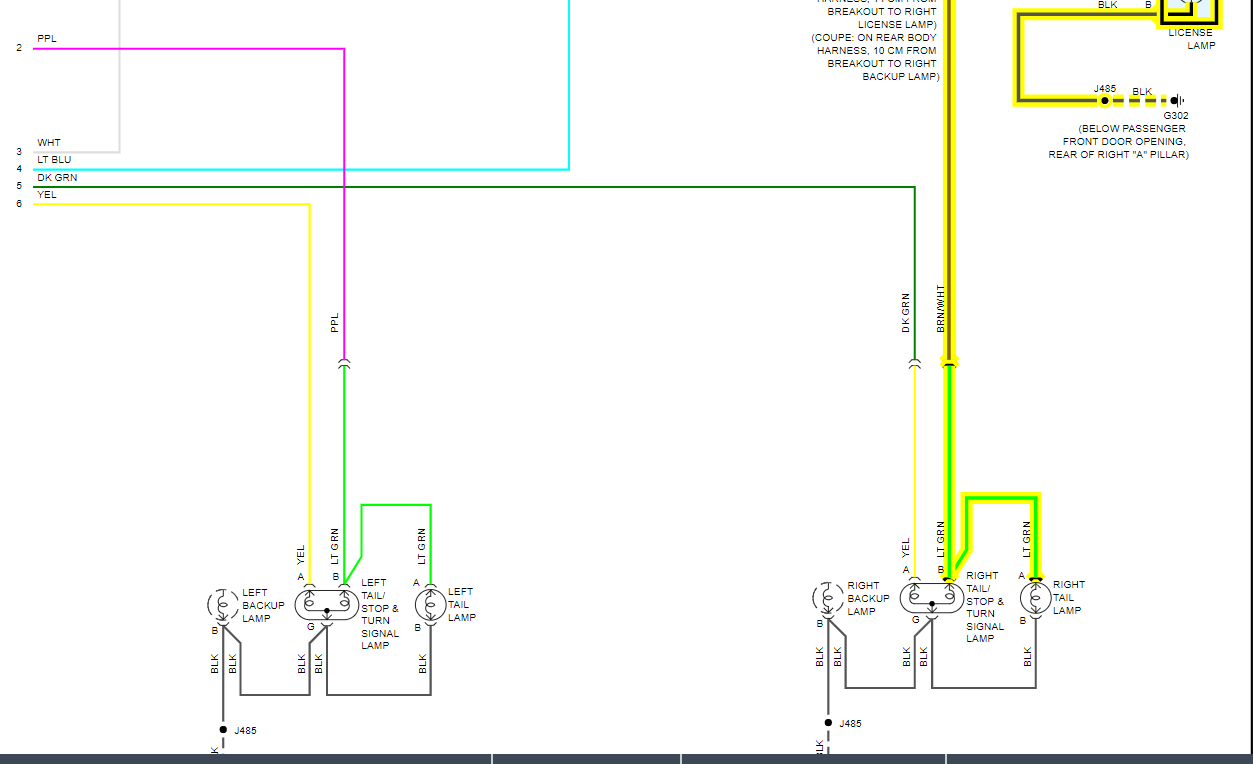

I attached a wiring diagram for you to view.
https://www.2carpros.com/articles/no-tail-lights-exterior-running-lights-tail-lights-out
Check the brown/white wire for power with the headlights on.
